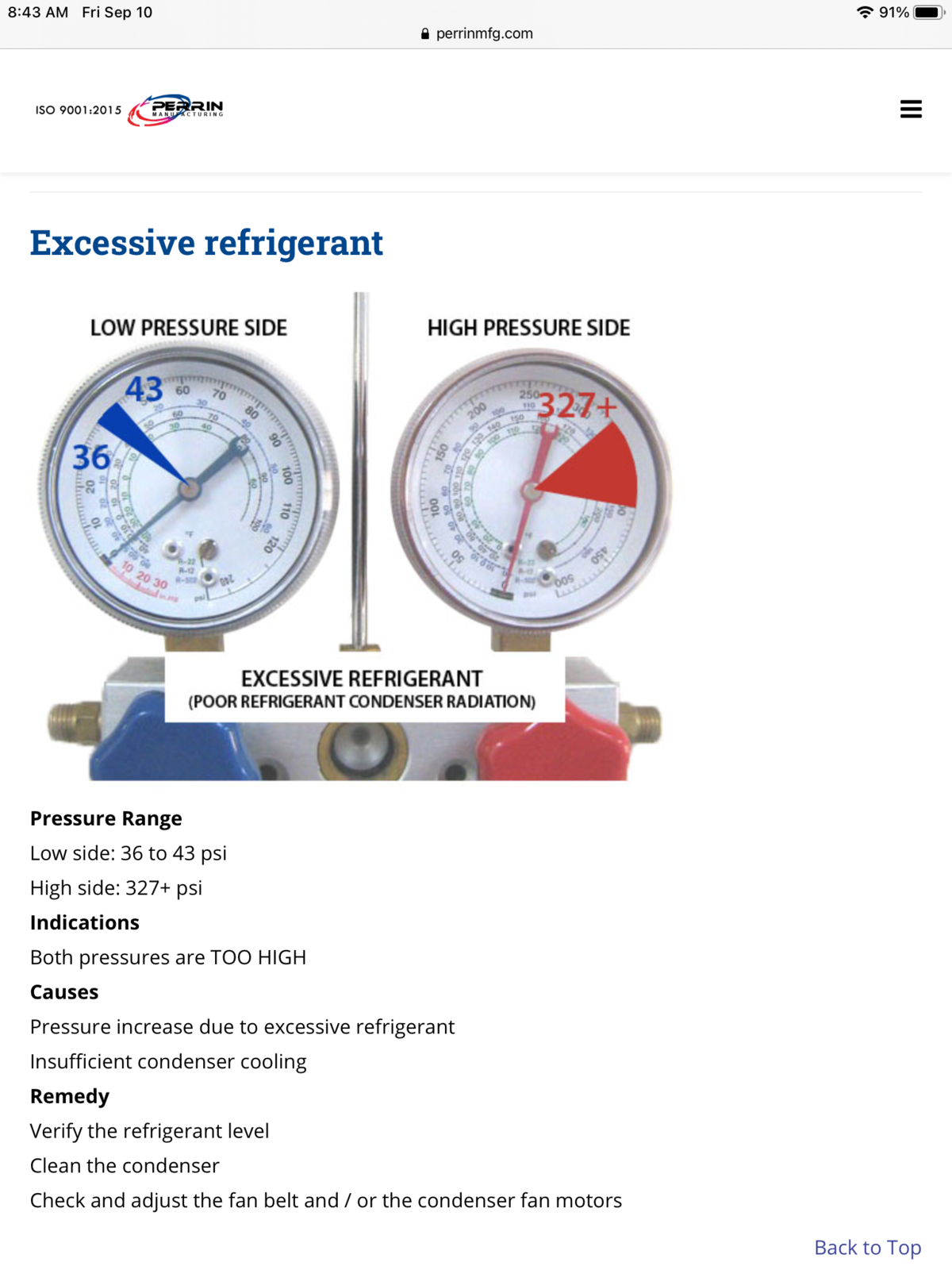

Let some gas out?
if your pressures take off and the temp rises, it can be too much refrigerant.
