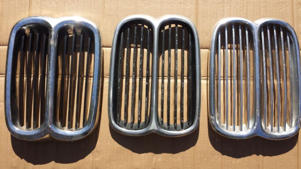

OK, Three Kidneys
Here's a pic of the 3 grills that I have.
If I understand what I've read, all E9s came with all-aluminum grills, the early ones were shiny all over, the later ones had black slats.
so it looks like I have 1 early one, 1 late one & 1 from some other model.
The late one has the inner portion of the outer frame black - is this how it is supposed to be?

so I guess that the one with plastic slats is for an E3

In MY 74 coupes got the fatter grille with four black slats. All earlier coupes had five alu slats and the CSL had five black alu slats. That's my story and I'm sticking with it!
The 5 slat black one appears to have been painted. Only the slats should be black, and CSL's were annodized black not painted I think.
5 black slats were for the CSL cars
and 5 alu slats were for the rest. In late 73/early74 this was changed to 4 slats with a thicker frame, for God knows what reason. These are the ones available today.

I have seen Donnie's 74 coupe, last time around 8 years ago at the HB Concours. It should have four black slats, Alu surround, they were never chrome.
It is an automatic, 434 out of 451, built Dec 1974. No silver grilles were around for Hans to pull from. :)

Grilles for both e3 and e9 are the same. I think if you order 51131801604 which was silver you will get 51131826809 which is black, $353. Peder is an expert on these and I trust his statements.
