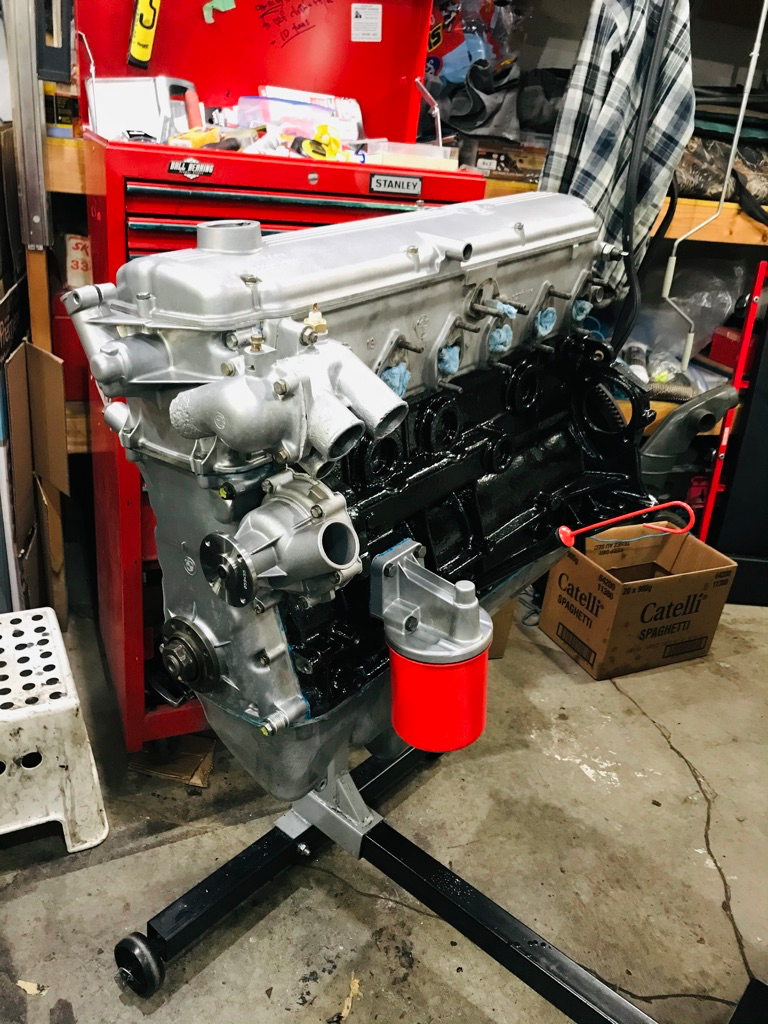

After replacing all seals and gaskets, is there a safe way to test for oil leaks before engine install, full connection, and run up?

Assembled with Hylomar Blue,
I guess you could hook up a starter with a mechanical gauge on it, fill it with oil and spin it over and get some oil pressure and see what happens Make sure the dist is in to stop oil from coming out. BUT, unless it is a major oil leak, small ones don't usually show up for awhile. you might get lucky ( or unlucky )and see something You also have to take into consideration that the engine has to go thru hot and cold cycles to see what may happen

If you've properly installed and Hylomar'd the duck gasket, oil pan gasket, front and rear crank seals, upper and lower timing chain covers (with a dab in the corners per the manual) you should be good to go

All the above, Stevehose! I may have used a bit too much as it squeezed out. I probably use too much toothpaste too. Though there's a lil comfort in seeing the excess squeeze out :rolleyes:

It can be cleaned up with acetone and a rag

I have a vacuum pump I use to test the sealing of my crankcases. Seal up the crankcase with the filter in place, block the distributor hole and the valve cover vent. Draw a vacuum on the crankcase and use a short length of hose to listen for leaks. If you find a leak, usually in the corners of the gasket, just add some sealant and the vacuum will suck it right in .
