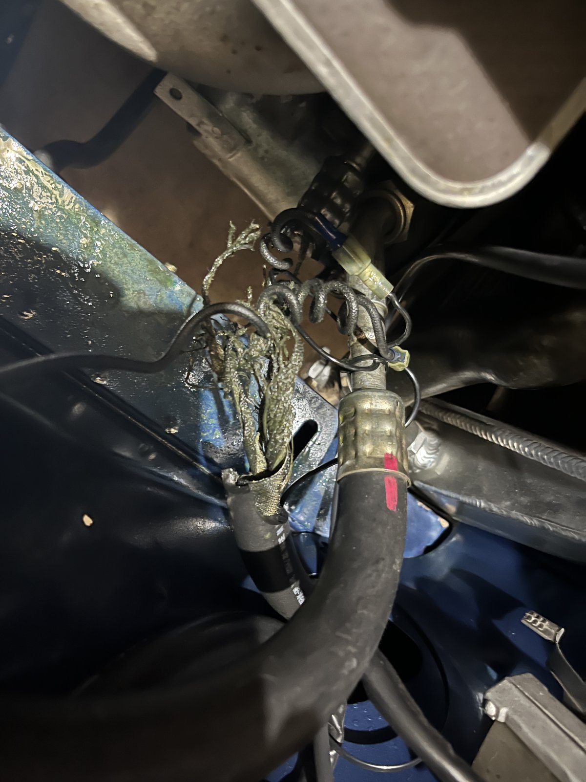

After getting home and sending a few photos attached to my local mechanic (who did my last R134 fill last year) and Don Lawrence, it appears something shorted near the compressor and exploded the high pressure hose connecting the condensor to the compressor, it appears. Clean up this morning was a pain but the car runs fine and now I just need to contemplate what to do next. Maybe give my AC system the win and call it a day or go back to square one and attack the hoses and wiring which go back to Coupe King days in 2010. And the compressor may be toast too...

I agree with Steve; it is unlikely an electrical problem caused your hose to blow. The only electrical in that area is the power to the compressor clutch, and that is on a relay with a flying fuse near the right front headlight. Not much to go wrong, and I don't see any melted wiring in your picture. Its possible that your compressor clutch failed. When the clutch went on my son's e34, the compressor stopped turning and the a/c belt melted. In any event, your hose obviously blew, which could be from some other failure, incorrect pressures from the fill or might be due to the age of the hose.

It kind of looks like the rubber part of the hose stayed in the crimp fitting and the metal mesh structure pulled loose from it -- a sort of delamination. Not sure if that means a defect in the hose or an insufficient crimp or, as you say, too much pressure.

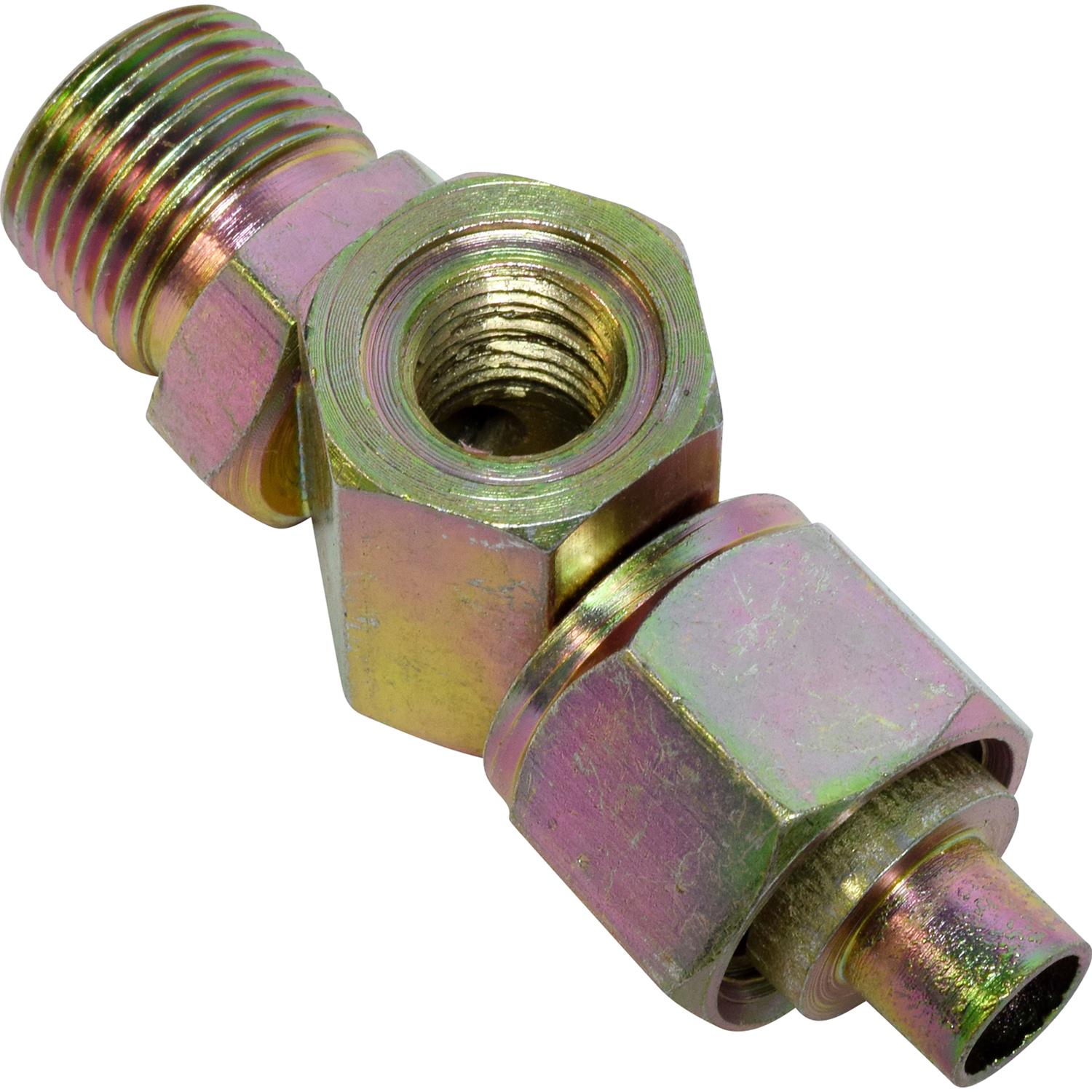

Add this fitting on at one of your high-side-connections:

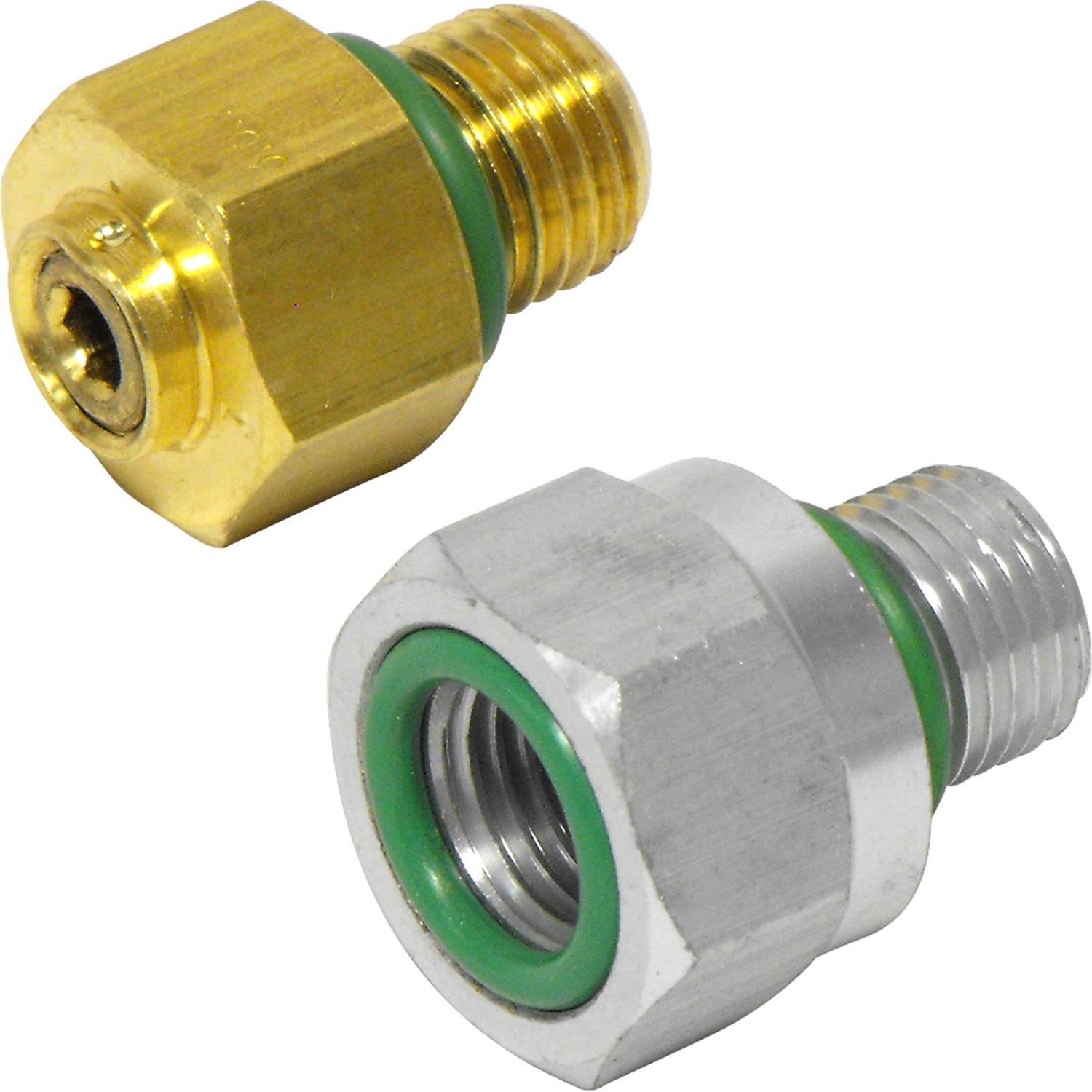

And screw this pressure relief valve into it:
Then, if you ever go to super pressure again you'll see a smaller cloud of refrigerant but there won't be a pop and you won't break anything.
