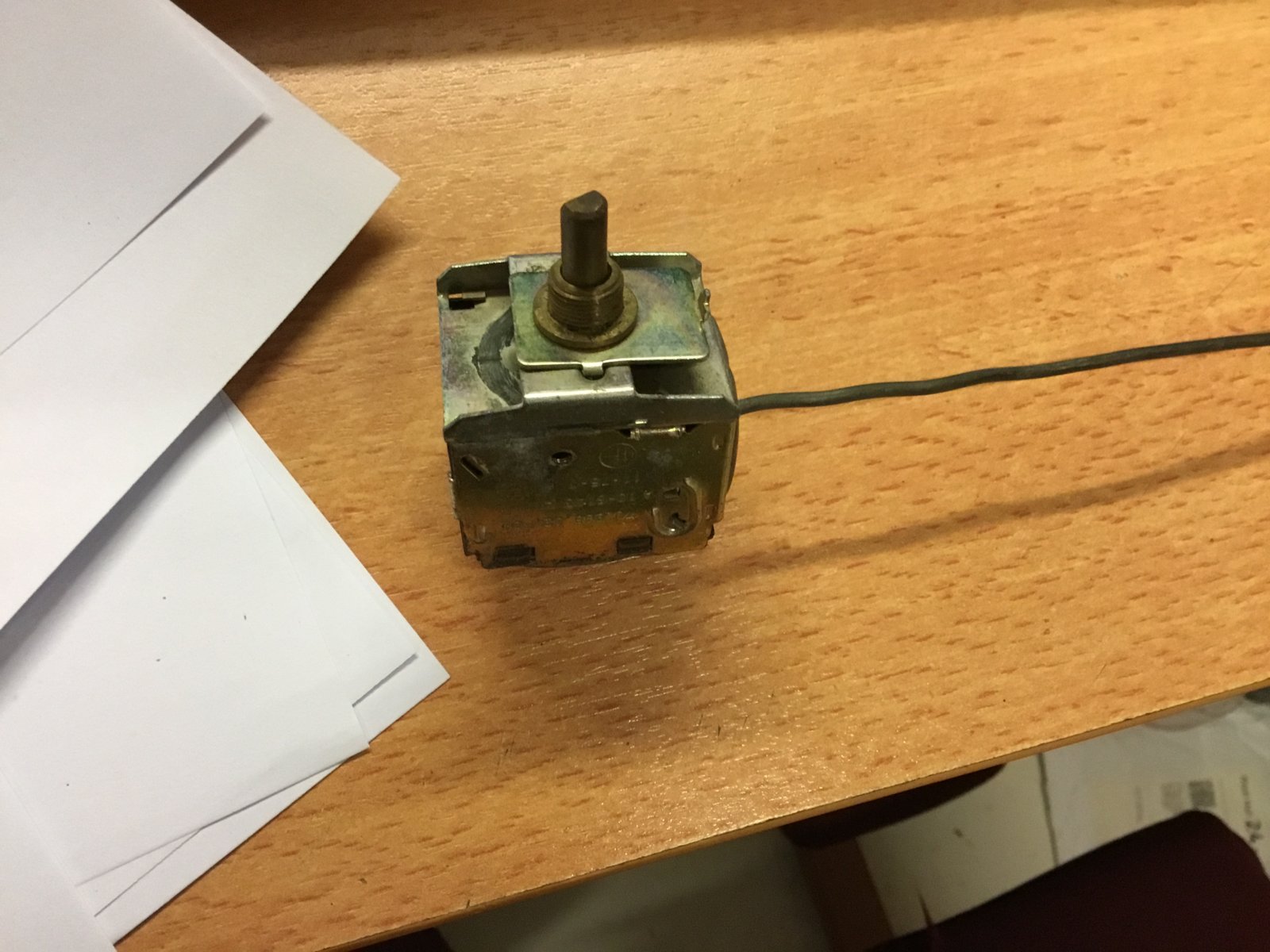

Broke mine when removing the vent faceplate. I know they are NLA so am wondering if anyone has a spare? Will post in the parts thread as well but figured i'd start here.
Replacement has a SAE thread, chrome nuts are not available that I can determine, it's a Very Fine thread too.
Trying to fix a capillary tube is like trying to fix a light bulb... ;-)
The PO had cut the capillary on our E9 thermostat so I have had to find a replacement. The OEM BMW is too large as others have stated.
The one posted above in 2015 doesn't show up on ebay. There may be another post with more info but I haven't found it.

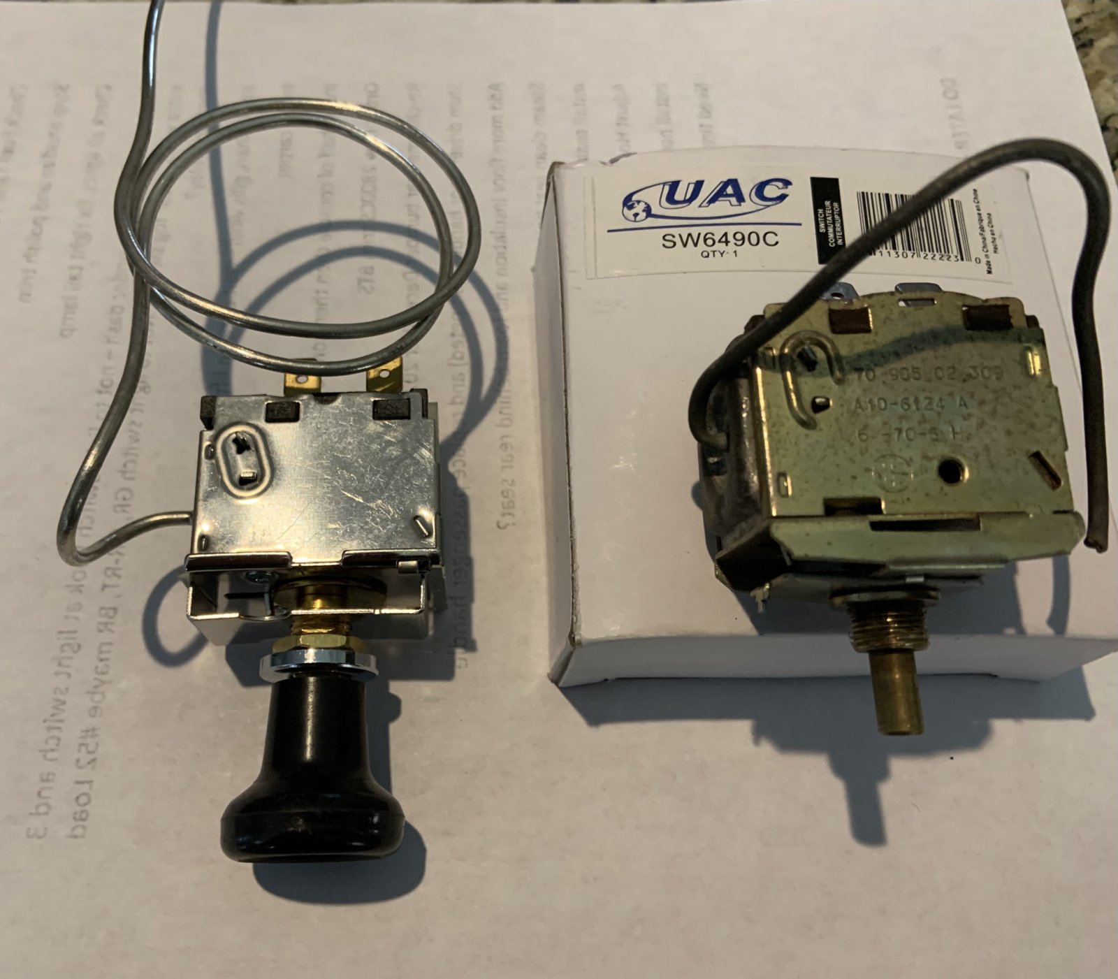

I ended up ordering this one on Amazon (UAC SW6490C) for less than $10 with a 36 inch capillary. The threads are 3/8 inch so it fits thru the hole.
The thread major diameter on the old stat is 0.390 and I can not identify the thread with my taps and thread gauges. The round chrome nut I have will thread onto the new one just a little loose. I believe I can make it work. I did have to sand down the shaft a little so the original knob will fit.
These are pretty generic, I bought the same one you bought about 4 years ago. It works fine.
Thanks, that is good to hear. I started to slide it in today but the end of the capillary is slightly larger so I need to open up the end of the tube going into the evap. Of course that isn't very easy to get to.
IIRC I was able to re-thread the shaft well enough to use the chrome plated nut. Or maybe it was the nut I re-threaded. Senior moment. It was 3 years ago.
