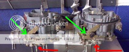

Could you perhaps link a picture of this off-vertical screw? This is the first I've heard of it, and I thought I identified all the parts during rebuild. Perhaps my Zeniths don't have them.
Courtesy of DeQuincey:
green arrows are butterfly screws, red are idle mixture.
