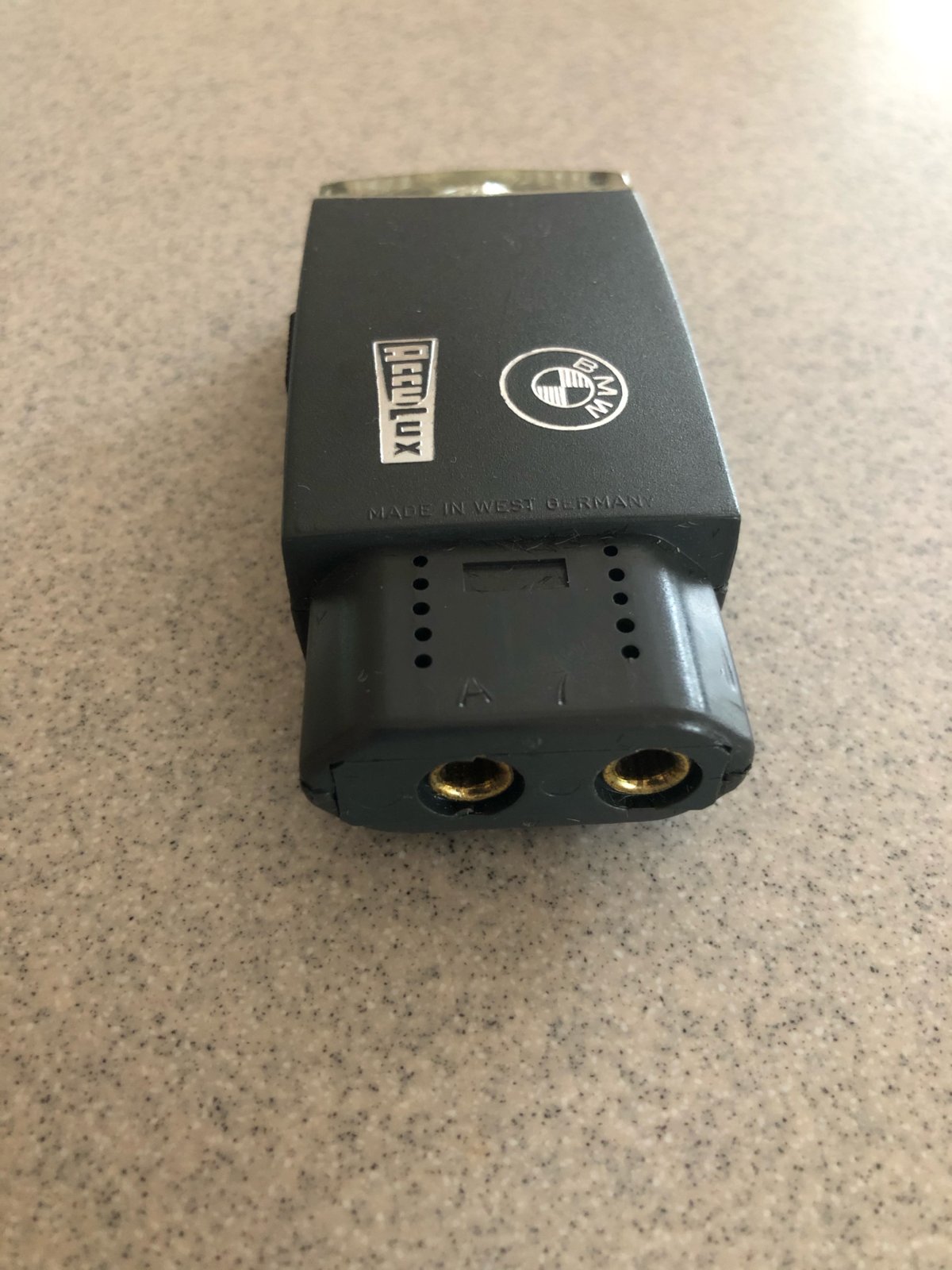

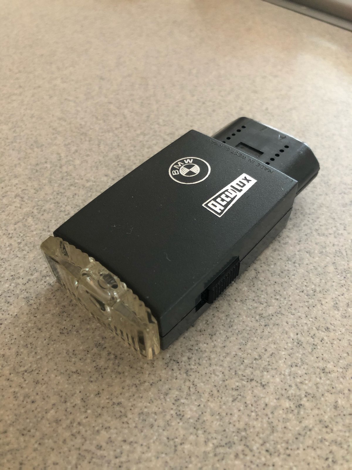

You know you have way too much time on your hands when you want to revive this poor thing in the hood latch/fuse compartment. I am just curious if anyone has attempted to pull this thing apart at the seams in an attempt to replace the dead battery??? If so, is there any approach that one might take so as to not completely destroy the housing!? Thanks in advance for any thoughts.... Greg

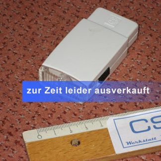

Taschenlampe are available new with LiPo battery, charging indicator light red and green and a super bright 8mm LED in white.
In white!
Expensive but what else do we have to spend our money on?
In white!
Scheisse! That is a lot of beans for an ornament!

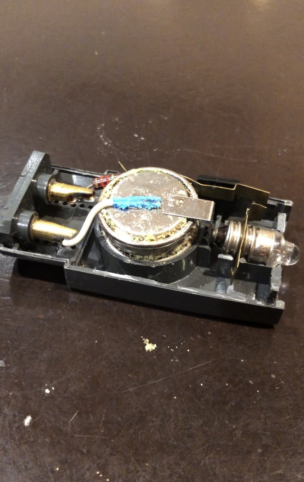

Ok....I found this link on the topic...
https://surfncircuits.com/2017/07/2...-simply-designed-bmw-e36-glovebox-flashlight/
I used a pair of surgical clamps to pry the flashlight apart from the front after removing the clear lens....worked great....the E9 shares the same inner workings as the E36 version described in the link. here is the photo of mine once opened - file(1).jpeg just ordered two of the same batteries on amazon:
https://www.amazon.com/Varta-250mAh-Button-Battery-55625101501/dp/B01DJGKTR0
you need to be capable of soldering per the link above to replicate the original config....looking forward to getting this little bugger working again! Hope this helps anyone considering this ridiculous project!!!

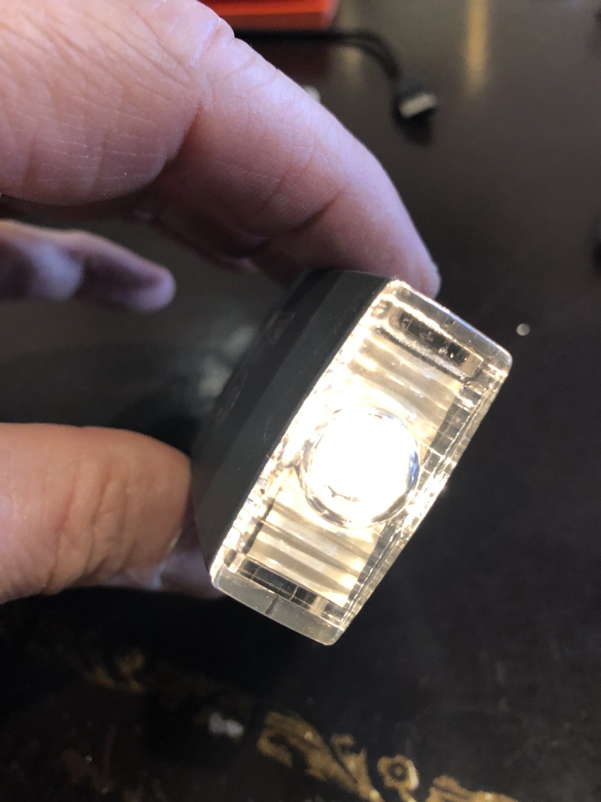

Ok.....I've completed the restoration!!! Ordered a couple of the original varta rechargeable batteries and re-assembled the unit....SUCCESS!!! So this will be the very last item I show the buyer when I finally sell this car in order to get him/her "over the edge" to pay at least $100K....."it even comes with a working flashlight for the fuse area!!!"file-2(7).jpeg
