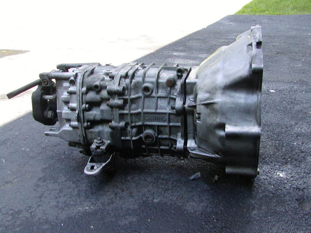

If the unit is a Getrag 265, then there should just be a blocker plate or cover over the hole for the speedo sender gearshaft. You can use the gearshaft from any M30 mechanical speedo trans as far as I know, including the 4 speeds. They aren't that hard to come by. It would probably be easier to source these components than try to sub in the electronic speedo.

The Euro 733s came with the speedo case; those equiped with 5 speeds. Anything is possible after all these years, I suppose. I would reconfirm. Can you tell what year?
If it does have the plug, pull it, and insert your speedo gear.

I saw some pictures on the web and on one I see something on the back cover that may be the speedo cable pick up. it is on the left side, pointing down, at the back. Is that it? (see first attached picture)
I also saw other pictures that did not seem to have this but had a third anchoring point for the trans in the back like the two forks on the side (see second attached picture). I saw that third anchoring point on the trans in the JY. Would that mean it doesn't have the plug?
