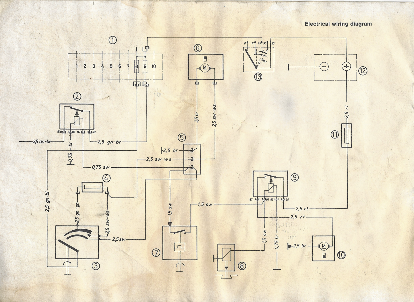

AC wiring:
in the front you have
-the additional fan (which has a direct + from the battery to the relay)
-the pressure switch in the drier
-the compressor
the other wiring is from fuse box to the center console - blower motor, blower switch and temp switch.
There is one wire going from the temp switch to the engine bay.
AC wiring:
-the compressor
the other wiring is from fuse box to the center console - blower switch and temp switch.
Got it - so worth having one heading to rear of console for that.
  • Like
Reactions: Dlc
in the wiring diagram you have
-12 battery
-11 fuse
-10 add'l fan
-9 relay
-8 compressor
in the front
3-7 sit in den center console
