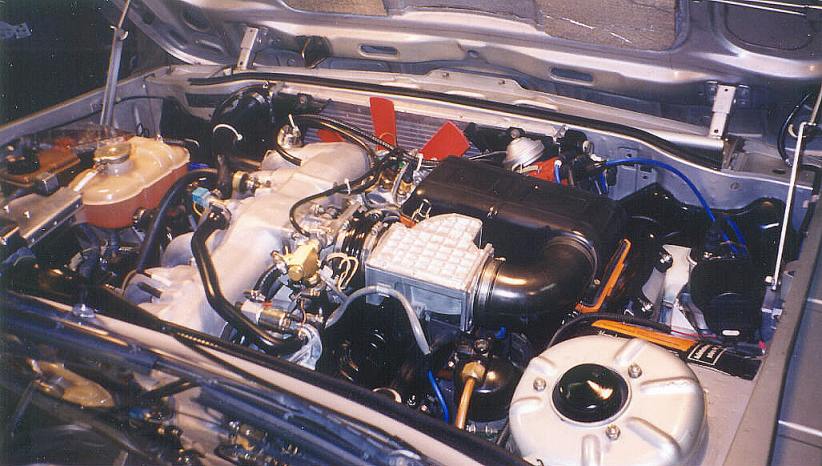

I took a picture of the engine and it must be Djet system. Is there a big difference Djet and Ljet, and which of the two systems are the best! here is a little video of me running in the hall who can see how the momentum running up and down.

It looks like you have a very clean car. But it is not easy to tell much about your idling issue from the video. Idle speed seems a little slow, but it is hard to say without seeing things in person. Does the engine come close to stalling if you have the lights and other accessories on?
From the video, it may be that the only thing you need to adjust is the idle speed. This can be accomplished by turning the fat screw (at the lower part of the throttle body) counter clockwise. If you can locate the throttle position switch and pretend you are sitting in the car looking at the switch, the screw is at 7'o'clock position. The picture below may help. The potentiometer is the knob on the box containing the computer. Lift the right rear seat and you should see it on the floor. If you have a knob on the computer, you have a DJet.
LJet system is far more modern than the DJet. When the DJet works well, it is more than adequate for the engine. However, the LJEt is probably considered far superior, because it is more modern and far more precise at delivering fuel. As to which system is the preferred system, it depends on who you ask. The E9's were originally equipped with DJets not LJets.

many thanks to you all.
I will try tomorrow with the things of the bruised. Is it difficult to switch the system off to j-jet when you have the d-jet. When I run a lot in Germany and the Munich area, it appears that there are many places where you can buy a Ljet system

I've been and checked all the things you described. And yes, I could adjust the momentum of the box that sitting under the right rear seat (super cool), and the screw is on intake manifold. But there was something that got my thoughts on that would be bad electrical connection, as it sometimes seems as my power windows are not working the same with the radio.
