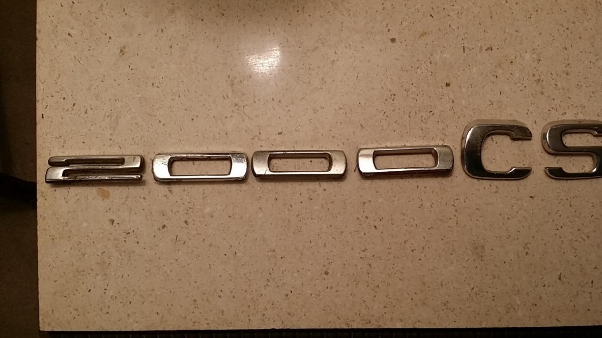

I'm ready to mount my 2000 CS trunk badges and wondered what the best way to do it is. They aren't exactly mint (especially the "2") so I'd like to be so I'd like to be able to upgrade them if I find better ones. Thanks.
My trick for them
I made a thread on the little aluminium cilinders at the back that stick through the body, and then a washer and nut from the inside.
This also makes it easier to get the areas superclean between the letters. just unbolt, clean, and reinstall.
