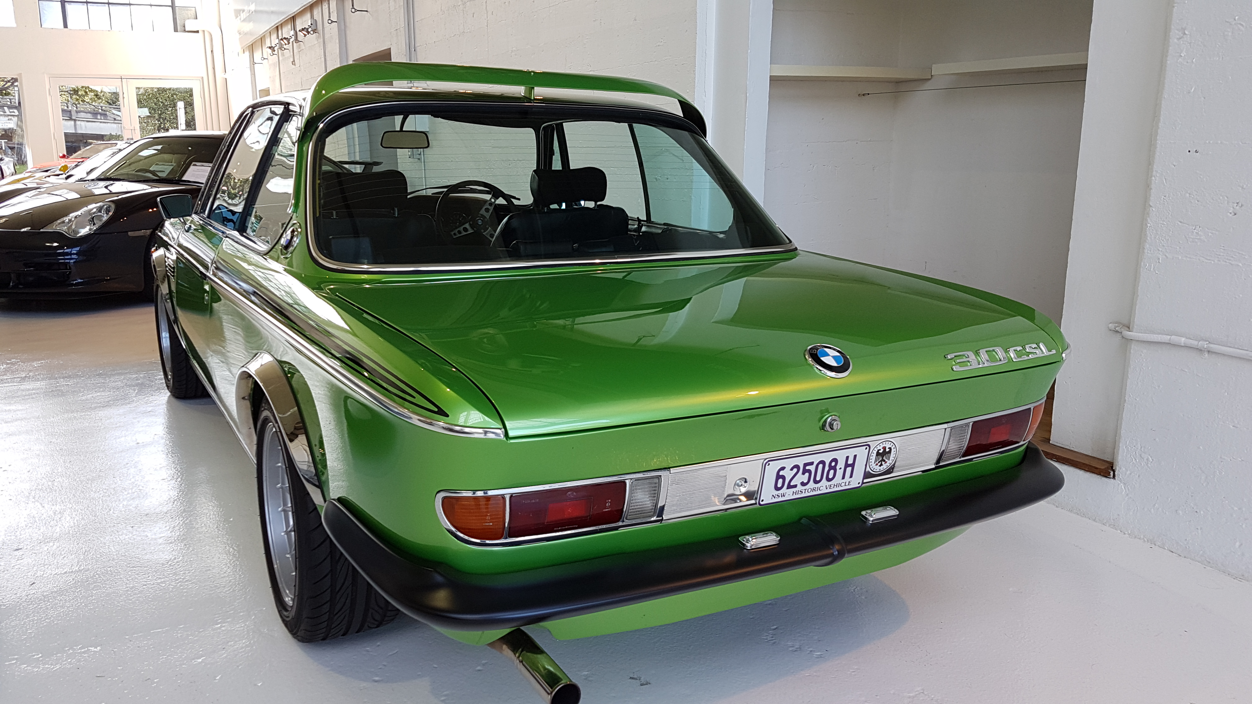

I have the mounting parts and licence plate lights already, since I have a lightweight bumper on at the moment, hopefully the existing parts are interchangeable.
Shame BMW don't yet make part 10 or the under-riders, so will need to source these separately somehow.
you can install the bumper without the under-riders and in your case with a CSL, if it doesn't have the holes for the under-rider ... you probably do not want to drill them in the lower valance. the trim strip is a different issue, unfortunately i sold my spare last year.
