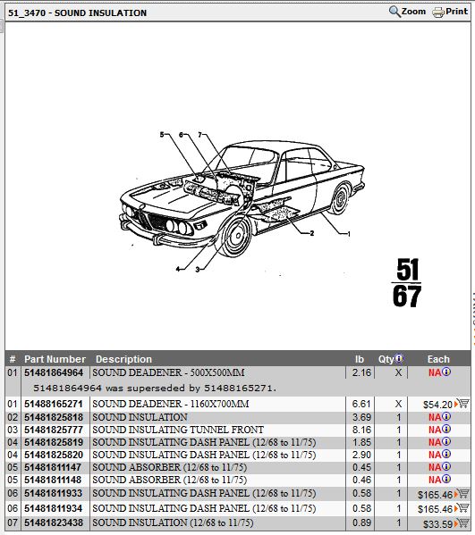

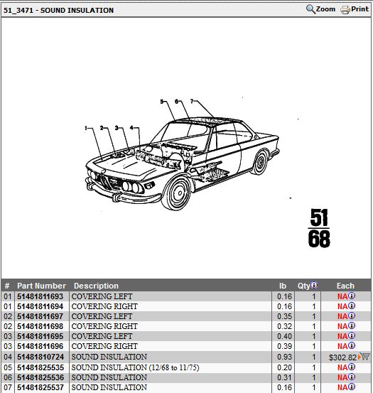

for the sound insulation at the firewall - look at section 51 - body trim on penskeparts.com - see attached pix

Still available from BMW, you just need to cut it to the proper shapes. OCCoupe has the part number, it was used up through e28 I believe.
Hi Thanks, I will see what I can find from OCCoupe, the parts books online say NLA, but maybe that is pre-shaped
