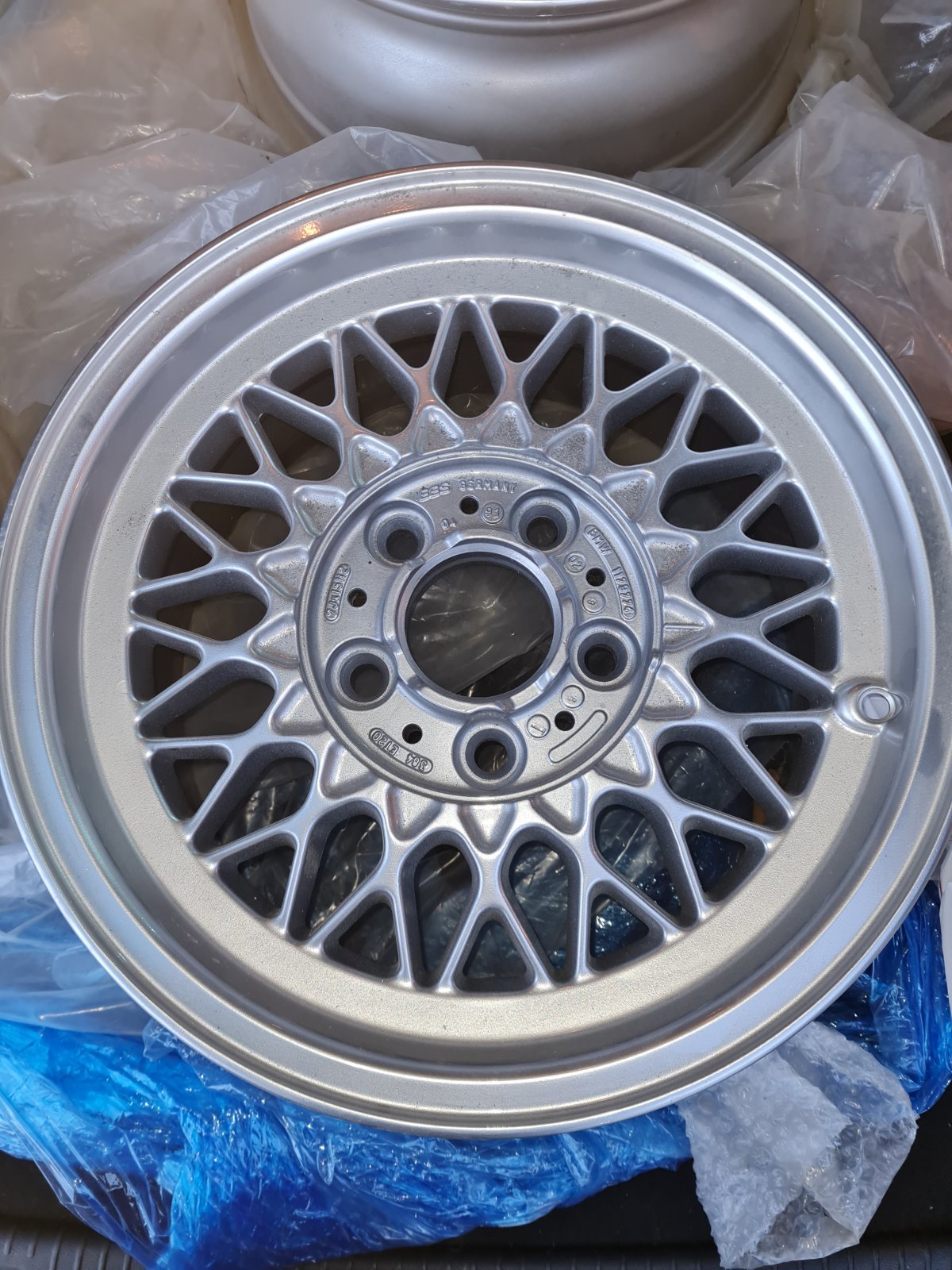

I have 15" and 7" width wheels as shown in the picture. What is the maximum tyre size I can fit on them?

You can play with this calculator.....
Tire "size" is a combination of tread width and aspect ratio.
Wheel "size" is a combination of diameter, width, and offset (backspacing)
Certain tire size, wheel diameter, and wheel offset combinations can interfere with body and suspension parts even though the tire will fit properly on the wheel.

@HusseinBM - please look at the FAQ on tires / wheels - link below in my signature. the best size that is relatively available is 215/60-15 ... the other size that works is 205/60-15 (just fewer choices). the question i would ask is what is the offset / width of the wheel? that has a lot to do with what tire size will fit.
Thanks a lot... it says ET20 on the wheel
