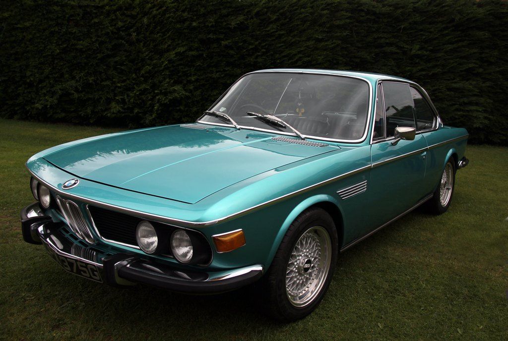

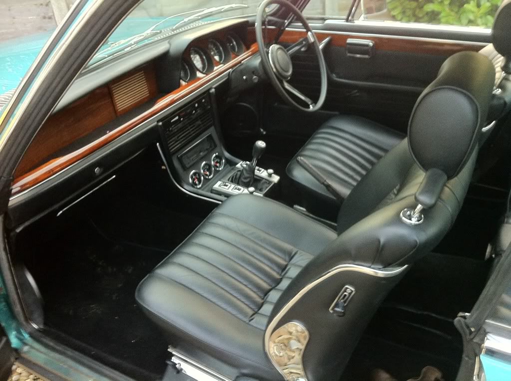

Thanks and appreciate all contributions. Have a few pics of the beast in question - It's a 1969 2800 CS - some of you may recognise it from when I posted regularly a few years back.
