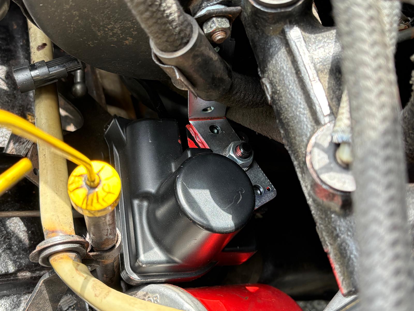

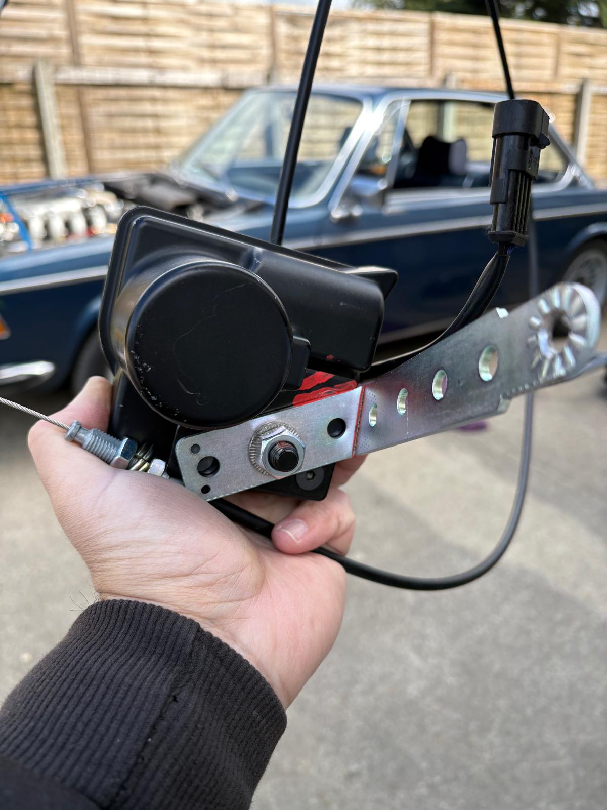

I installed the servo unit in the engine bay, in a perfect location with enough room. Took me a while bending some muck-ups before finally getting the bracket right just at the correct angle. (photo 2 and 3)

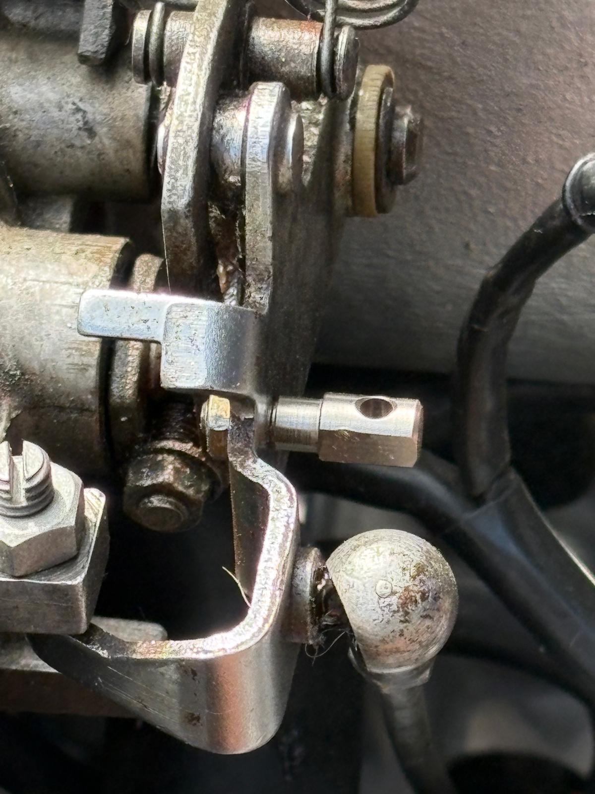

The cable from the servo pulls on a small axle that I installed on the main throttle plate. I had to carefully drill it at the right spot so that the nut does not interfere with anything along the complete stroke, and paying attention the stroke calculations described in the installation manual. (photo 4)
