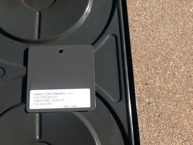

The best match I have found for the Zenith air cleaner housing is RAL 7043, wish it had a touch more blue but no one will notice when done.
For D-jet air cleaners OCCoupe used RAL 7022 and I used that as well on the b35 air cleaner, almost dead on.
Posting for posterity and future searches.
