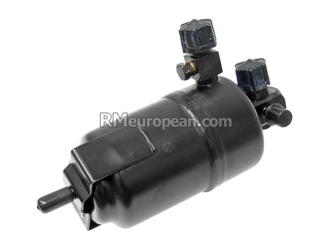

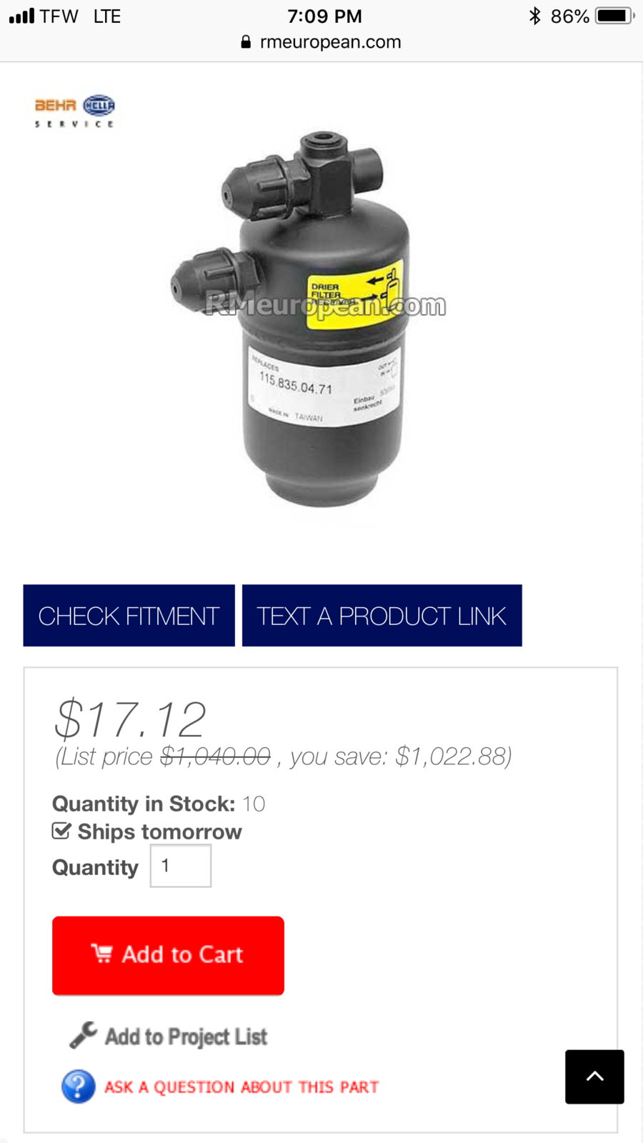

I'm in the middle of reading Rob Siegel's AC book, Just needs a recharge. Does that MB dryer have flare connections or O ring connections? An important consideration if you are replacing items with new ones as the O rings seal better but require different hoses and connections. The MB dryer caps make it look like a flare connection. The RMeuropean site makes it hard to find things that aren't OEM for your car, you have to choose a different car, and then search for parts. I picked an '85 535 and found this dryer which looks to have O ring connections and a similar price.
Sooo many choices....
