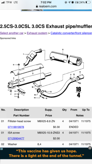

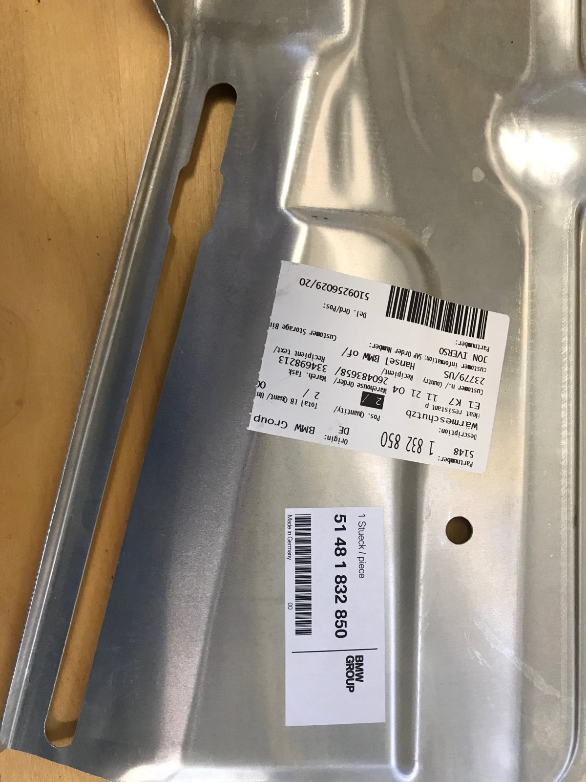

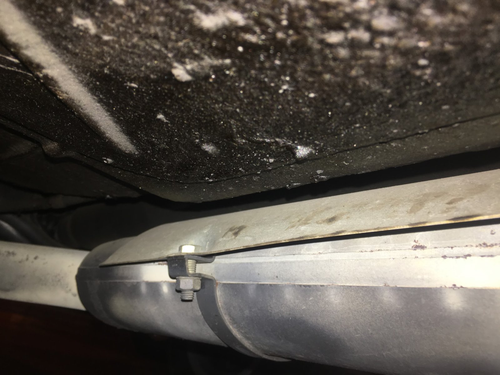

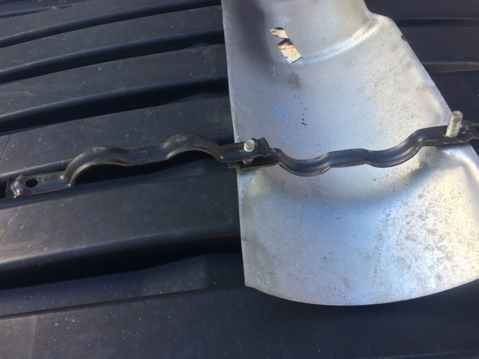

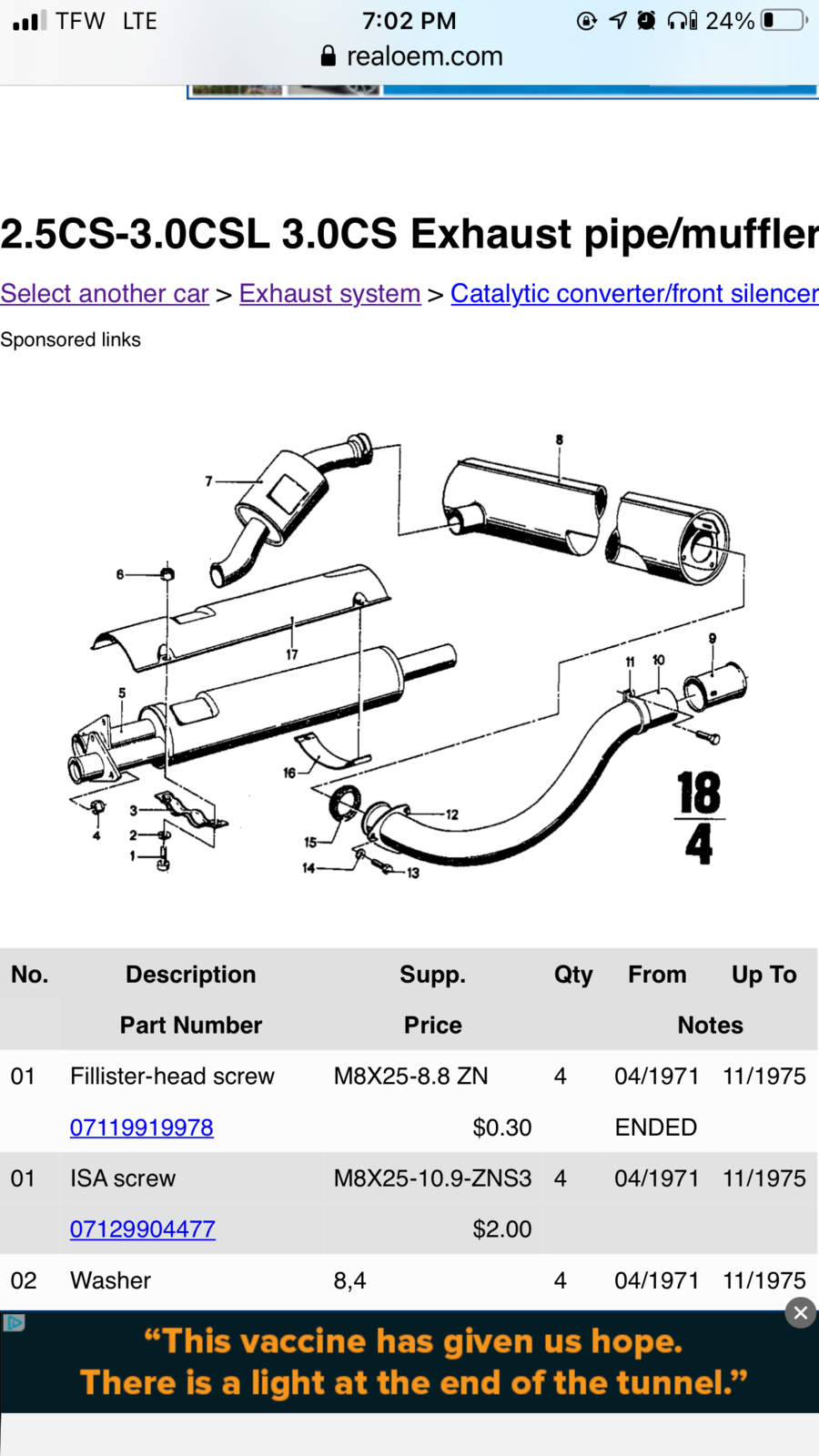

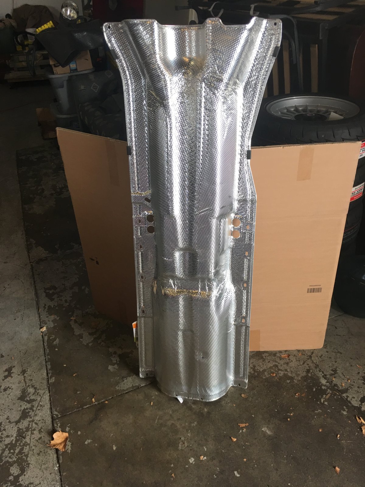

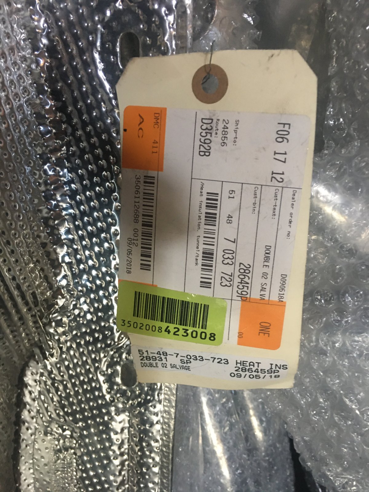

After measuring 145*F at the seat belt bracket inside the car crossing Texas in July I decided to make copies of the factory heat shield. We install them on cars that are driven in hot areas.
Engine bay:
Hood seals
Drain tubes
Exhaust:
Heat shield above down pipes
Heat shield above muffler
Interior:
Cascade vbx
Cascade heat shield

I honestly don’t know. They seem to be installed on very original low mileage cars.

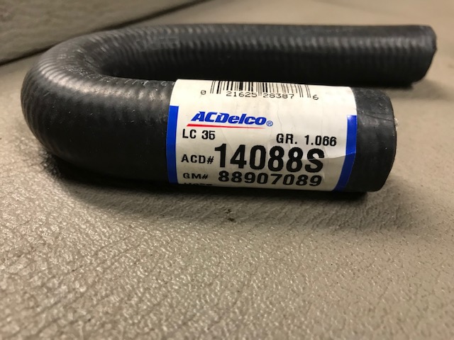

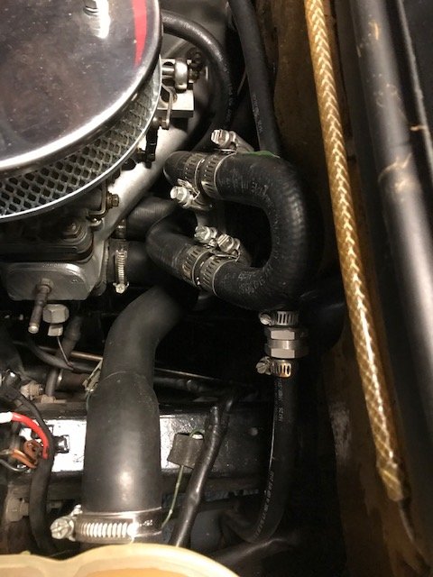

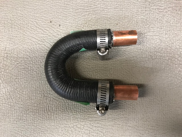

I have tried the heater bypass a few years ago. In my case. I plugged the heater inlet and outlet, then added a hose that would follow nicely in a smooth curve to attach under the Weber carb nearest the firewall to complete the coolant path. So with the heater out of the system, all was fine except in certain months when I really missed having some heat. I mean it was all or nothing. Eventually reconnected everything.
This year, it was such a hot summer here, I disconnected the heater again, but I improved the hose routing. I found an AC Delco hose with a 180 degree bend that I could shorten. Then with some 1/2 inch copper pipe and couplings, I could fashion a nice tight fit, using the original, and still-in-place heater inlet/outlet hoses. They could bend a little bit to fit the Delco hose, and no kinks. Install was 10 minutes, and when I want to reconnect the heater later in the year, perhaps another 10 minutes job. (Plus the time spent mopping up coolant) ;)
Actually, if some coolant can be drained from the tap at the bottom of the rad, before taking hoses off, you can minimize the mess.
Without the heater attached, I was amazed at how cool and comfortable my Coupe has become. Exceeded my expectations. Some photos :
