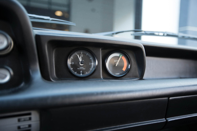

BMW had dashboard mounting of gauges for the 2002 Turbo that is interesting.

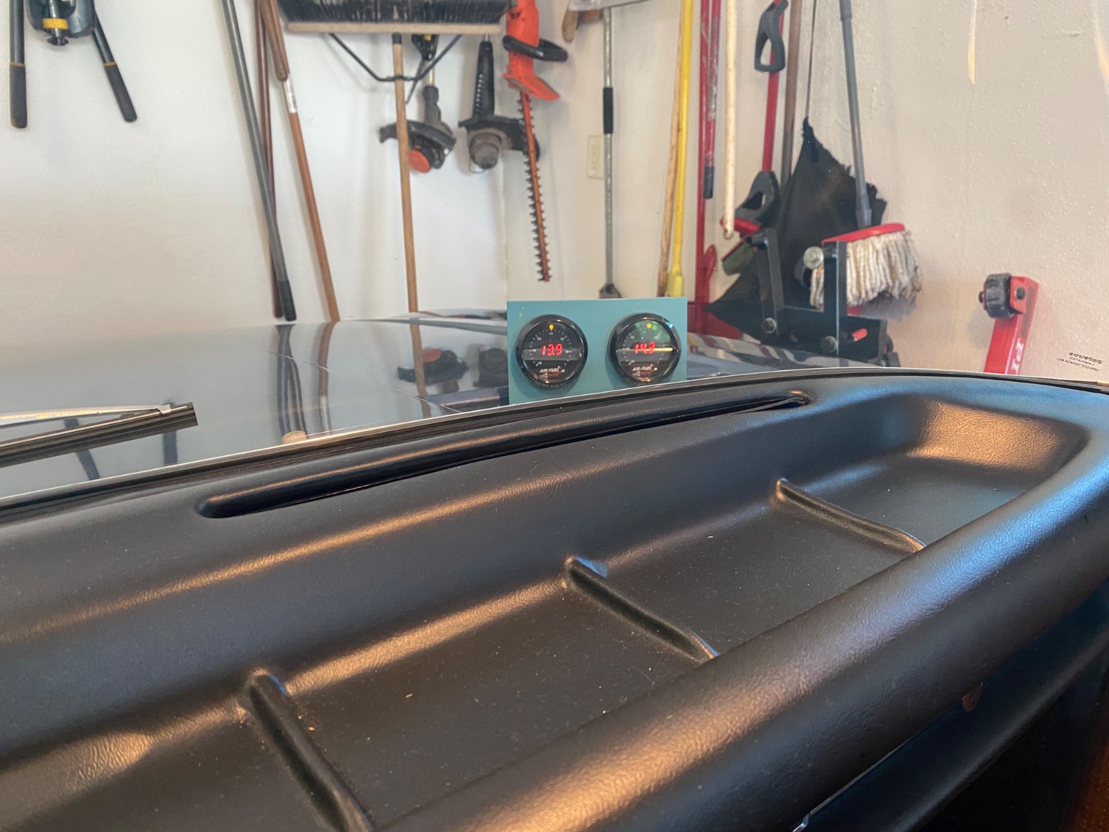

I did find a 3d print version here...

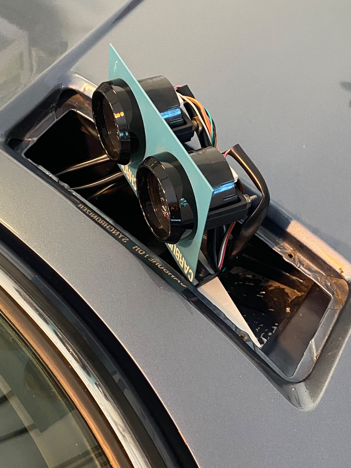

I took the grille out for the right side of hood at the windshield. Aluminum strip into underside of hood grill screw holes. Mounted AFR gauges into grille opening, Harness dropped thru hole down to hood stays then back to hood grille opening down to O2 sensors. found power and ground at washer pump. Then found out wiper blade was in way. Remove wiper arm and blade.
Thank you.
Will get you picture tomorrow.

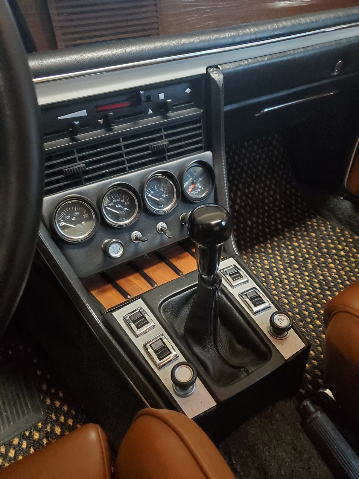

Here's my installation, but Rick is right. This does tend to make you obsess over your tune.

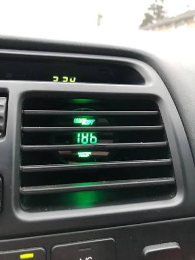

Since it’s only the AFR, you could hide a digital version inside your vent. If you don’t want to drill a few small holes in your original duct, you could get the 3D printed duct from a forum member (forget who)
Like this:

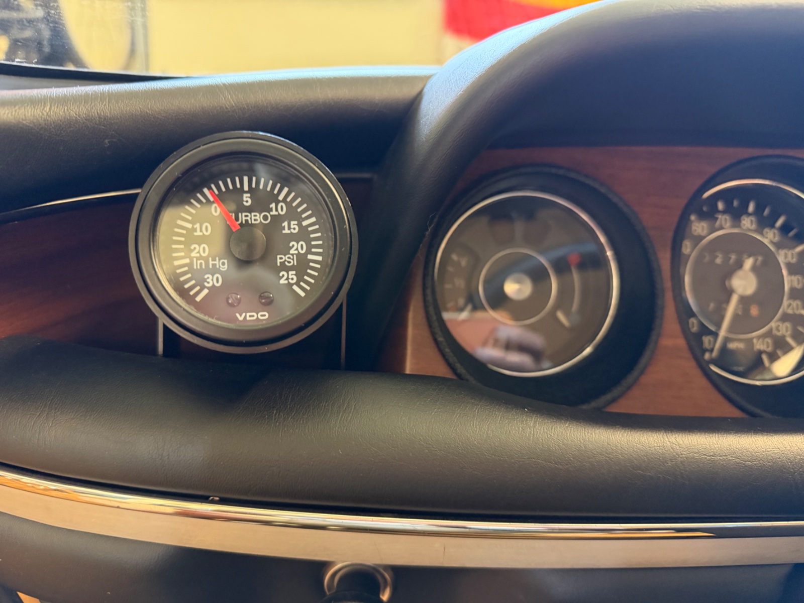

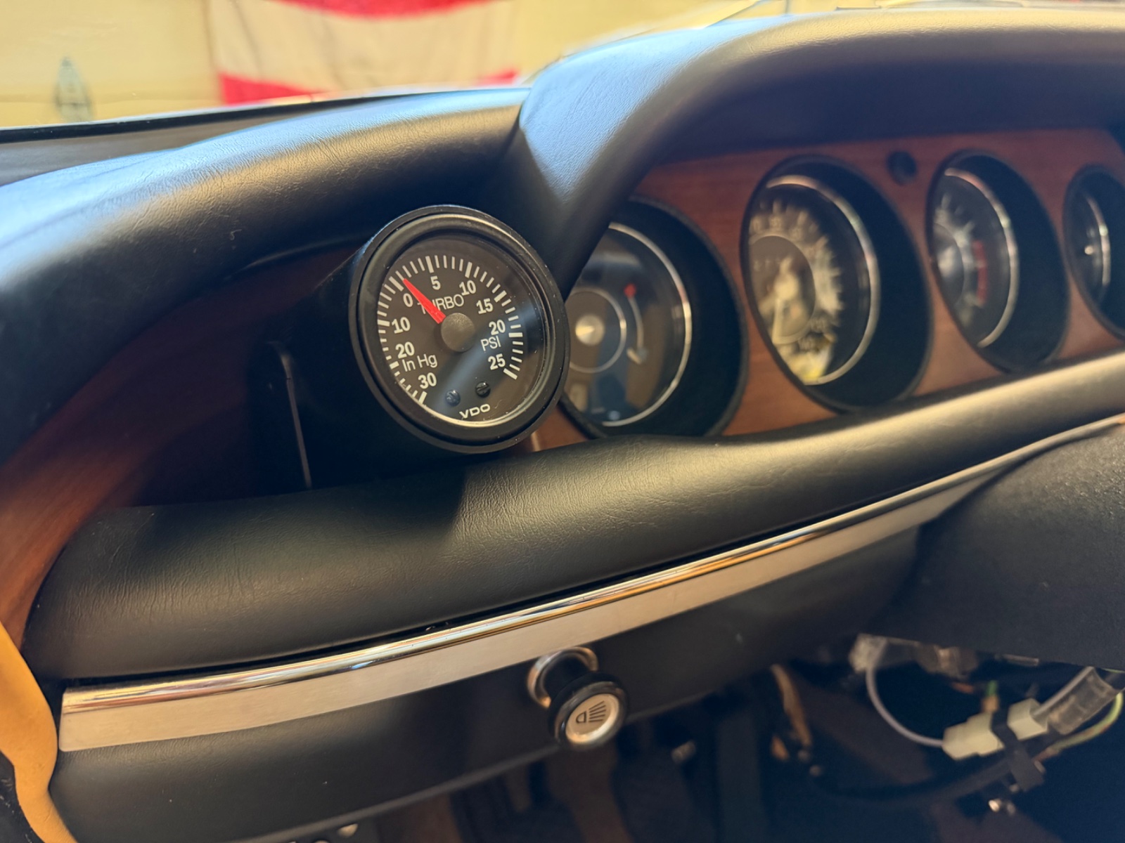

Here’s a picture of where I mounted my turbo gauge. The gauge has a mounting bracket and it fits perfectly. That corner is pretty useless and it’s only a few degrees off Speedo and tach. Mine has both boost and vacuum. I mostly drive off my tach but when I go into boost it lets me know when I’m reaching my 15 lbs limiter.
Had to drill a small hole at the back and most people don’t notice it in that position. Important if you’re trying to stay period correct.
Regards, Jon

In the crease where they meet. Plenty of room under the horizontal and behind the vertical. I was very careful in drilling and used a pilot hole, long drill bits, padding and patience to not scar the dash works.
Regards, Jon

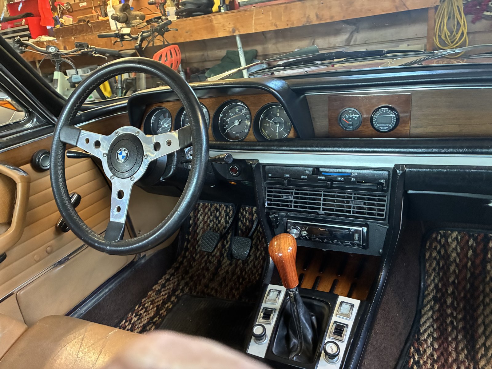

My Innovative AFR gauge is the one on the right in the dash speaker location. It’s hooked to the header collector for cylinders 4,5,6. Plug comparison to ensure cylinders 1,2,3 are getting the same.
