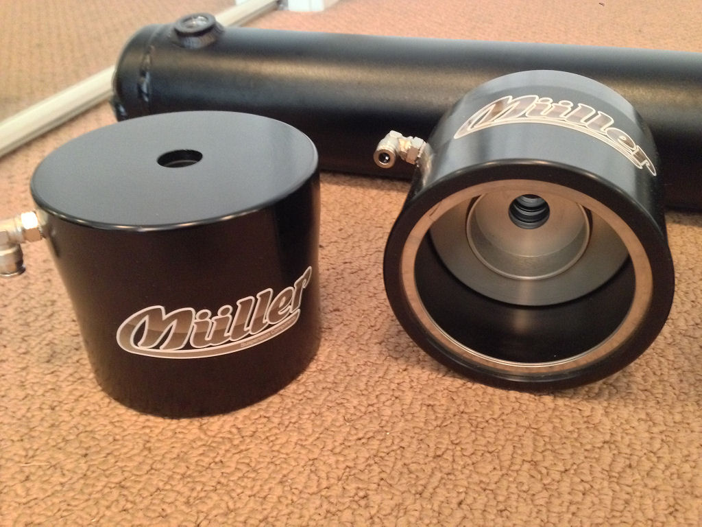

Instead of going with bags, you could also use the smaller pneumatic cups that you put on top of your regular coilovers in the front, which allows you to lift the front of the car about 2 inches when you need it.
I don't know if this is enough for you to access your driveway. Not meant to compensate for passengers. Maybe you already know about this option, but just a thought.
