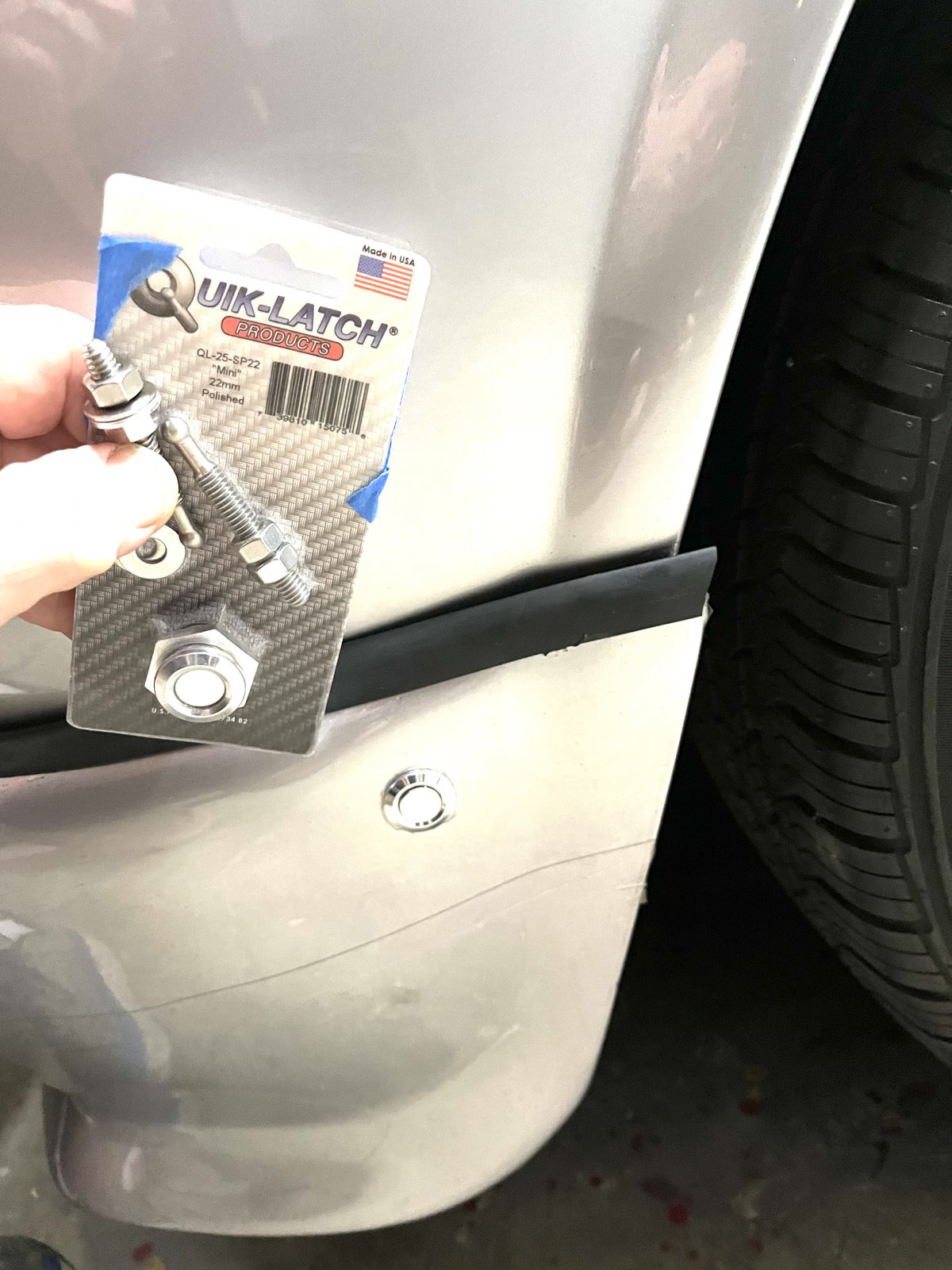

Mario put threaded SS rivets across my front valance to mount the spoiler. Better than screws, in my opinion.

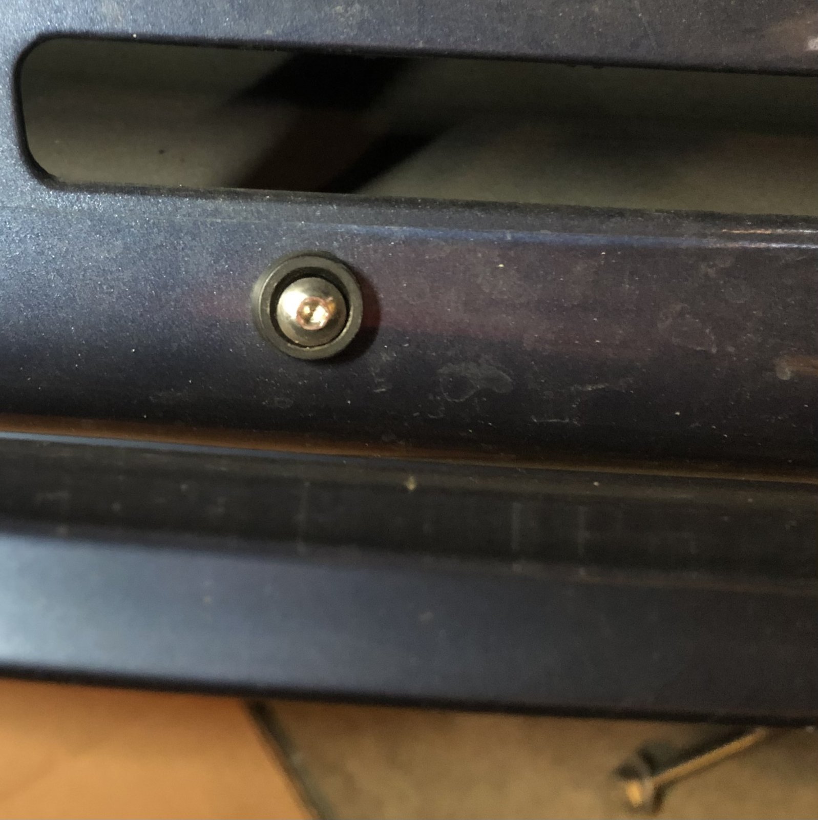

Those look like allen heads with neoprene washers. Threaded ‘rivets’, rivnuts or screws.
I don’t know why Mario chose SS allen headed machine screws. All I know is I like the install, it’s very strong, easy on/off, and will never rust. A sheet metal screw would eventually work its way thru any paint/coating and become a place for rust to possibly start, unless you blobbed something waxoyl on the screw and sheet metal. AFAIK, VSR is always looking for better ways to do better work, which is a hallmark of a truly great shop.
