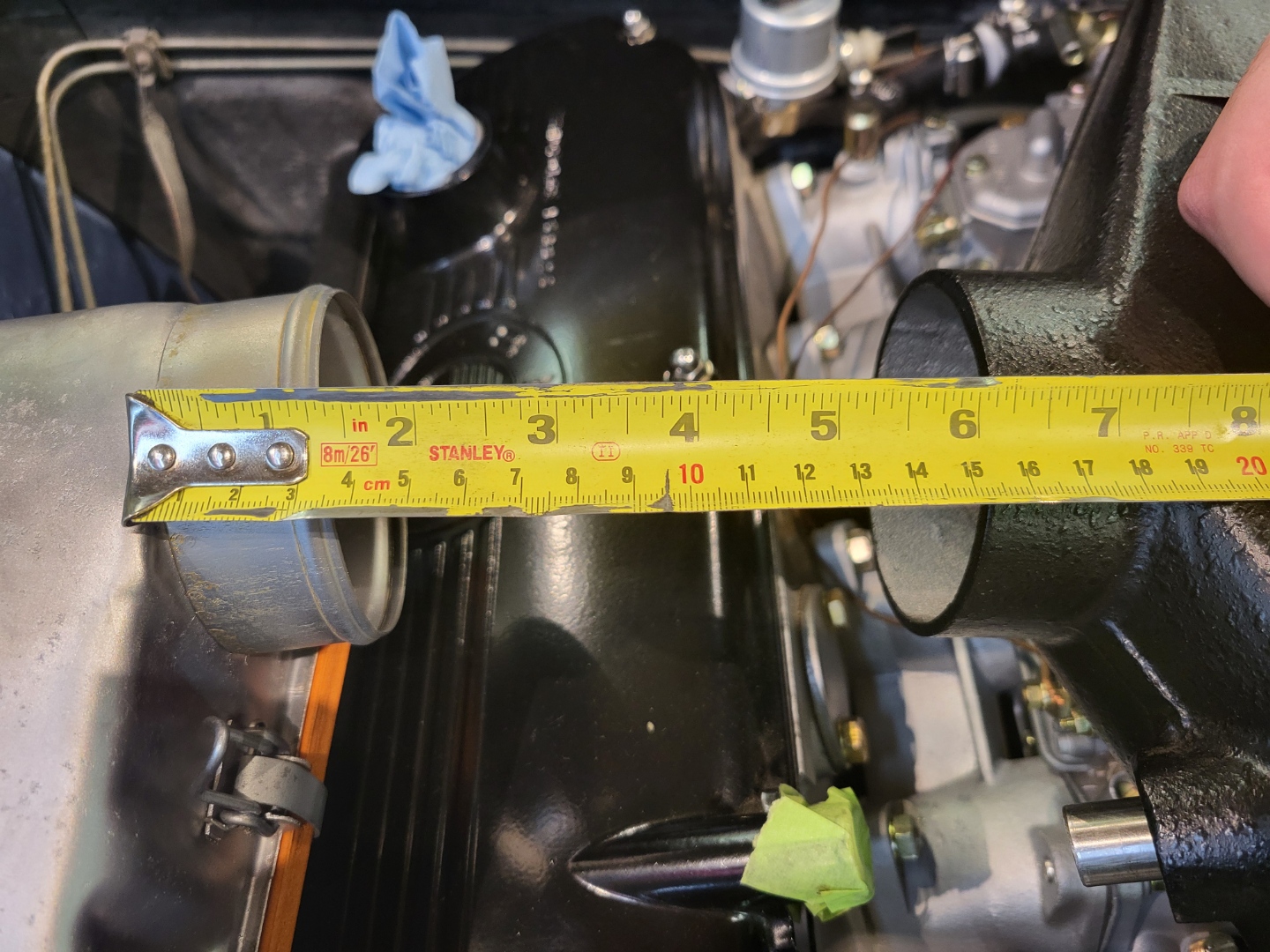

Hi Guys,
Looking for a hose from Alpina airbox to air intake. Anyone have suggestions on what route to go? I know of the original 80mm paper air duct tubing but I don't love the look of it. If anyone has something they found that looks somewhat OEM i'd go that route. I know I can find some generic corrugated hosing options but wanted to reach out for better suggestions first. Mechanic has it pegged at 3.25 inch diameter and need a little over 7in long.
Thanks.
Hi Guys,
Thanks.

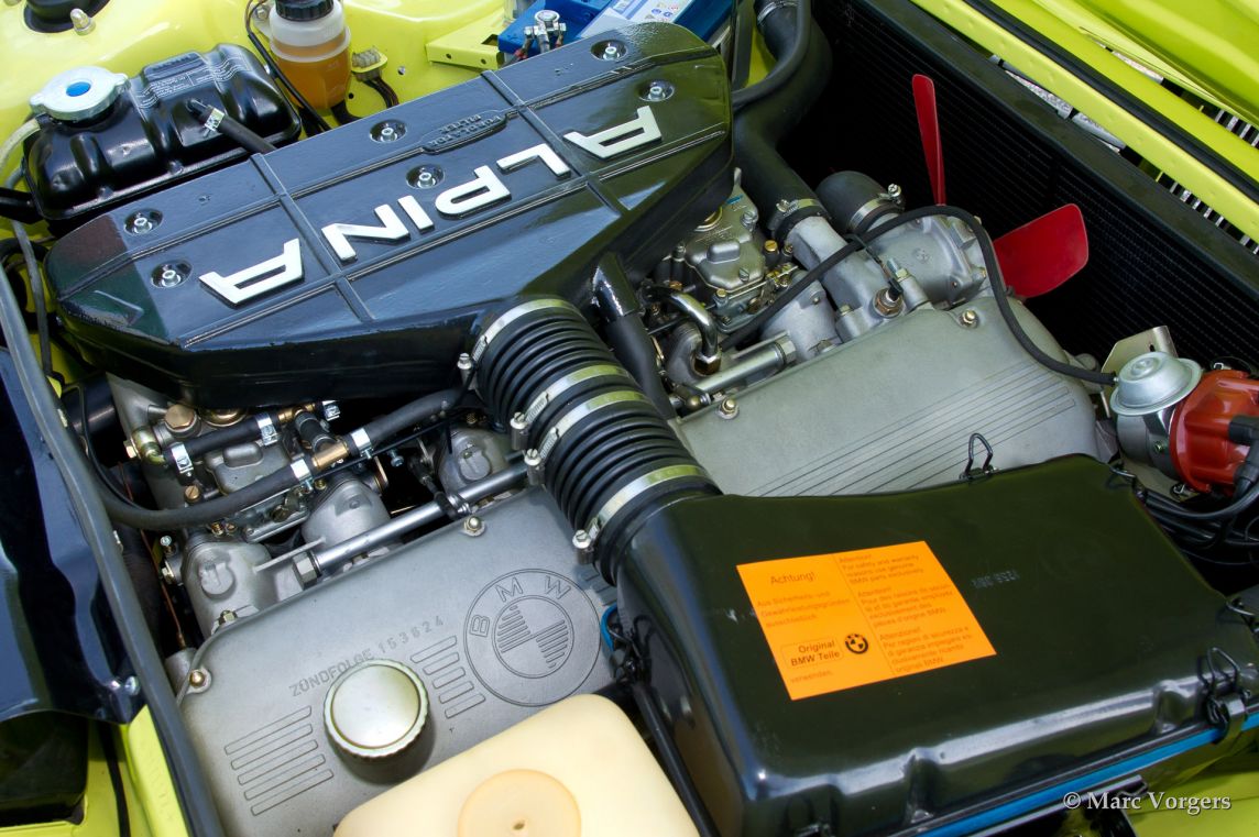

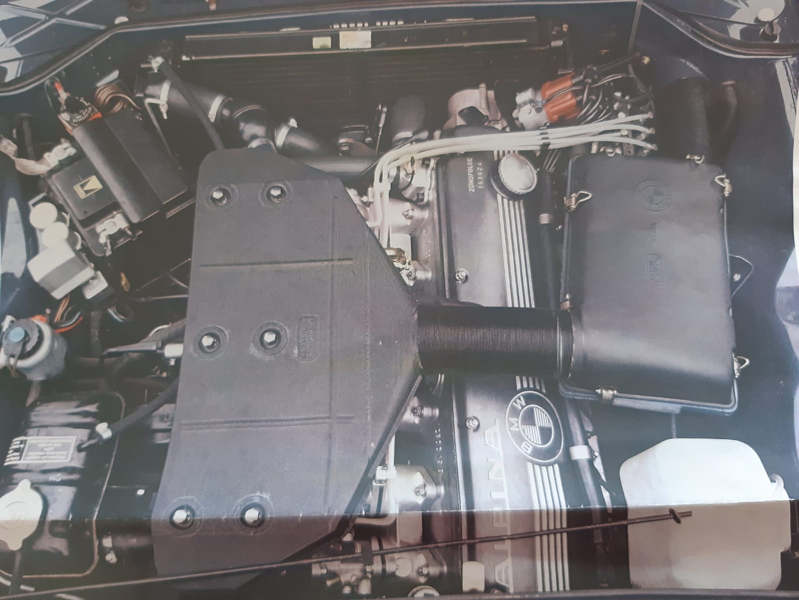

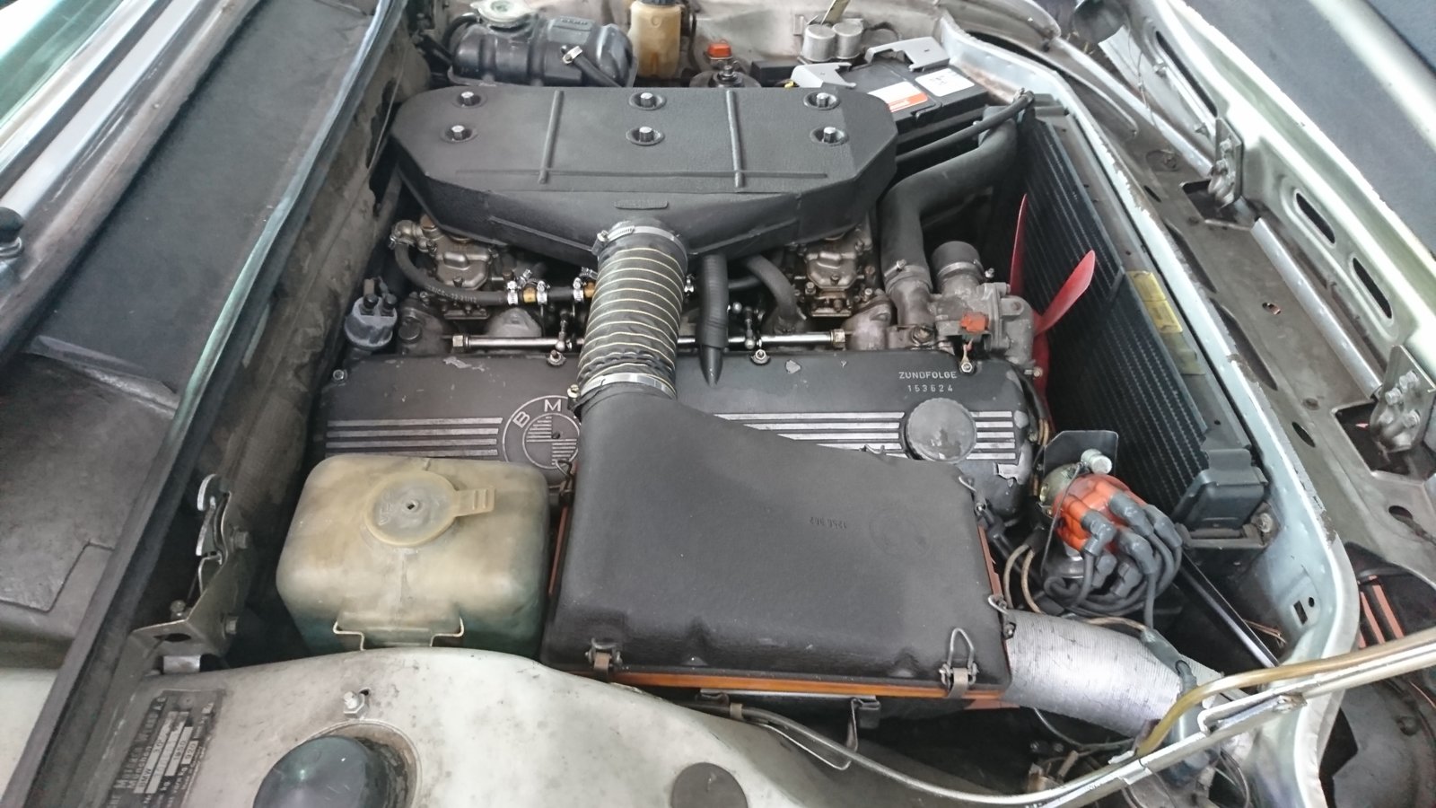

On Alpina's they used a paper hose for part 5 opposed to the rubber bellow. I found a solution though. Thank you for the response.
Original is something like this:

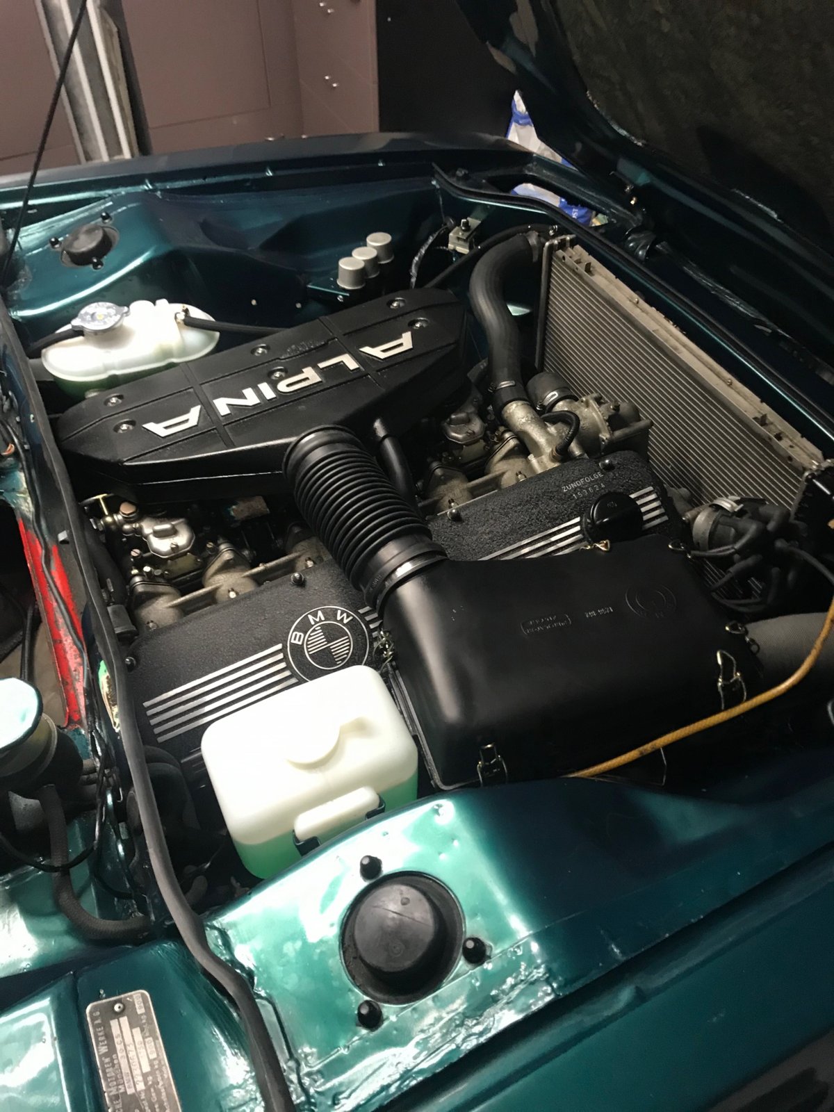

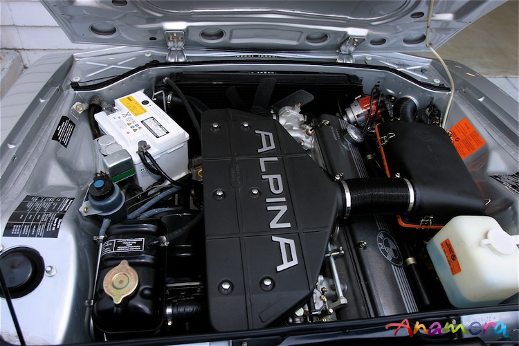

This is pretty tidy solution with new parts:

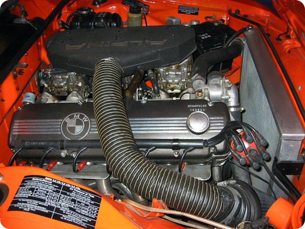

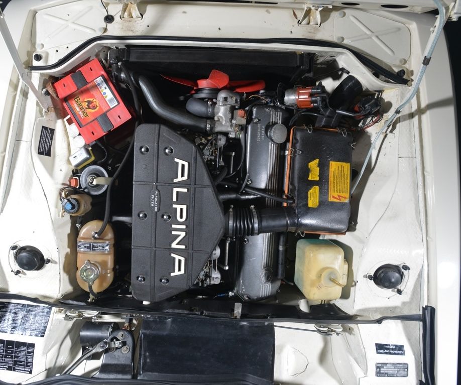

Another variations...

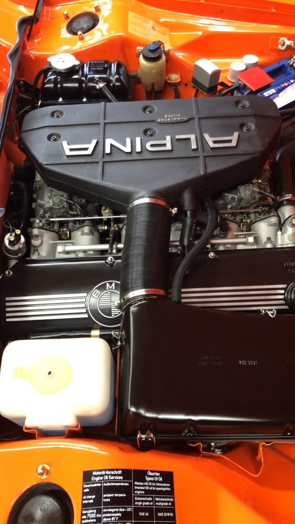

bonus haha
