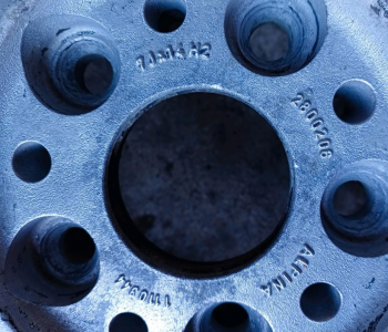

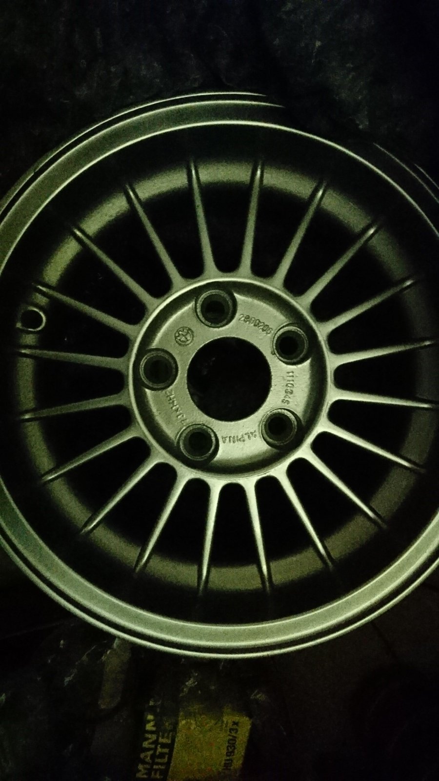

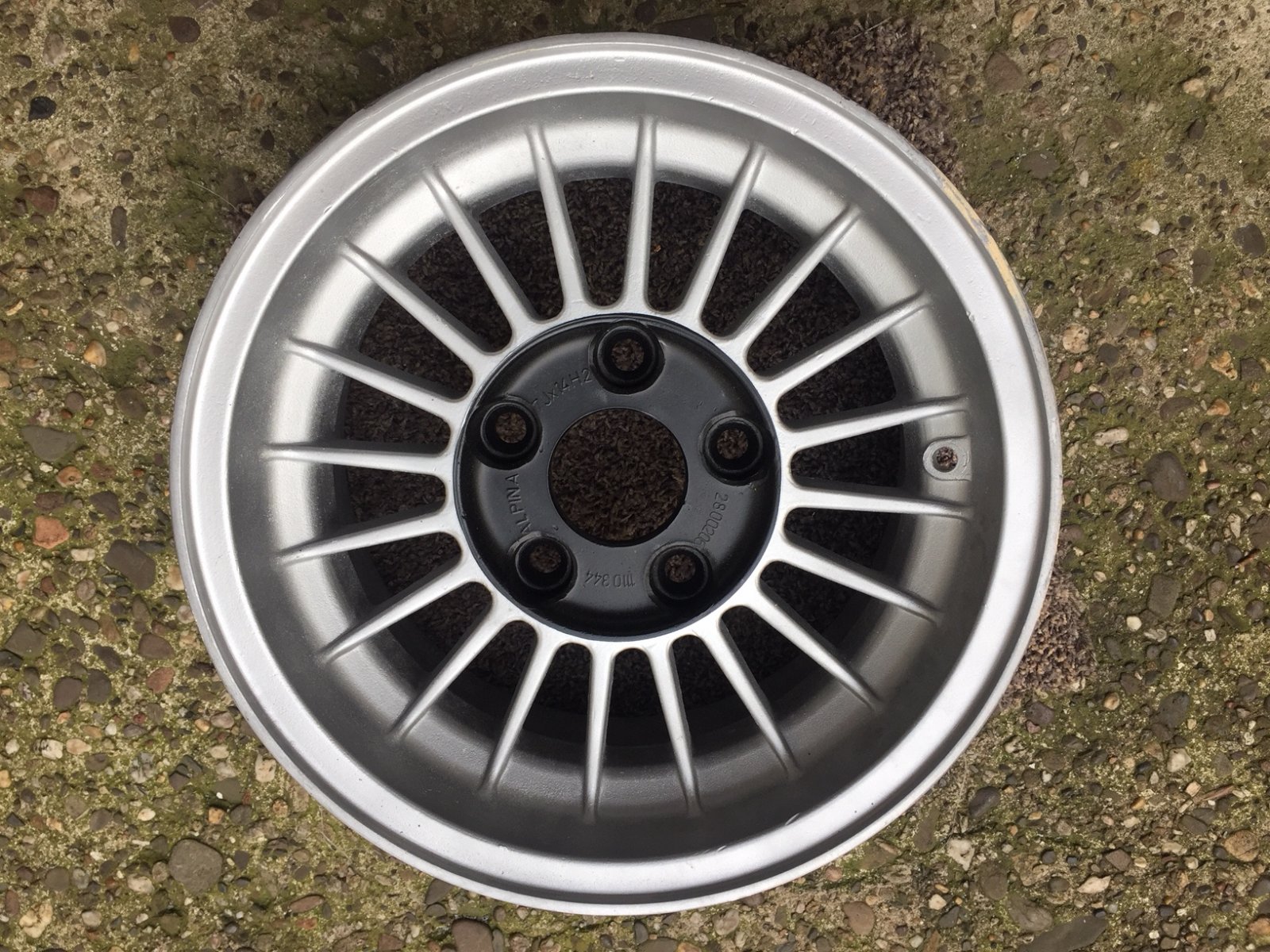

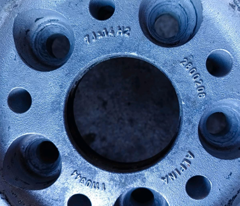

I faced at least four different shapes of ALPINA on the 14 inch rims.
For example:
this one looks really as fake part but maybe the logo evolved over time or manufacturer
I was also looking for it but with no success.
You have to differentiate between the 5 and 10 hole Alpina rims.
The only Alpina 7x14 rims that were installed on CSLs were the 5 hole type, of which there are 2 types, 1110344 and 1110345.
AFIK the 10 hole Alpina rims were not officially for E9‘s.
Just some weeks ago Gerhard explained the history of the Alpinas in our german Forum (of course in german, sorry )
Some facts: the five additional small holes where installed so that the wheels could be mounted on a newly invented wheel alignment equipment .
Of the early 1110344 type the are two versions, the later one from 72/73 with a smaller rim bed.
