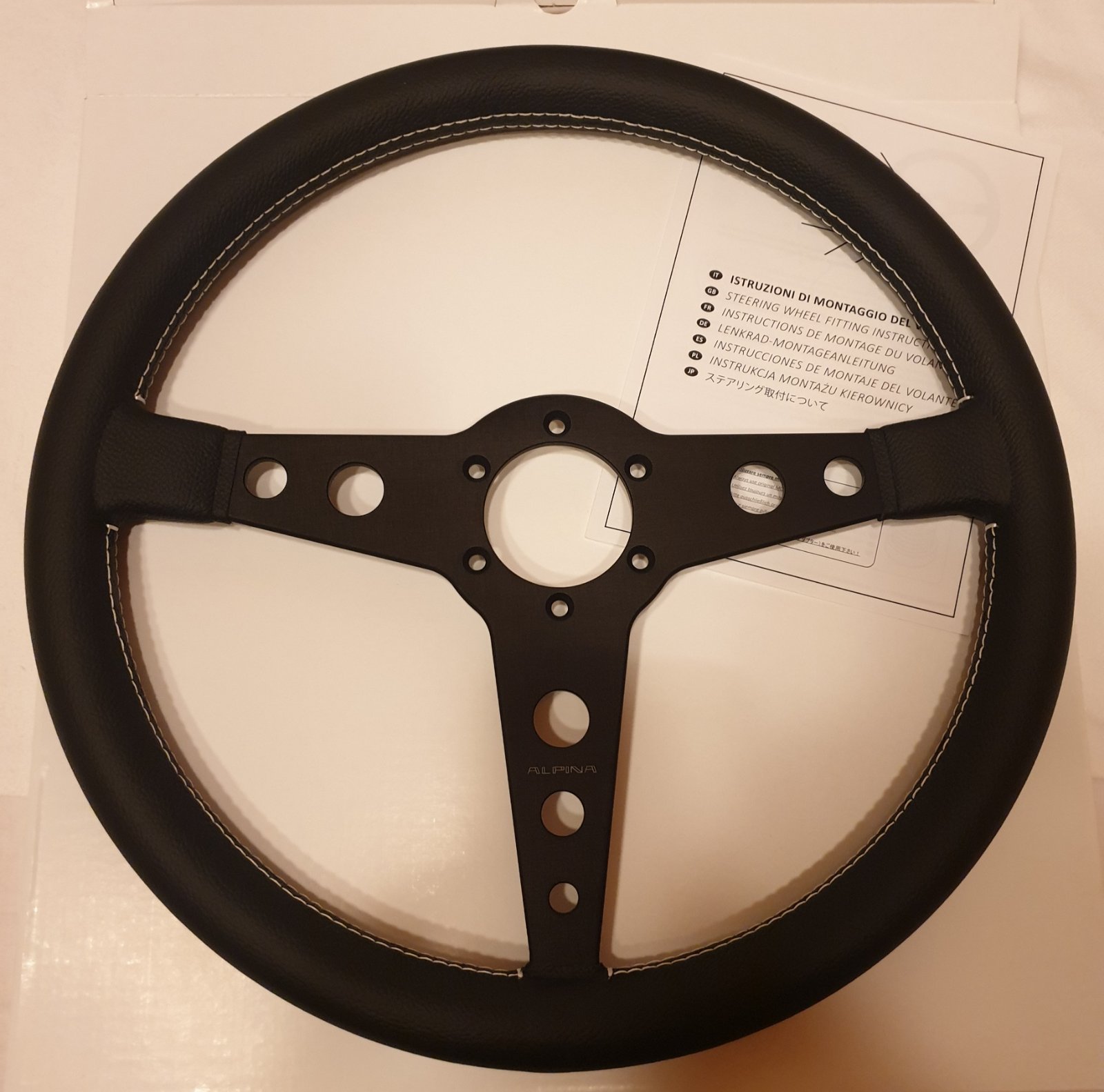

as mentioned earlier, I gifted myself with the reproduction of the Alpina Momo Prototipo 380mm in black.
Now that I have the steering wheel I always wanted to see in my 3.5CSi, I think it would be a good time to select from the other wheels I collected as "spare" which parts to use / keep an which parts could finance other optimization projects :)

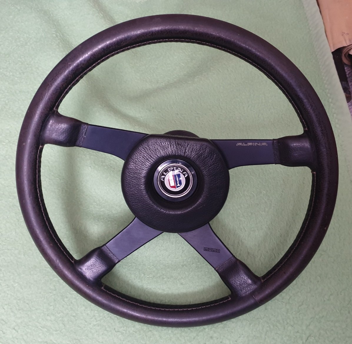

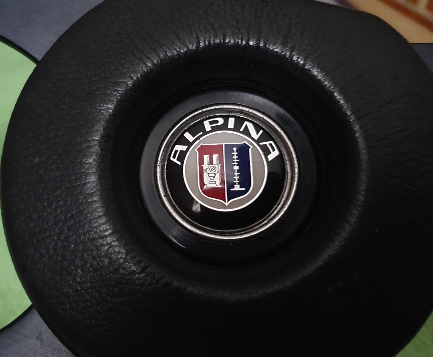

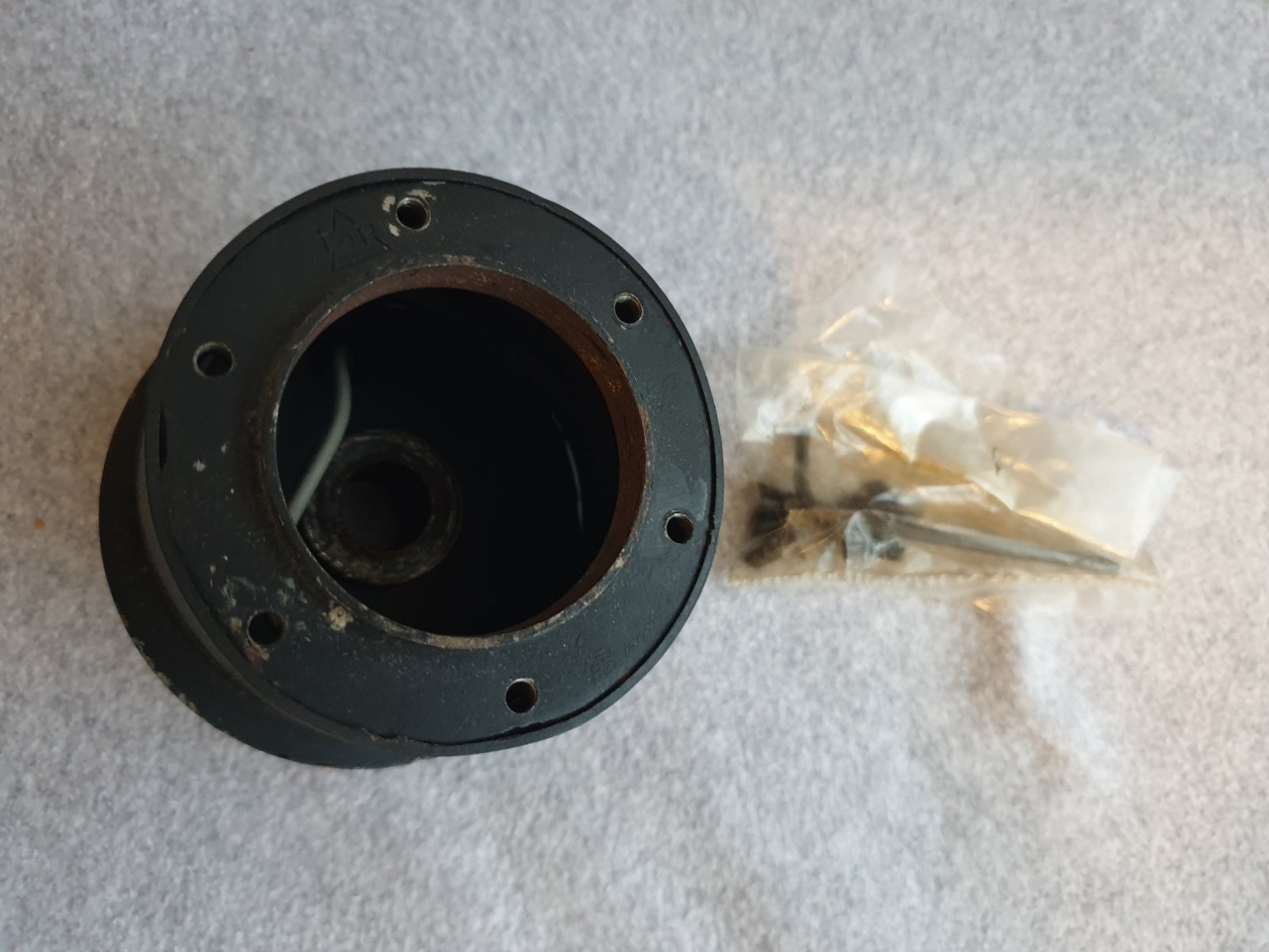

I have this four-spoke Alpina, with correct horn button showing carburetor and camshaft with a silver metal ring around the button to push and a S153 154 155 hub:

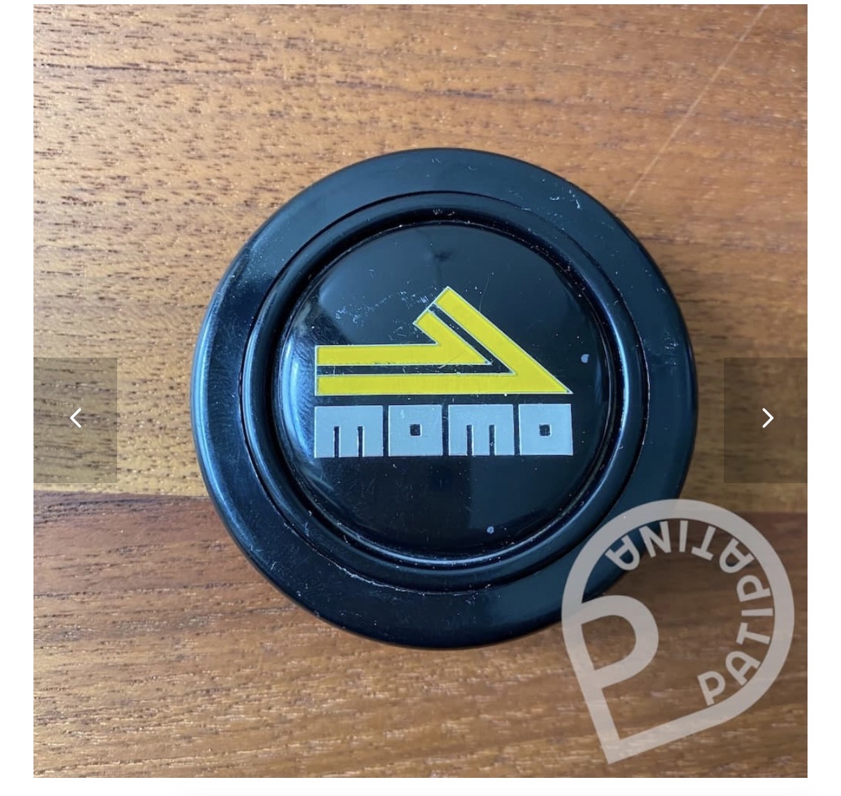

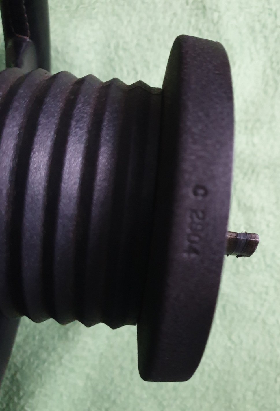

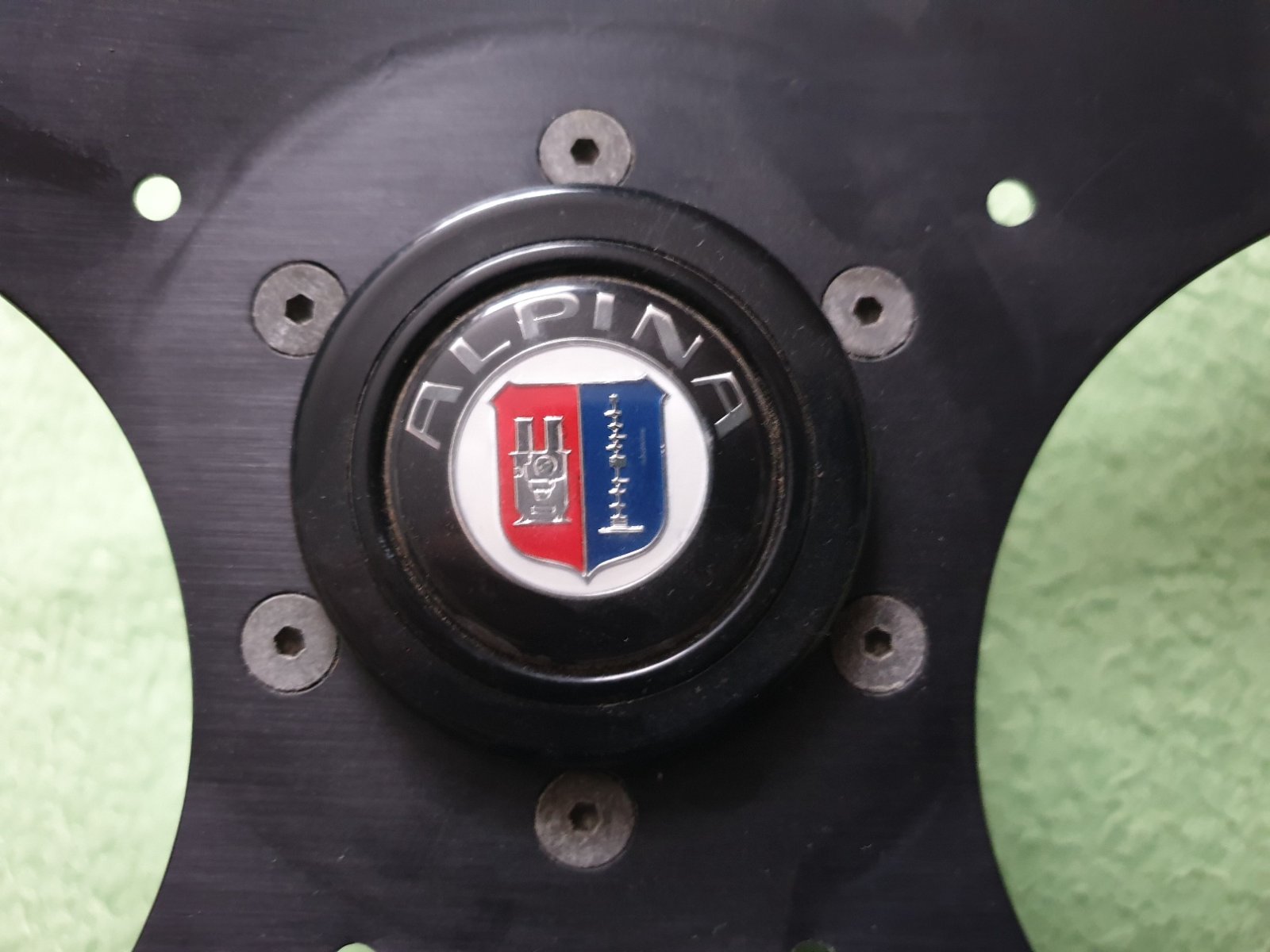

Than I got this four-spoke with horn button with black ring and a C2004 hub:

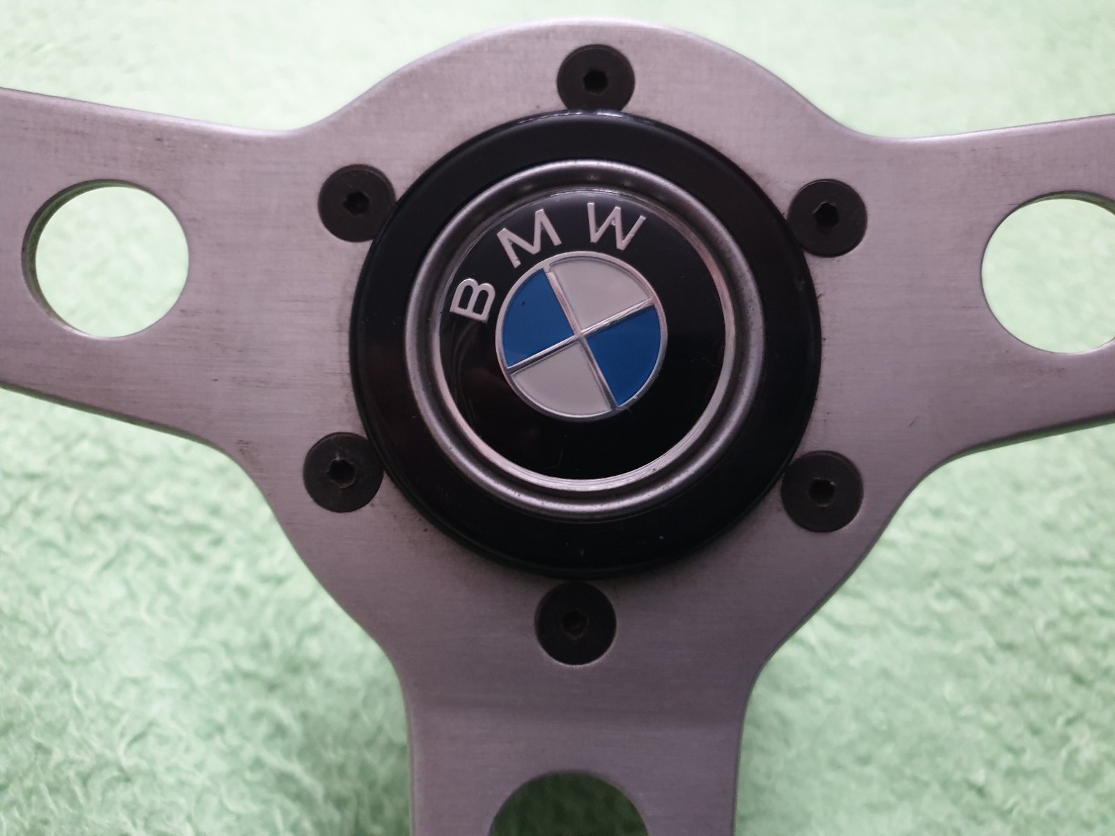

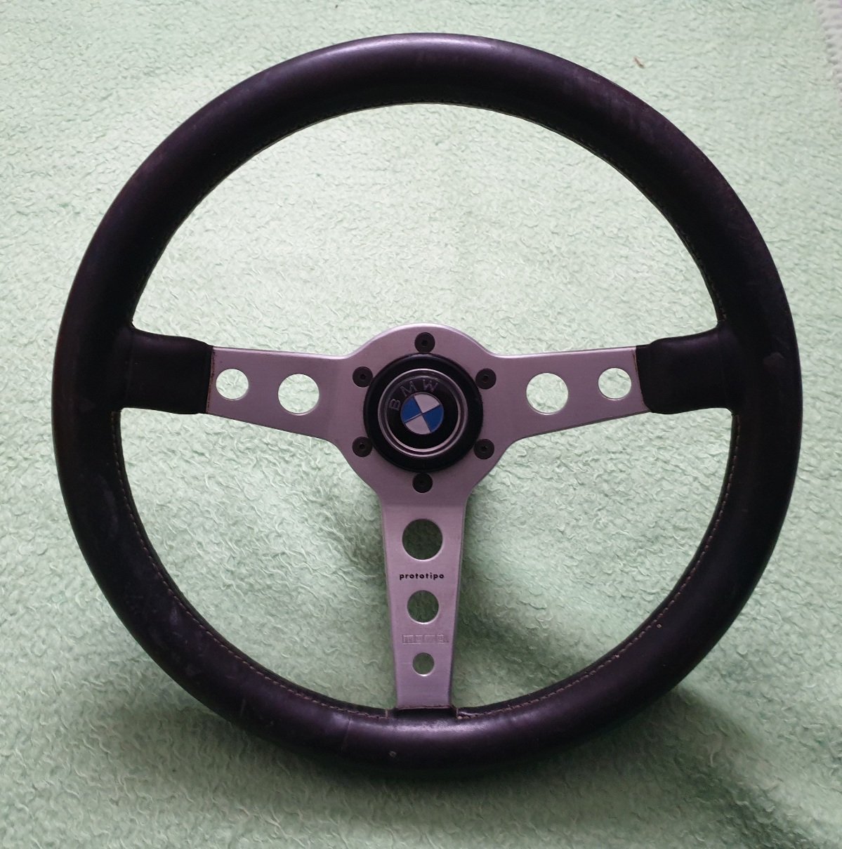

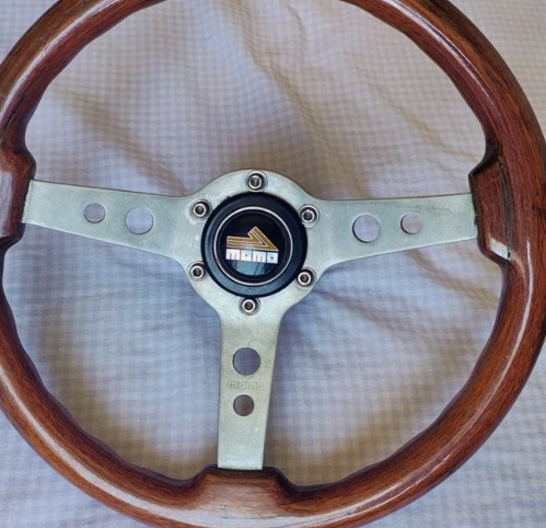

And I have a 350mm Prototipo with a BMW horn button with silver ring and a 152 hub:
Now I ask myself, which parts would be the best combination for the 380mm Alpina Prototipo?
I tend to use the Alpina horn button with silver ring as I think this version is the period correct while the buttons with black ring were released later?
For the hub, the 152 should be the correct one, but I am uncertain if I could value the genuine appearance of the solid hub in case of an accident, so I am tending to use the S153 154 155.
What would you recommend?
Thanks a lot in advance and kind regards, Dan

Period correct would be the silver ring buttons, either the Alpina or BMW. BMW never used the alpina button, even when mated to a Alpina wheel. It certainly wouldn’t look out of place though. The black ring Alpina buttons is either a reproduction or it has been modified. Check if the ring is plastic. Also snap a pic of the back. That early Alpina face would never been mated to a late 70’s+ horn button. The button body doesn’t look like a reproduction to me,
Hub;
The 152 is the right form factor but the horn won’t work. The 153 has a brass ring that mates to the brass plunger on the e9 steering column. Assuming it has a brass horn ring best option would be the early collapsible hub on the four spoke.

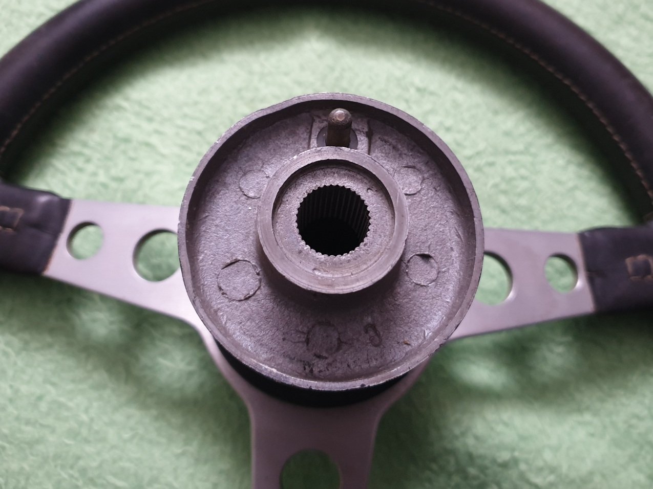

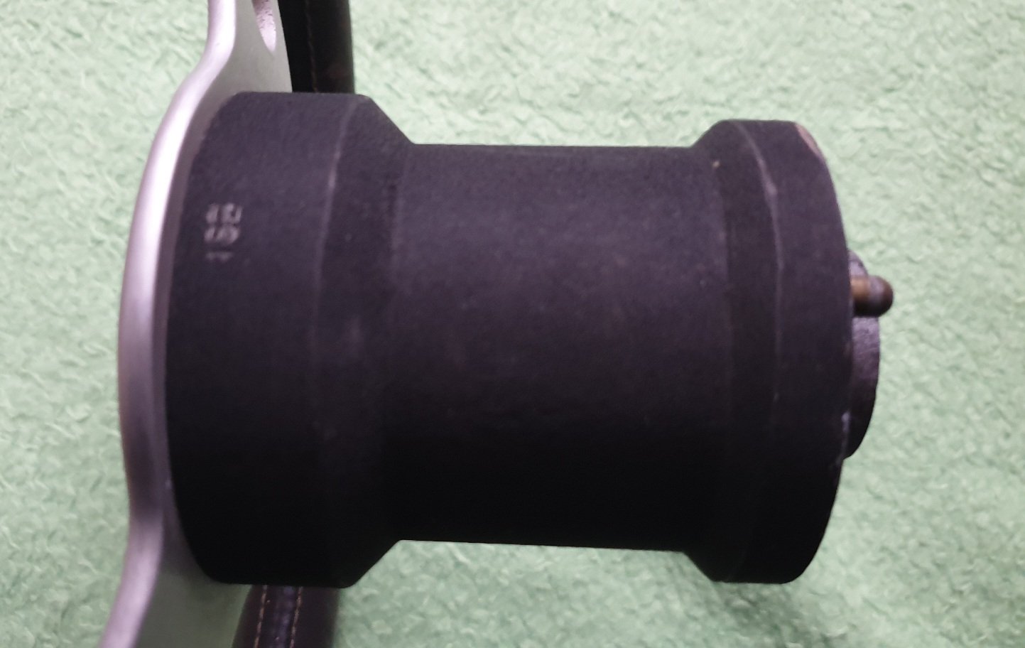

For the hub:

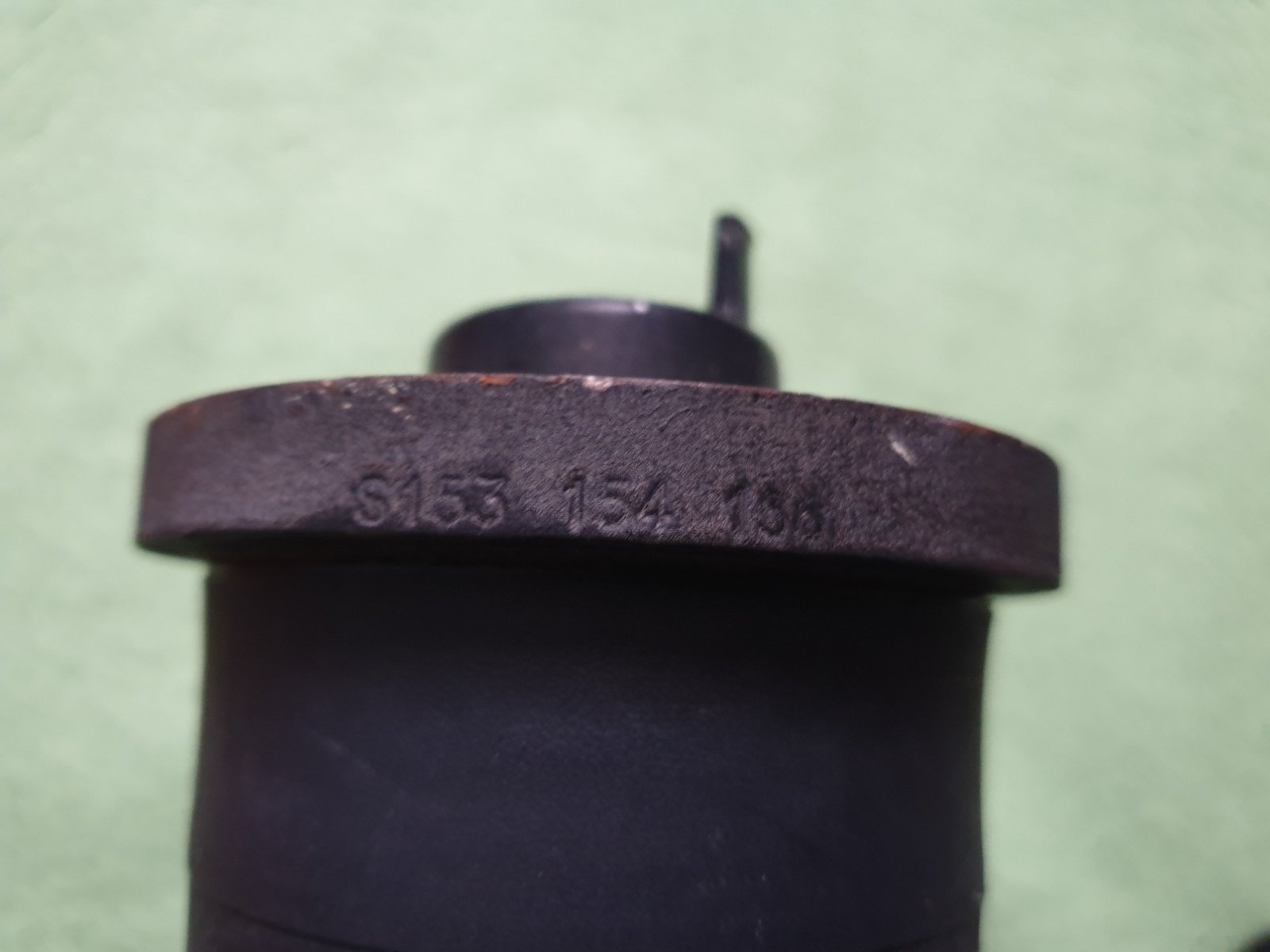

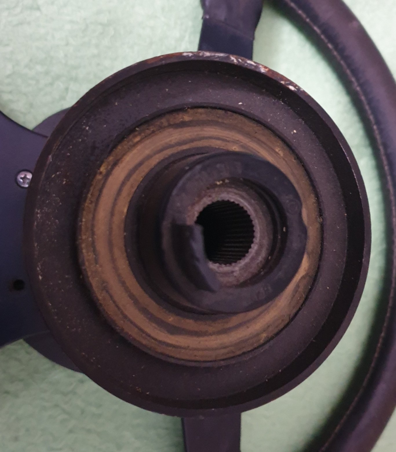

You are right, the 152 is without contact ring and has the pin - I assume it is from a 02 (would also align with the 350mm diameter)?
The other hubs do have the ring - here the S153 154 155:
I thought I may also be able to transfer the ring to the 152 hub - but I am probably too naive here?
I would be OK with sticking with the S153 154 155, as I do have an additional spare of these in my parts box :)
I need to assamble the wheel soon, I am quite excited to see it completed :)
Kind regards, Dan

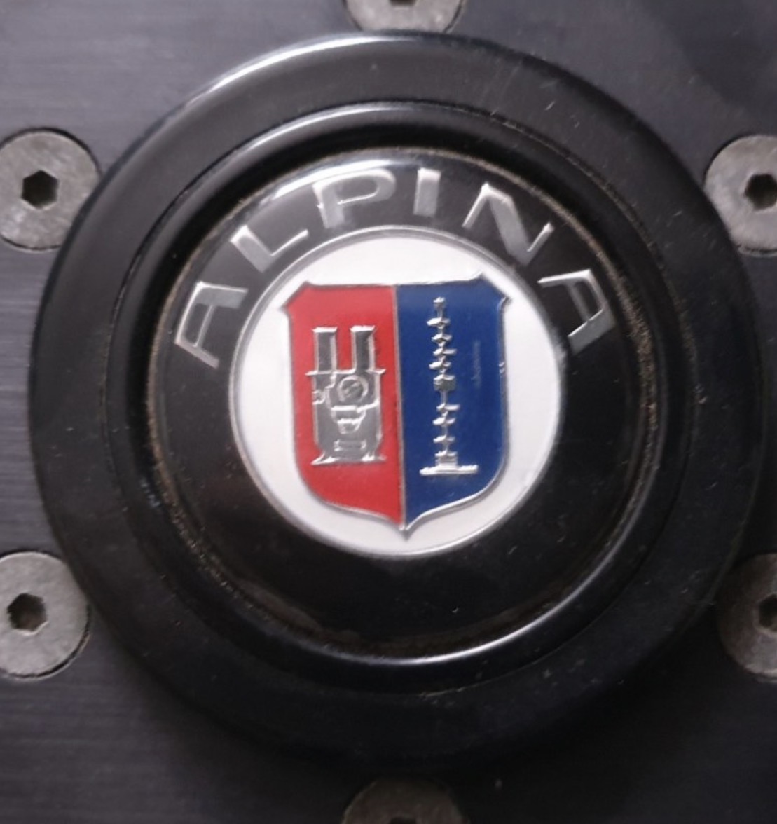

Horn Button:
Actually Markos all genuine Momo Alpina buttons new and old have the carburettor logo! Chrome ring momo buttons are the oldest, then still in the 70's was introduced the black rings but keeping the old gloss black housings, and the black ring and matte black housing is the newest design which you can still buy today from Momo or directly from Alpina. there are many subtle variations but those are the main design changes..
Dan, your nice old chrome ring Alpina button will look great with the new wheel. Thanks for sharing some pics it’s interesting to see.

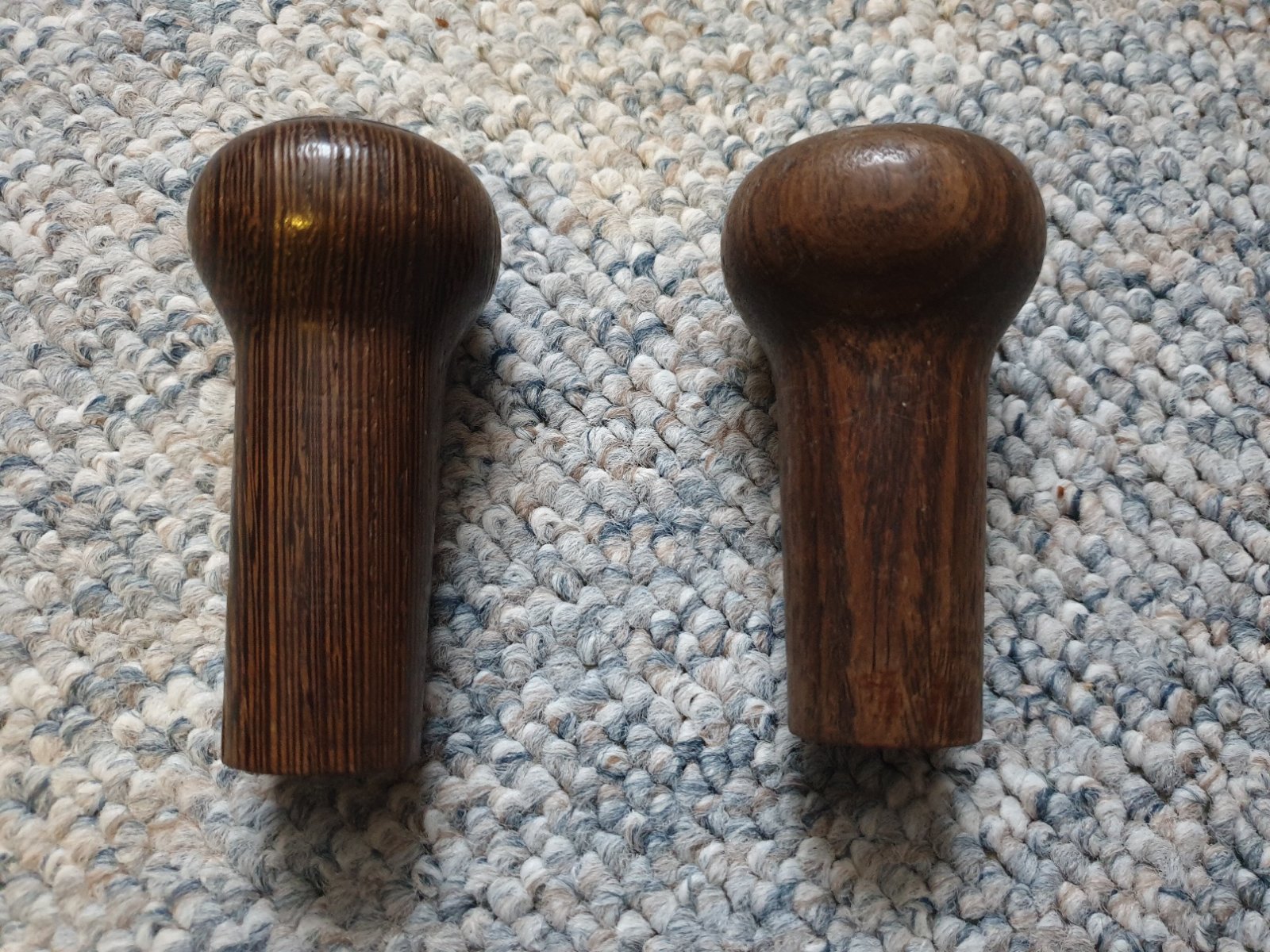

Anyways, most disappointing is that they present "the very first version of the Alpina shift knob from '68", screw on version, but displaying the ITB/crankshaft logo... And it a very exclusive wood. In reality, the wood was a very simple one and, of course, the logo was with carburetor and camshaft :) Will need to drop them an e-mail again :)
You are right @JamesE30 I never noticed! This is a heavily edited response to remove a boat load of misinformation that while accurate, simply does not apply to the momo button. The logo changed everywhere except the momo push buttons. It changed on all the shift knobs and steering wheels that didn’t use momo push buttons, but not momo. My apologies for doubting you!
The horn ring did turn to black between 1977 and 1978, but I’m sure there are longer living silver ring versions also. Silver ring buttons are most appropriate for an e9.

You likely can swap that plastic ring it should be the same dimension. The plastic setup is held on by friction only. You run the horn ring wire though the plunger hole. Just ensure you can get it seated properly. Also, confirm that your metal press-fit signal cancel lever isn’t stuck on your steering column. You only need one so the integrated plastic one will do.

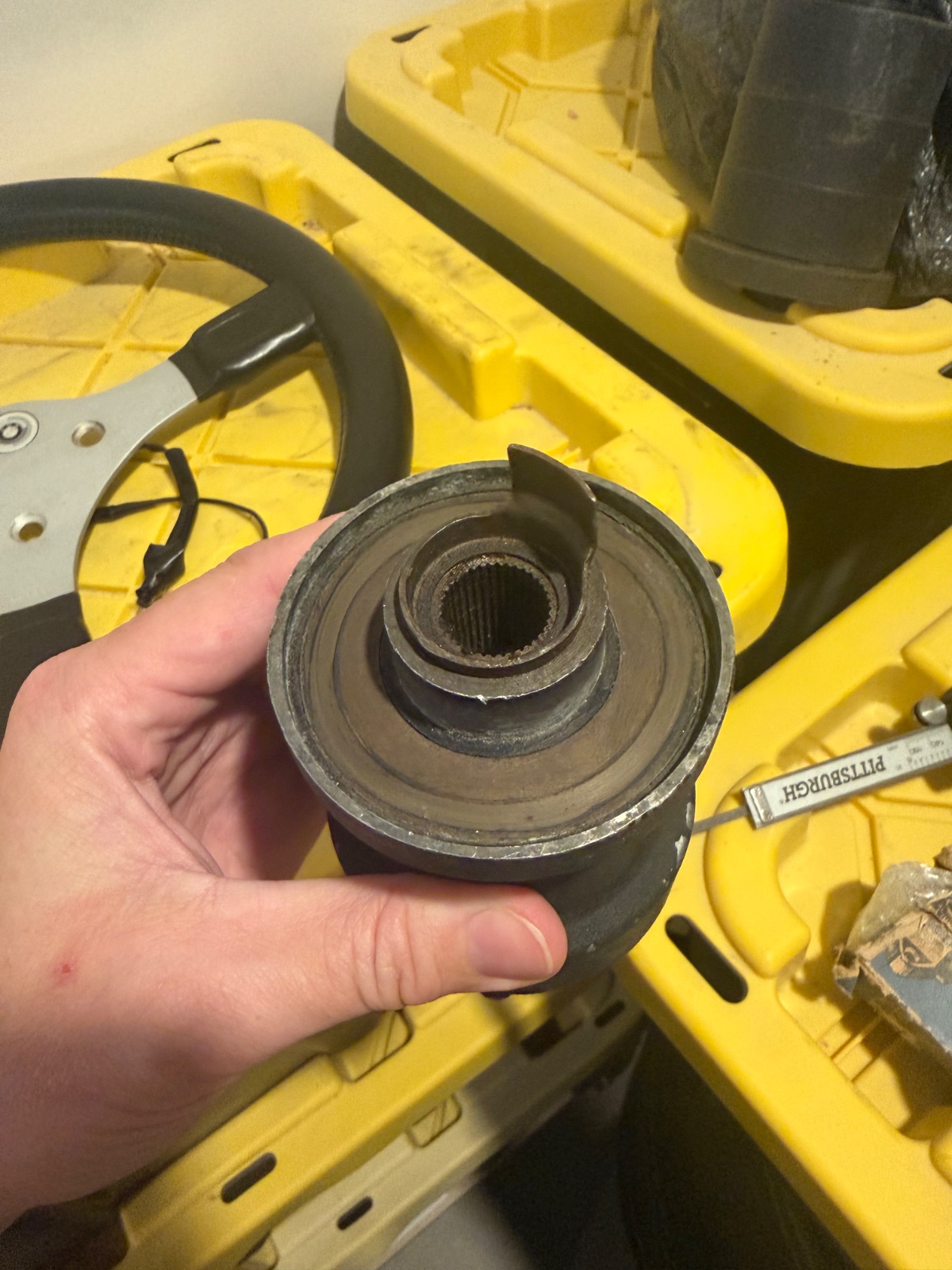

FWIW, That other hub is an collapsible from the late 70’s. It’s a nice period correct hub that is longer than the 152/153 by a decent amount. In fact it’s just a little longer than the CSL Petri hub. See which one you like better for driving. The collapsible hubs are a little safer in an accident.
All momo hubs have a compatible 70mm PCD that mounts the wheel to the hub. The early hubs have an integrated ring to catch the button. Later hubs with the accordion boot require a thin steel ring to secure the button. They are wider and fill the space better but not period correct if that matters to you.

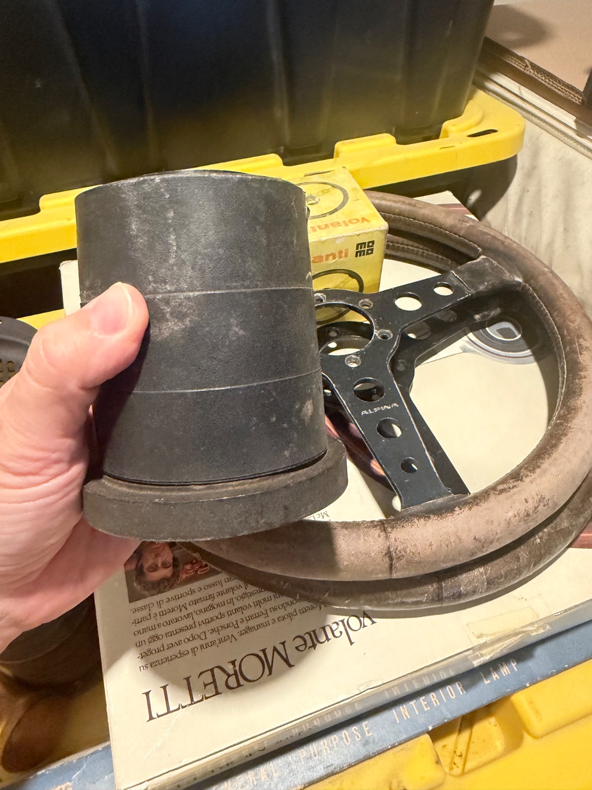

It’s difficult to see in this pic, but the early CSL’s has a momo Alpina wheel with a 153 hub.

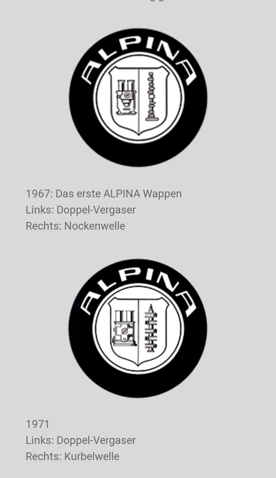

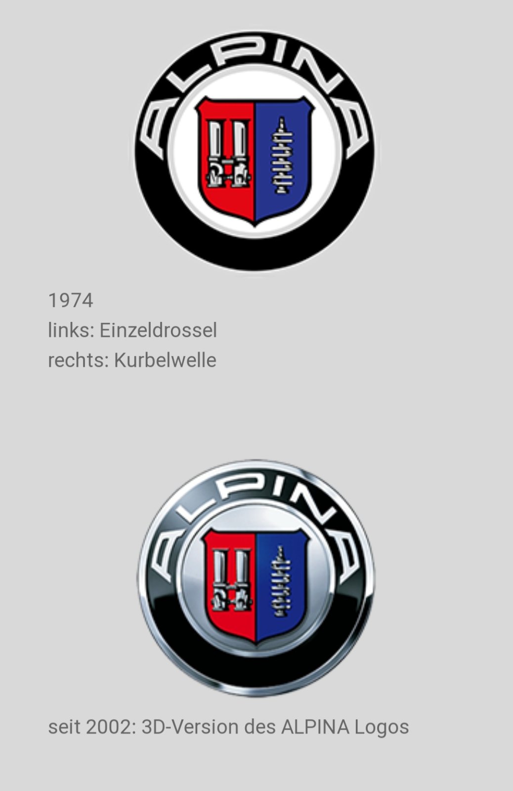

Meanwhile, I've also been able to locate my screenshots from the old Alpina homepage (excuse the German language):
So it already switched in '71, I remembered wrong... And then in '74 the switch to throttle body.

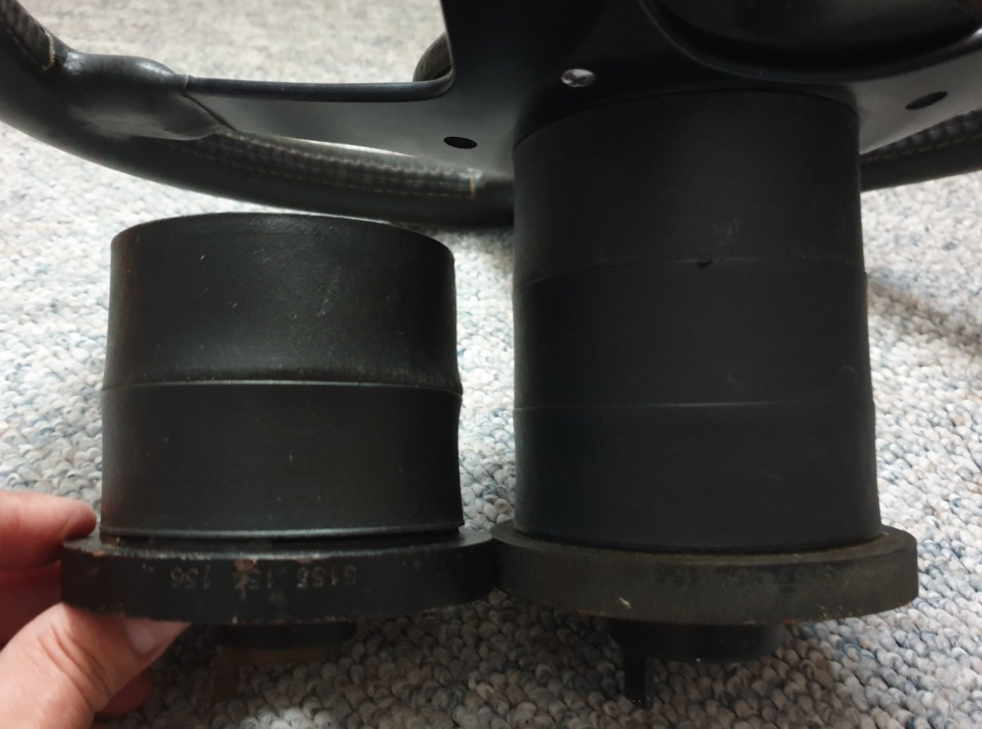

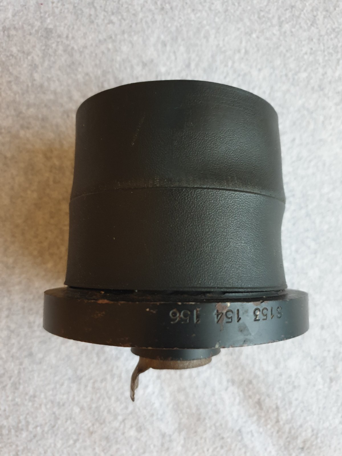

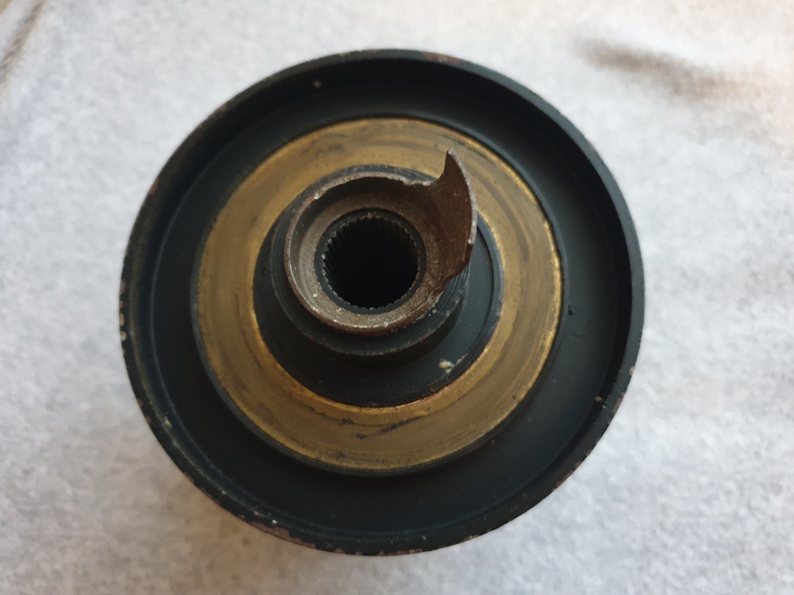

As mentioned, I do have another S153 154 156 hub, but I think it is a later version?:
Great - thank you so much for the excelent information, Marcos and James! I already read the previous version of the posting and now the updated one. Helps a lot and is highly appreciated!
I’m curious about that hub. I thought it was the same as mine but mine isn’t numbered. I can’t tell but it looks a bit shorter, so disregard my comments about hub length.
That stand alone horn ring would be the best to pillage for the 152 if you go that route. You can see the signal cancel lever on that hub. It just pops off.
This is my old collapsible:
This is what the horn ring looks like on the 153. It’s a tiny hub and the ring barely fits in there.

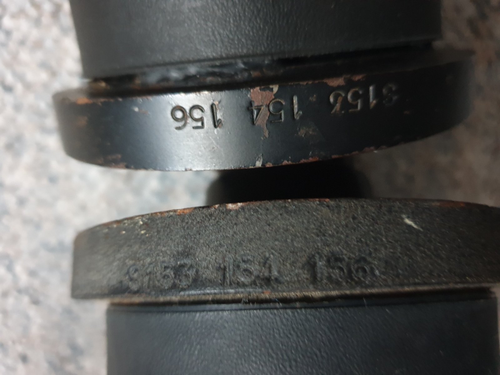

Now look at that - your first impression was probably correct, Markos!
While carrying the same number, there seem to be two versions of the hub:
I will need to test fit the different hubs and check the seating position, as you also suggested.

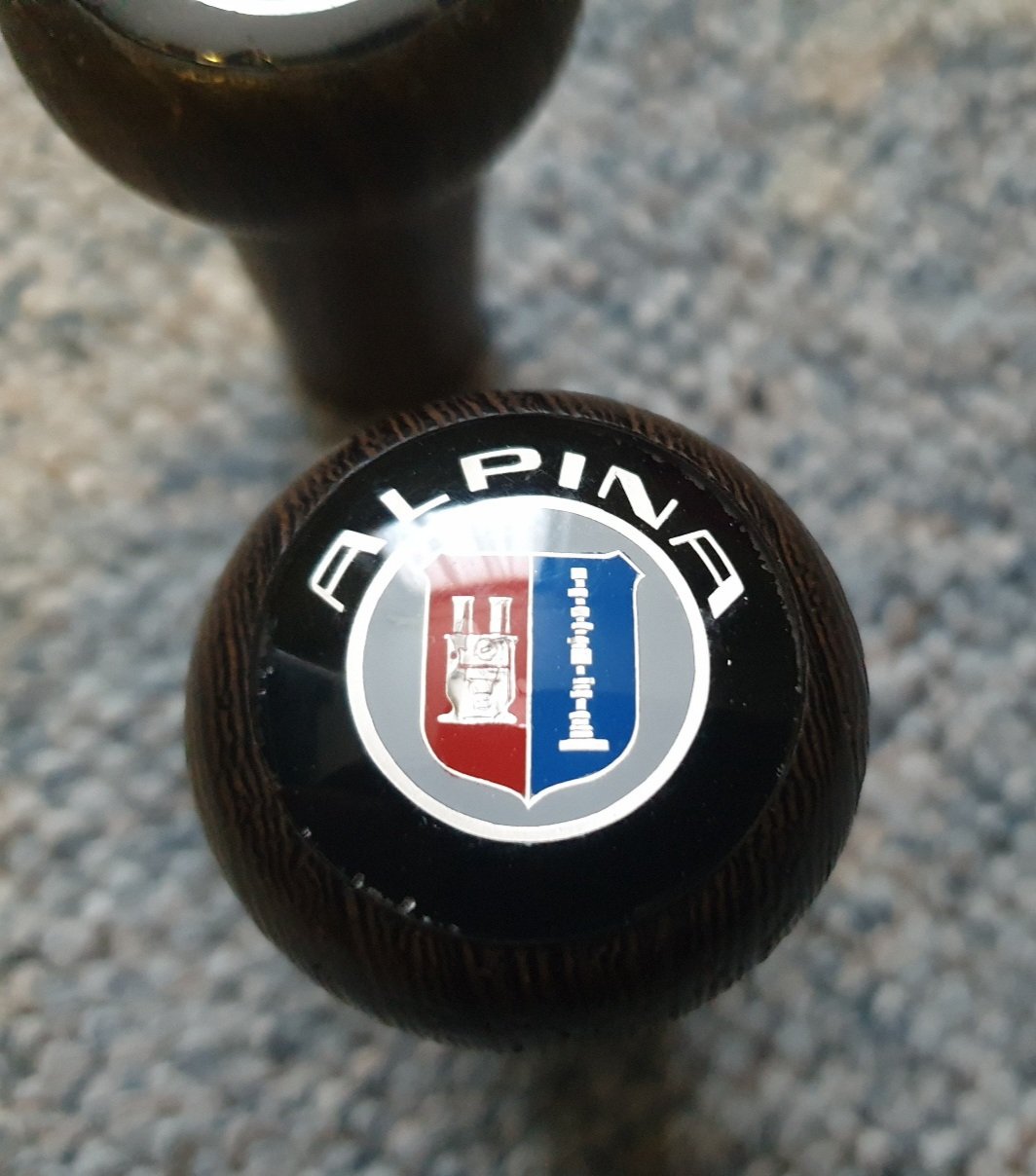

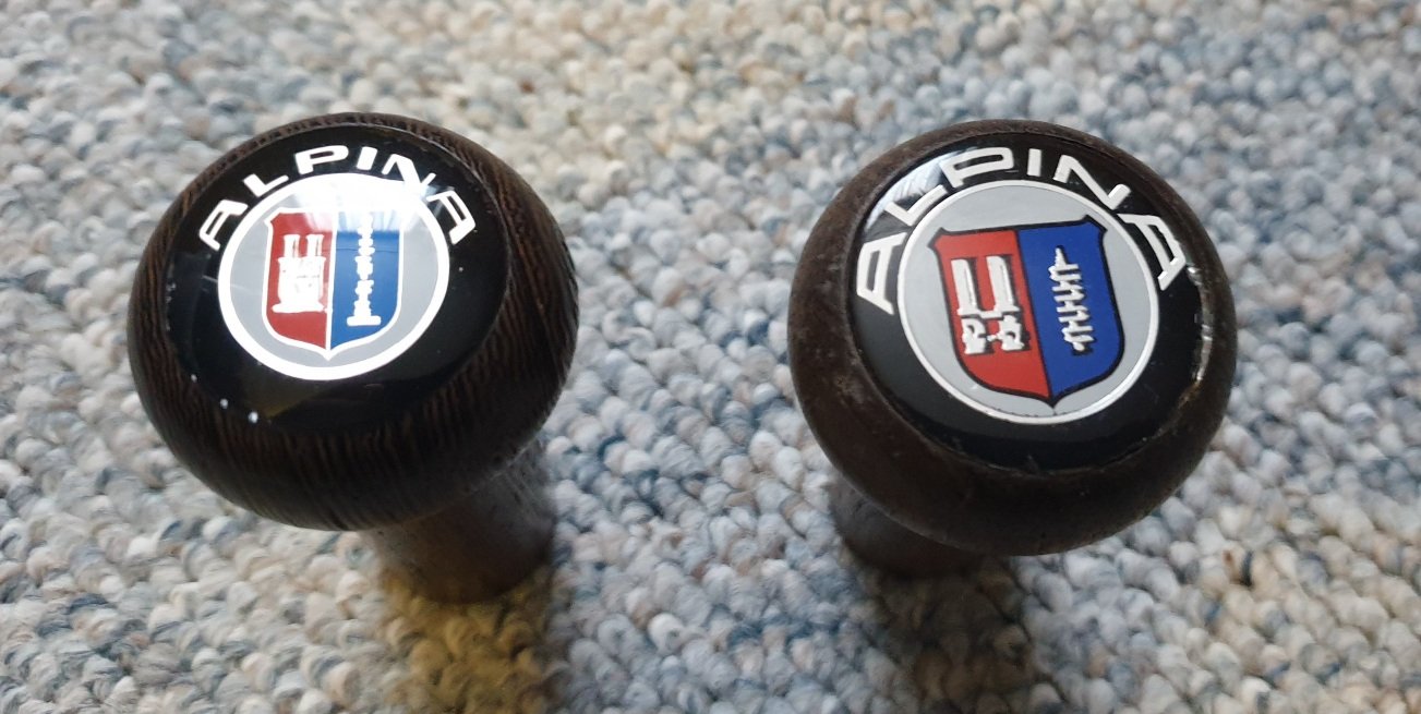

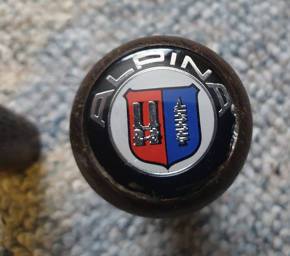

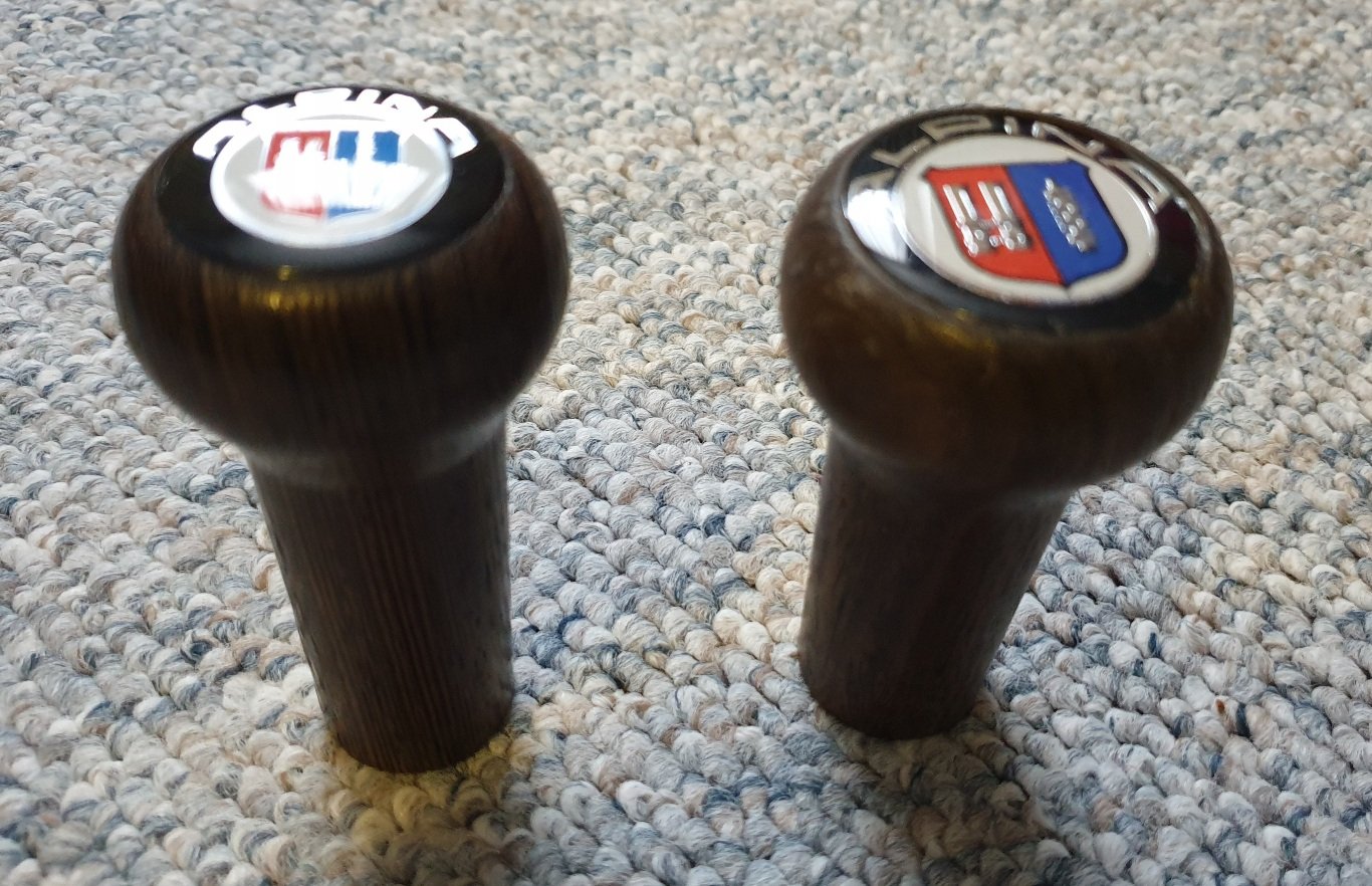

I've also located my Alpina gear knobs with the different Alpina logos:
Unfortunately, I miss one of the era between 71 and 74 displaying carburettor and crankshaft - if there are any. Does anyone own one and has a picture to share?
Ahh there we go. I regained some sanity. They are all good period options so you are in great shape. Post the “after” pics!
