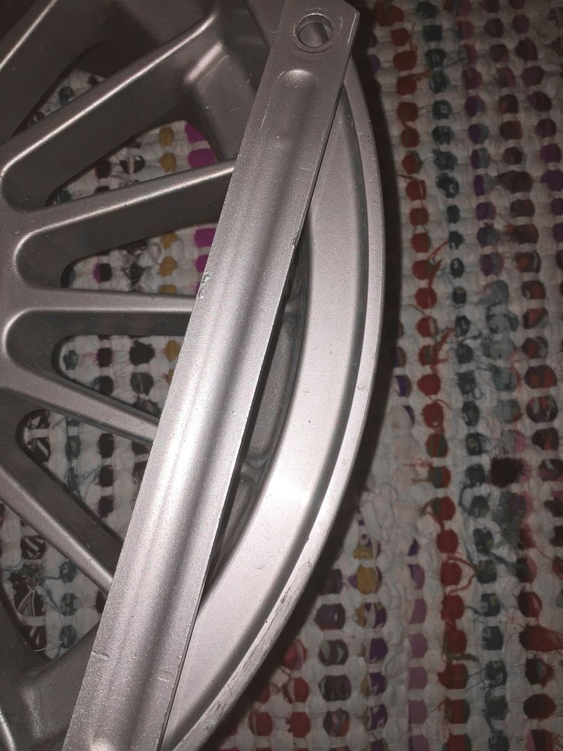

Old thread, but maybe somebody has refinished their Alpinas recently and knows a good paint code for a close match to the original Alpina wheel color?
I'm having a paint shop refinish my 16" wheels, so any information would be greatly appreciated!

I understand that BMW Polaris is the colour used by Alpina
Thank you, earlier today when I read your post I thought that it just can't be that easy, and I was almost sure that the Alpina wheel is a bit darker than Polaris.
But I had to check as I have a lot of small pieces just painted in Polaris, and to my surprise the color match is very close!
So I think I will go with Polaris on the wheels if nobody else has any other ideas/suggestions?
Cheers,
I checked with Alpina a couple of years ago when I was redoing mine. They claimed to have no record of what paint code they used. I wound up using Polaris with a satin clearcoat. They've worked well.
Thank you all for confirming that Polaris is normal to put on Alpinas, I left them off at the shop today, big sigh when he saw all the spokes;)
