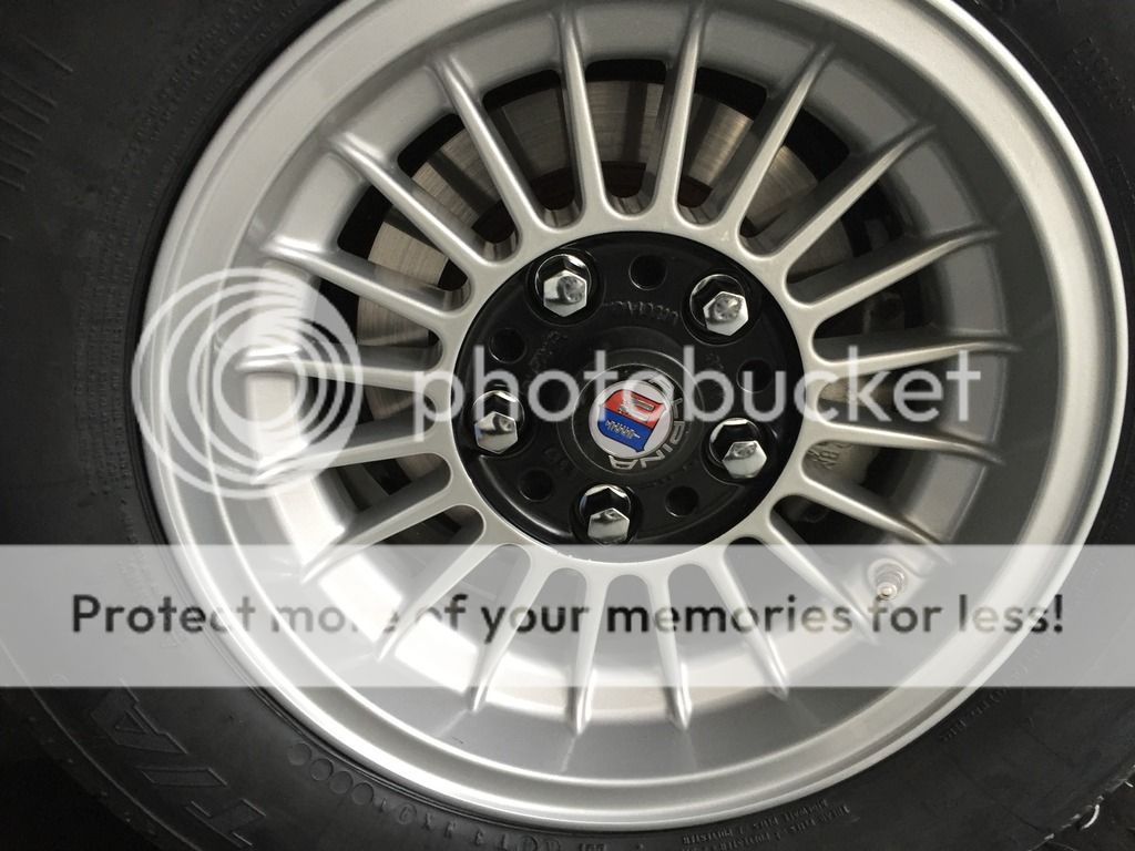

Hello
I have a set of 5 Alpina wheels from my CSI the numbers on them are 2800606 and 1110344 they are 7J X 14, the spare is immaculate and never been on the car comes complete with its original Michelin tyre which is new never used ! the other 4 are pretty good condition could benefit from a repaint but are perfectly usable as they are, no tyres on these 4.
What are they worth ??

Thanks a lot, How do I tell if they are genuine Alpinas or BMW ones ? the numbers on them are as listed does this denote who made them ? this is a picture of them on the car before removal and tyre scrapping if this helps ?
They are in fairly good condition for their age and would certainly refurbish to immaculate if needed, I could bring them to the UK in Dec and leave them there for collection in Lincolnshire if that would help anyone
Genuine Alpinas will have "Alpina" on the front face of the wheels and the makers name ( Ronal) and a conventional date stamp on the rear face. I am 99% sure your are not the real thing but the very nice BMW Alpina style.
Nice looking car BTW! Is it a late model with a 4350**** chassis/VIN number. Unusual to see the electric mirrors on the e9! I suggest you may have the wipers arms on the wrong side. They came from the factory with the spoiler on the left hand side!
Dont you just love OCD
Again thanks for the info, mine do have ALPINA cast in the alloy on the front , not sure about the date stamp in the back (I will have to clean one up to check) strangely enough just been out and checked the new spare one and although identical pattern it's got BMW cast I'm the front rather than ALPINA and it's a 6 j not a 7 j like the others! I know for certain these were supplied new with the car in late 1976 to the first owner in Hong Kong .
