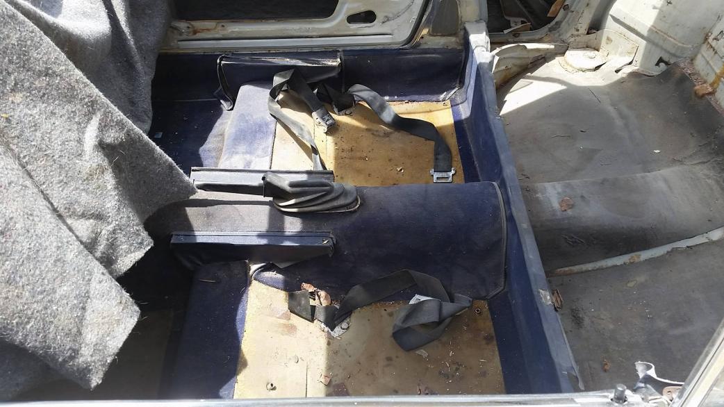

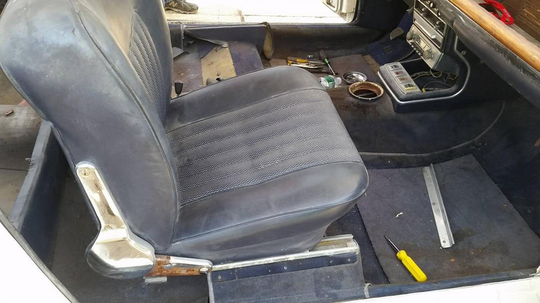

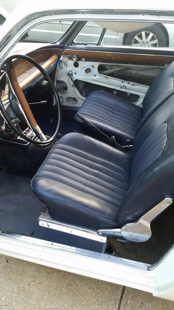

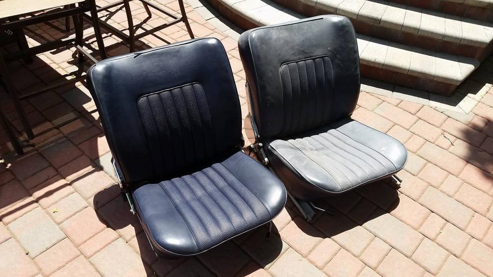

Back in high school I sent my 2000CS to a body shop for some minor rust repair and a paint job. There was some minor rust around the front fender and rocker, but other than that it was a good solid car. Through a series of misadventures and general d-baggery that I won't go into in full detail (unless you boys and girls would like that?), I just got it back two days ago. I also just graduated college. When the project was started it was a pretty nice car, but 4 years of neglect and 2 - 4 different body shops with varying degrees of professionalism changed that. Either way, when it came back it needed a serious bath. I'm going to try and document the process of putting it back together here, but for now the only pictures I have are a few steps from cleaning the interior. More to come soon enough.
