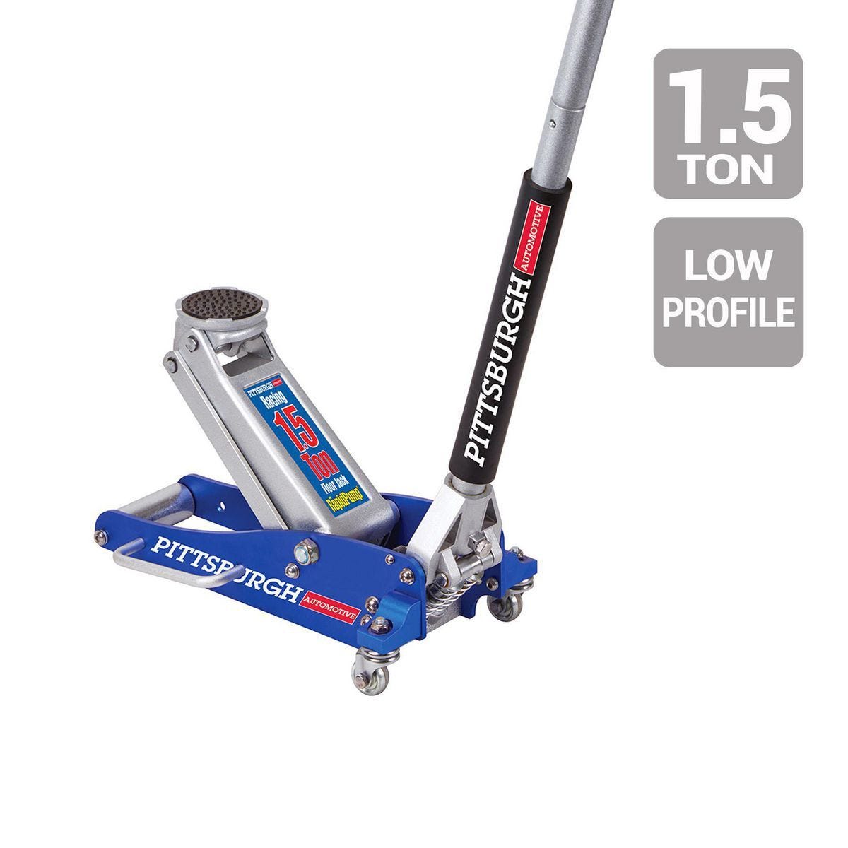

I carried HF aluminum 1.5 ton floor jack when I drove to The Vintage in NC in 2021. Handle comes apart easily and doesn’t take up much room.
On sale now: :)

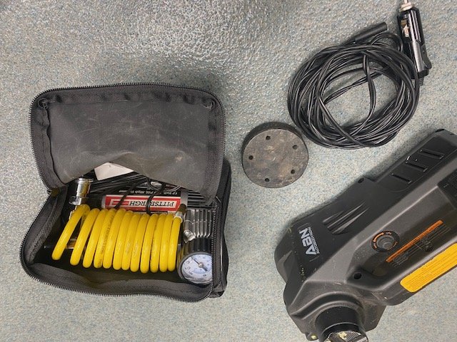

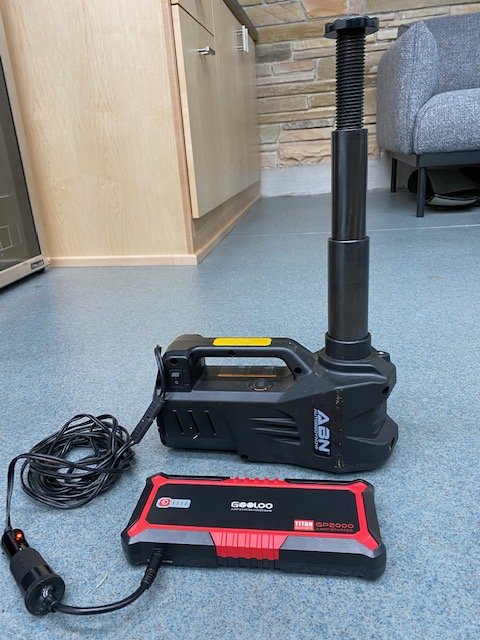

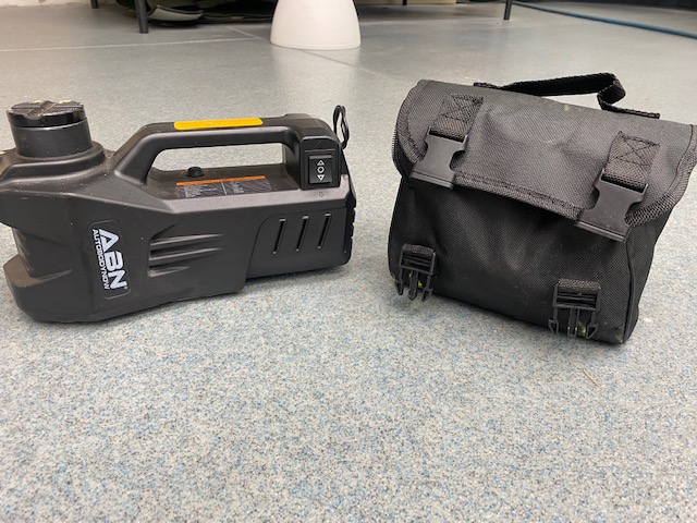

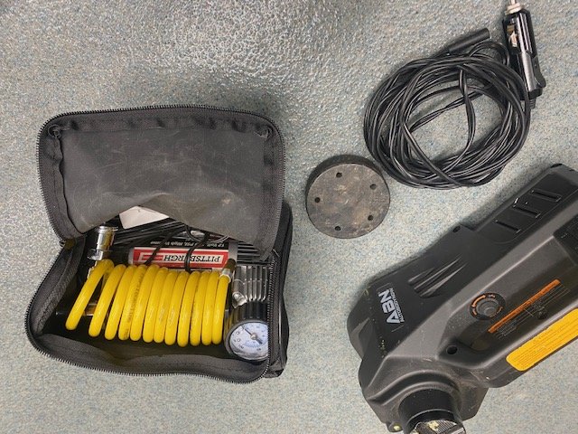

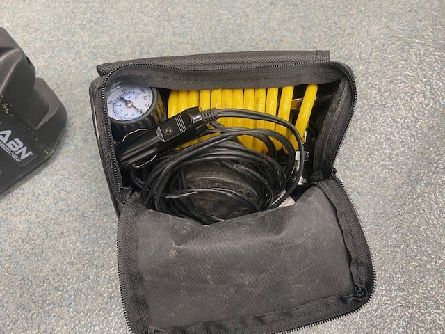

For longish trips and rally/tours I have been carrying this electric hydraulic jack. It fits under the spare and I keep the power cord and buffer hockey puck with the (surprisingly) capable HF tire inflator. They can be found all over the interwebs/Amazon. Some are too bulky to fit under the spare as they include an inflator and other doodads.
The jacks goes up to about 18" which is more than enough when placed under a frame rail for the front or the subframe arm attachment point for the rear. The underside of the jack is a metal plate which provides it all the stability I need. Very happy with it.
It sucks quite a few amps so I use it with the Li ion power pack/jumper/battery I also carry. Don't want to find out the cigarette lighter wiring is sketchy when dealing with a flat.
Edit: Added photo of the jack fully extended.
Very cool, will this fit under the frame rail or rear subframe mount when the tire is flat? I would cut the cigar lighter plug off and wire some alligator clamps to connect directly to the battery terminals.
Hi Steve, If it didn't fit, I'd go under the front subframe center or the differential. The jack is 6" high when fully collapsed. I also carry a short section of steel channel that hugs the frame rail consuming far less height than the puck.
BTW, I also carry one disassembled aluminum jack stand to not entirely trust the hydraulics for under-the-car repairs. They fit almost anywhere in the trunk when taken apart.

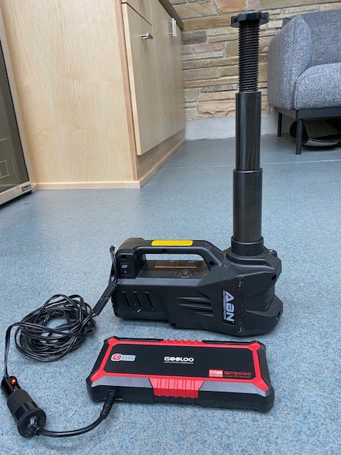

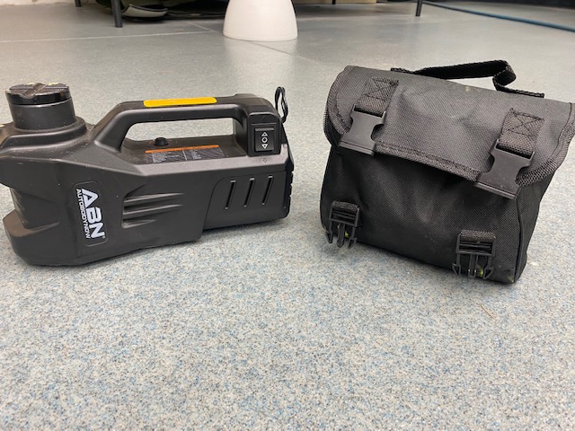

One of these:
View attachment 157672View attachment 157673
Very nice. That is the kind of setup I am looking for. I did look at that powered jack on Amazon but I did not pull the trigger because there seemed to be no way of activating it if your battery is dead. If only it had a manual bolt access as a backup I think it would be an near ideal option.
Of course, if you also carry a spare power pack, the odds of being completely out of power are pretty severely reduced
