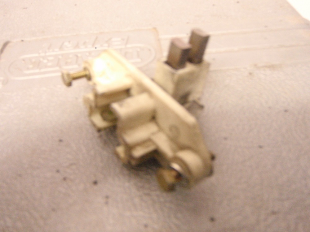

I removed the alternator from the car and then took the white plastic end cap off, this houses the spring loaded brushes. All looked fine and the resistance across the coil was approx. 1 ohm. All clean inside.

Does this brush set look correct to you? They extrude different lengths, one at 9mm, the other at 11mm, however that is enough to make contact, the springs also seem ok.
W&N have new brushes (coals) that look like they could be soldered into my white plastic end cap so I can try this, or can some one suggest where I can get brushes or an alternator repair in the UK?

While the brushes look worn, they also look like they have a fair amount of usable "meat" left. Different lengths after use is not very unusual. I would examine the yellow metal rotating contact area on the alternator to ensure things are clean and not particularly worn. It may even be that the alternator brushes are different lengths if the areas they "brushed" started out at different diameters. This might occur if someone else previously popped in a new set of brushes.

I think you are correct in that your brushes should be the same length. They are not expensive; I would solder in a new set and see if that does the trick.

But I disagree that the brushes should be changed. As lloyd wrote, the brushes do wear unevenly, and your's still have enough "meat" to work OK. I would go directly to checking the diodes.
