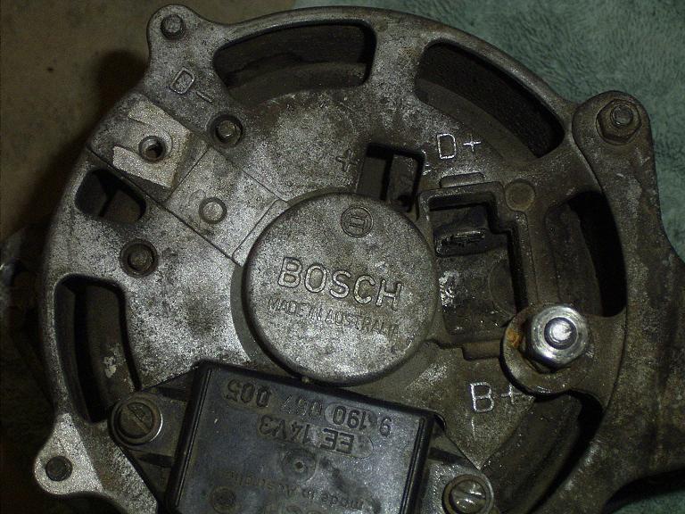

If you were using the older style externally regulated alternator, usual test is to jump the voltage regulator. You actually do have a regulator that you can replace that is incorporated within the module retaining the two carbon brushes. Like anything else electronic, it may be reliable, but I doubt it is 100% impervious to defects, external forces and forever lasting. I suppose a brush might stick, but I also suppose it/they might also be severely worn. Not particularly difficult to remove via two fasteners, but can be awkward to access with the alternator in place.

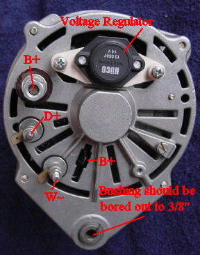

Another style (rectangular) "internal voltage regulator module."
