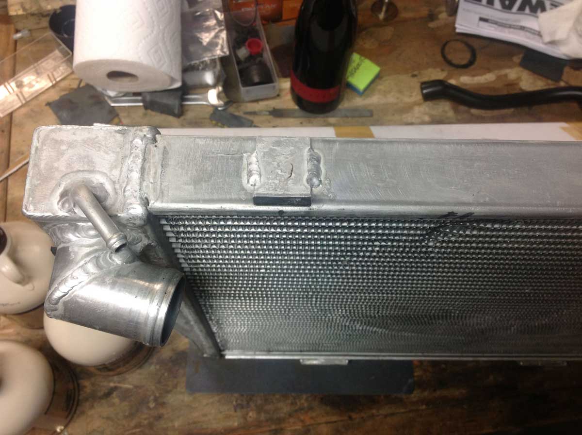

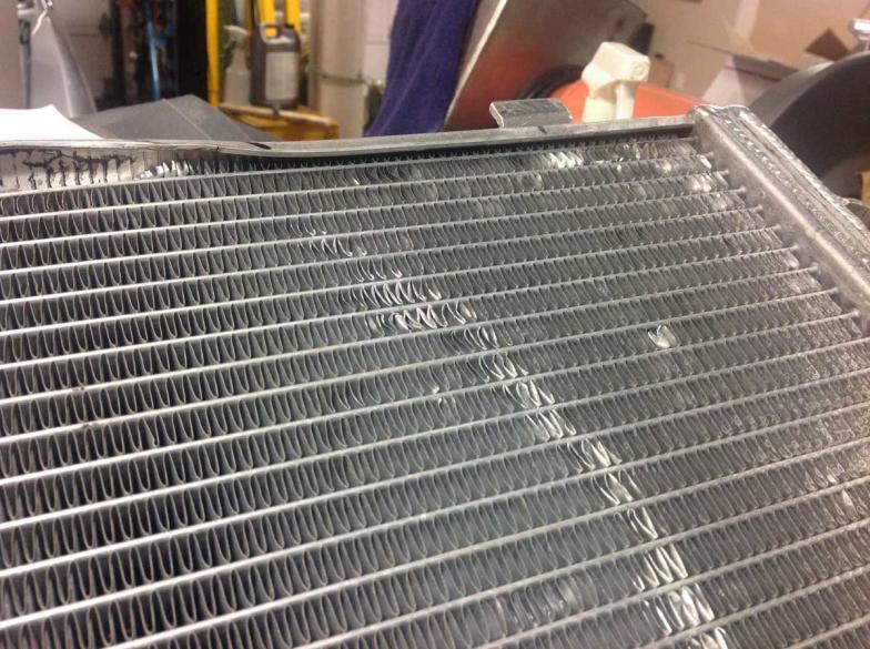

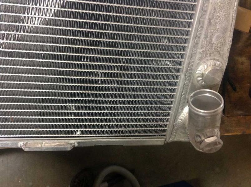

We tried to use one on a restoration I did recently. We ended up not being able to make it work. There were several problems for us:
1. The top "U" channel along the top of the radiator is wider than the core and reduces the clearance to the fan. The "U" channel was 1-5/8" wide. The legs also point downwards providing a nice place for the fan blade to hook on. See Rad3 photo.
2. The long angle piece mounted on top of the "U" bar was ugly. Its only purpose was for the two fan shroud attachment screws. We removed it and installed two short pieces. See Rad1 photo.

5. The bottom was too narrow for the lower support bracket so we had to weld on some tabs. See Rad2 photo.
So, if you have lots of clearance to the fan (or an electric fan) and are willing to make a few mods then the radiator is probably ok. Otherwise, proceed with caution.....

I have seen this radiator in a coupe about a month ago. The owner said he spent 3 hours modifying it so that it would fit. And the fit that I saw was substandard after he had gone to war with it. You need to add tabs to the bottom to make it viable. Then again, the ecartoy radiators a year ago were crummy as well. They sat too low.
