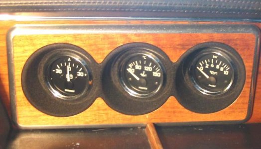

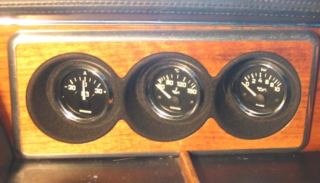

Doesn’t an amp meter require you to run all power thru it to other consumers?
The ammeter shunt is normally connected in series with the charging wire to the battery. It monitors the direction and amount of current flow from the battery into the electrical system. It normally reads a small current going to the battery as a trickle charge, but if the alternator fails to produce the current necessary to operate the various loads it will indicate that the battery is discharging.
Most modern cars use a voltmeter as it is a much simpler installation and less likely to cause a fire.
You can buy a voltmeter that plugs into the cigarette lighter you never use.

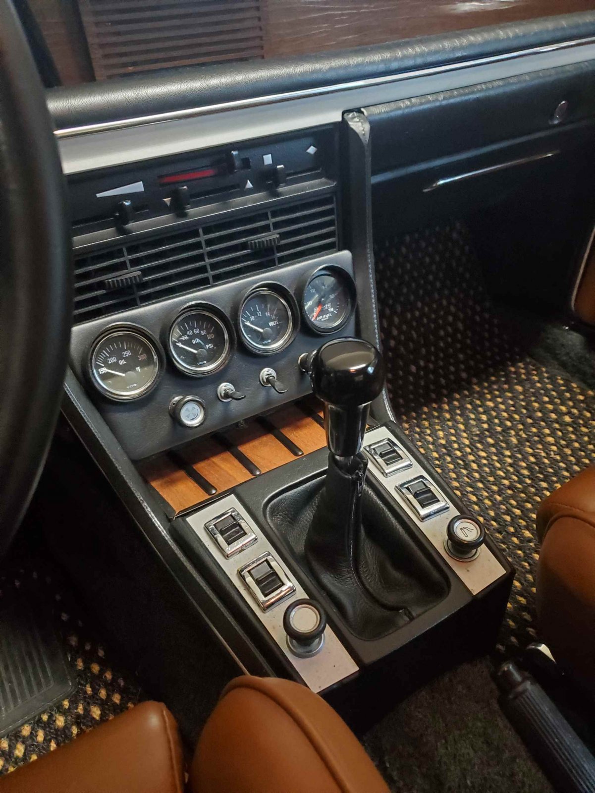

We already have VDO oil prz and temp gauge pods installed under the steering wheel. Was thinking of additional gauges (2) in the speaker area as many have done. I'm old school and just love analog gauges. Thus the thought of adding a voltmeter and something else. The amp meter was one candidate. Another under consideration is an outside ambient temperature gauge, similar to what some Porsche 356's had in the dash as an option. VDO does make one but its very expensive. There are cheaper Chinese gauges but look like junk. Living in FL, a temp gauge would be an indicator as to how well the AC is working. I suppose a water temp gauge with numbers could work by supplementing the un-numbered stock gauge.
Any other gauge candidates?

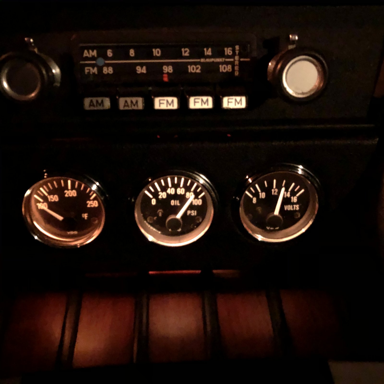

I have oil temp, oil pressure, voltage and afr. The temp gauges in our dash are very robust and, in my view, provide what you need for coolant temp. If you look into wiring in another temp sensor, you will find that the sender employed a VDO sender similar to the one already installed in our car. Thus, you are merely adding another display on the same, or very similar, information. As noted, oil temp is really only useful for monitoring when temps are sufficient to allow you to push. Otherwise, not that useful - I don't track my car, and our cars have so much oil in them that I never see elevated oils temps.

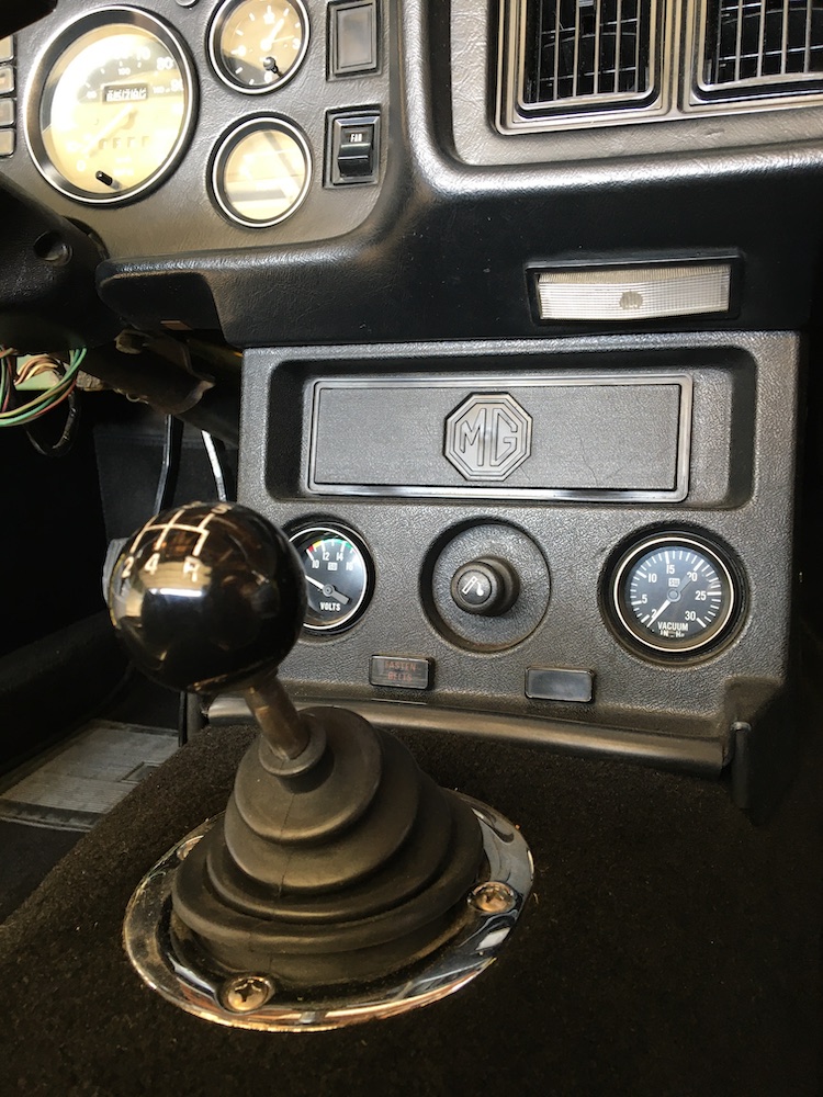

When I repurposed the heater air intake in the cowl under the windshield on my V8 MGB to become the cold air intake for the carb, the heater went away and I needed to fill the heater control holes with something. I chose an SW voltmeter and vacuum gauge that match the other gauges.
I hardly ever look at them. The car is stock with an idiot light for the charging system which I think is satisfactory for most of us. If it ever turns on, diagnose and repair. Not the same for an oil pressure idiot light, although it is a nice to have an idiot light in conjunction with the gauge. The light will get your attention. The gauge going to zero may not :oops:. The vacuum gauge is pretty much useless (to me) also. I would know when the engine is not operating correctly without the gauge telling me. So, the extra gauges fill the holes nicely, but do little more.
