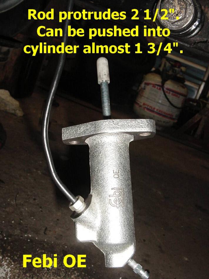

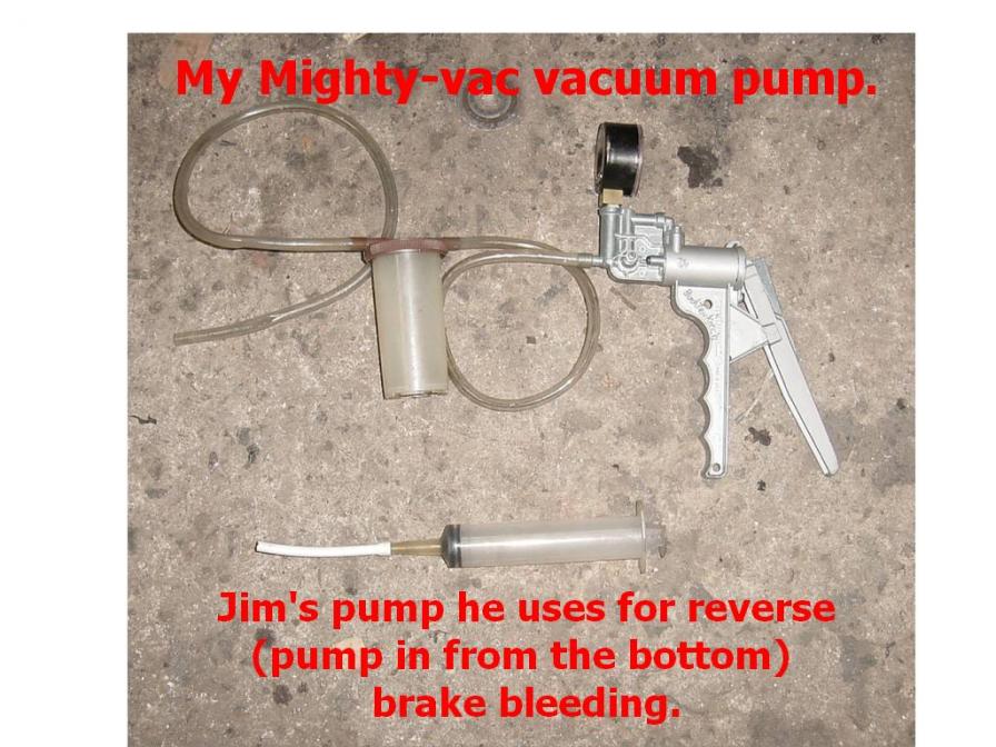

Used a Mighty-vac to bleed my brakes on Wednesday, they have a rock solid pedal. Got plates for the coupe on Friday and was getting pretty excited. Installed a freshly rebuilt clutch master today and tried to bleed the clutch without success. Tried a second clutch master and still no success. Jimmy Dee came over & reverse bleed the system, still no working clutch pedal. We pulled the clutch slave and determined that the actuation rod for the clutch is too short.

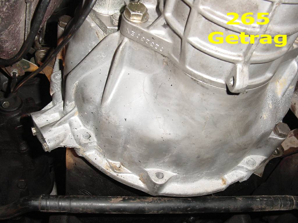

Tomorrow I’m going to work on lengthening the rod unless I hear a more sensible idea from the group ??? I believe the bell housing is motronic with the 2 sensors. Can’t remember what I ordered the clutch slave for but it’s new & bolts right on. Thank you for any advice, I thought I would be going for a test drive in a day or so but now find my back against the wall once again
