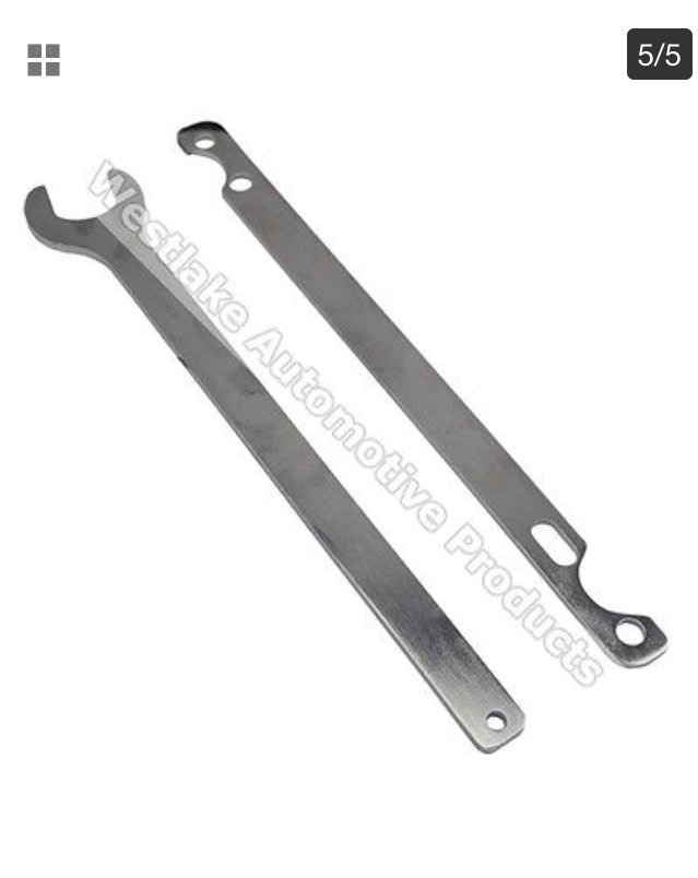

Try this tool for easier removal. Seems corny but was a life saver this past weekend when I installed and pulled the fan and pulley a few times. I tried to attach the link but it keeps resetting. Amazon seems to have it for the cheapest price; search for BMW 32mm Fan Clutch Water Pump Nut removal tool.

when i changed one on my e28 533i, 15 years ago, i used a bicycle crank wrench - very thin, strong and long enough. might not be as cheap as what amazon has ... but back then it was the best option ... especially if you have friends who are serious bike guys.
Found a cheaper one on eBay and hoping the link works from my phone...
https://www.ebay.com/i/122227699347?chn=ps&dispItem=1&ul_ref=http%3A%2F%2Frover.ebay.com%2Frover%2F1%2F711-117182-37290-0%2F2%3Fmpre%3Dhttps%253A%252F%252Fwww.ebay.com%252Fi%252F122227699347%253Fchn%253Dps%2526dispItem%253D1%26itemid%3D122227699347%26targetid%3D364127856121%26device%3Dm%26adtype%3Dpla%26googleloc%3D1023039%26poi%3D%26campaignid%3D936424496%26adgroupid%3D44875990057%26rlsatarget%3Dpla-364127856121%26abcId%3D1129646%26merchantid%3D113781723%26gclid%3DEAIaIQobChMIueH9-qnE1gIVybjACh0hbwWDEAQYAiABEgKfbfD_BwE%26srcrot%3D711-117182-37290-0%26rvr_id%3D1320600903636
Hmm i bought a set from UUC and it seems i overpayed. Well maybe not as i bought the single wrench and sent me both. Nice quality though as I believe they make their own.

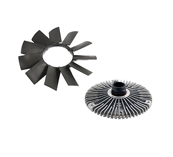

The so-called one-bolt spin on fan clutch is probably the most popular choice, but consider that there were also a few fan variants that bolted to the viscous clutch. All of the variants have worked well for me, although the thin, more-flexible blades found on the later models seem to move more air than their predecessors. If you are still unclear about the different pumps and clutches and fans, it might be prudent to acquire all three items as a complete assembly. If your cooling system is clean, i.e., well maintained and free-flowing, any version of the viscous fan clutch should be adequate for most needs. Consider that the original five blade assembly served well for decades.
Newer style fan
Older style fan
Auto-cz%C4%99%C5%9Bci-420mm-radiator-cooling-font-b-fan-b-font-blade-dla-font-b-bmw-b.jpg
Note three rather than four fasteners that attach fan to fan clutch.

The photos help tremendously. I think my ignorance of the parts is what stopped me from understanding. Thanks a bunch for your time.
I changed the fan clutch (spin-0n) on my '83 533i once. It was seized REALLY BADLY. I ended up taking off the water pump with fan attached, then destroyed the water pump trying to keep it from spinning so I could unscrew the clutch. Ended up taking the mangled mess to a friendly indie. He put it in his 8" vise and slugged the crank down with all he had - and he was a large person. Then he put a craftsman 32mm wrench on the nut, picked up a sledge and said "stand back". He swung for the fences and on about the third slam, the clutch let loose.
So what? The moral of the story is to keep some anti-seize on the spin-on threads.
I use a bicycle wrench (from a bicycle store, natch) since it's a game I very seldom play. Put the wrench on, sticking straight up, remind self that it's left hand threaded, and whack it several times with a piece of 2x4. Works, as long as the anti-seize is doing its job. Some thoughtfully placed rags help when it lets go.
