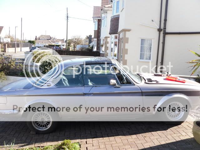

this is the better of the 2 roof has been taped as the sunroof is stuck open slightly.

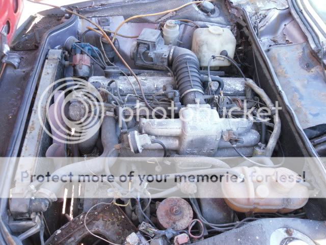

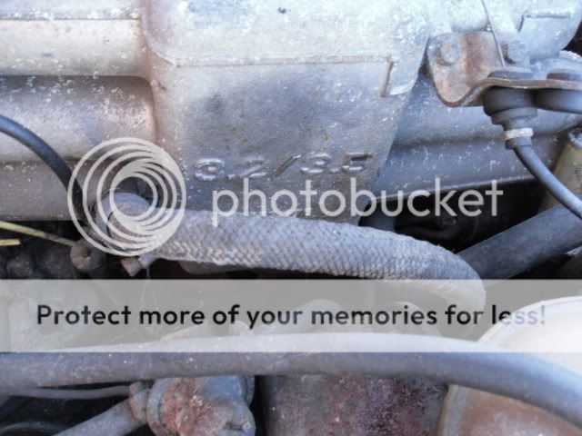

This is the engine the car is a 3.0 cs on the vin but the engine has 3.2/3.5 on the inlet manifold
Any ideas if this is the correct engine?

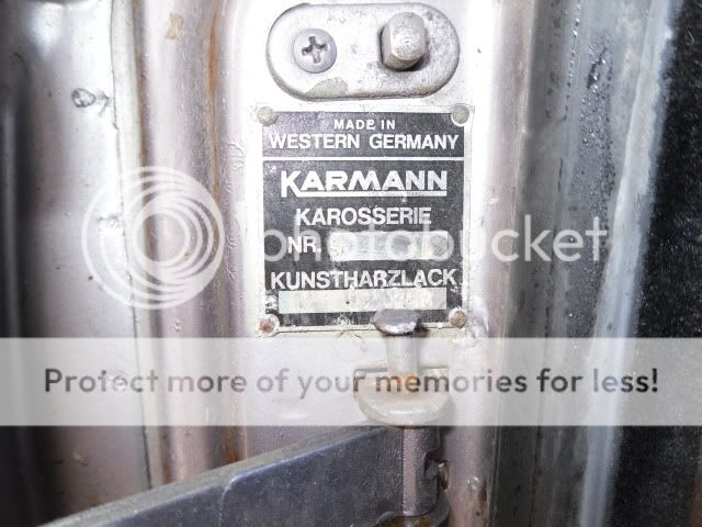

Last question should this have any numbers stamped on it? its on the A pillar by the door

If your coupe is a CS, it originally had carburetors. CSi coupes are Bosch D-jet fuel injected, so the engine (or the FI system) is not the original in your coupe.The FI system in your car is L-jet, I'm fairly sure, used on later (1980s) BMWs.
The Karmann label should be stamped with a paint code number in the "kunstharzlack" section. The label appears to be original (riveted) so I'm at a loss to explain why it isn't stamped.

Hello Lee. Good to have another UK chap join. I reckon that engine's from an 80s E24 but I'm sure other's will chime in. What's the other car like?
