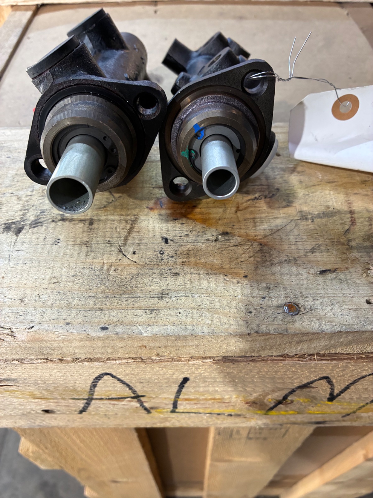

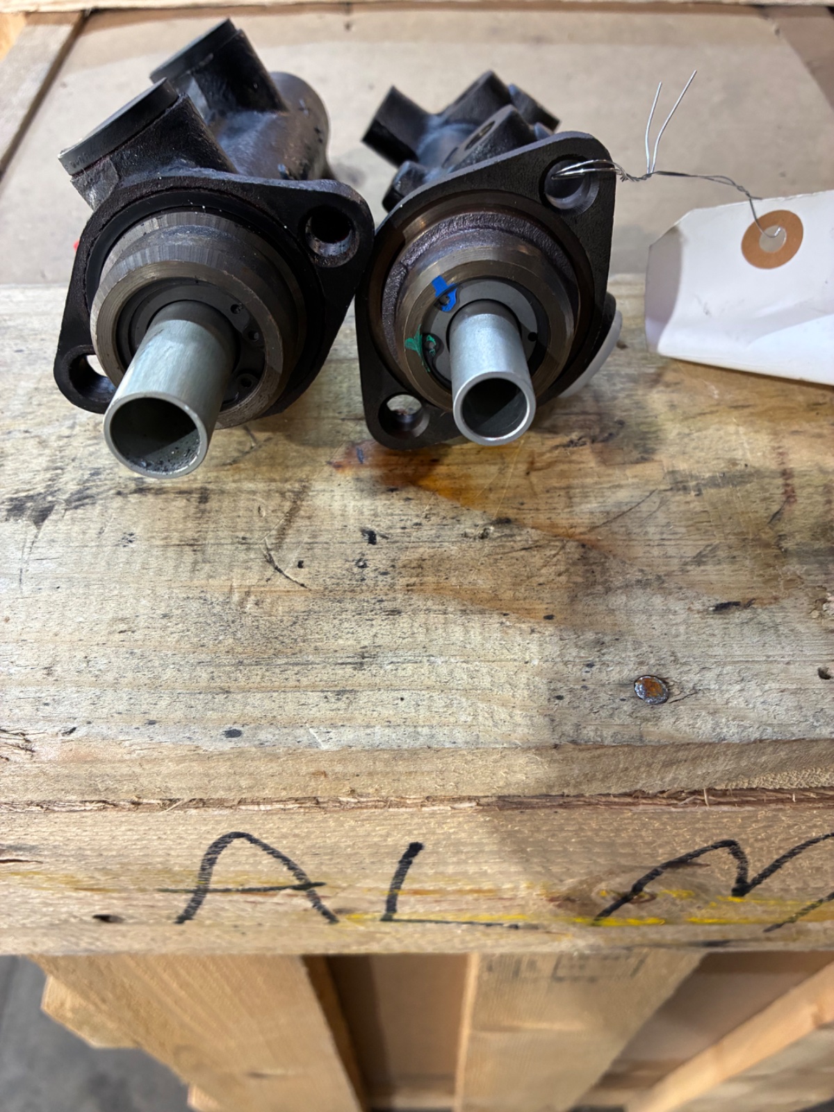

Keep in mind, master cylinders come in 2 sizes

Brake masters are 200 bucks

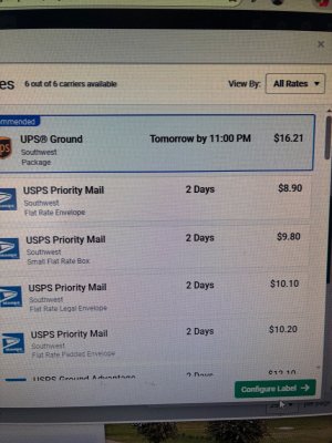

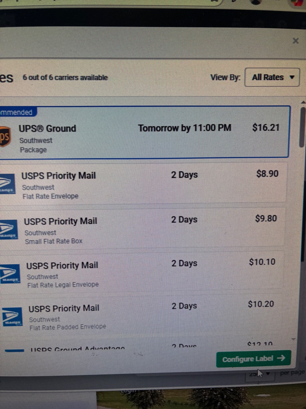

Brake booster rebuild is 200 bucks
Shipping on UPS 16 bucks
