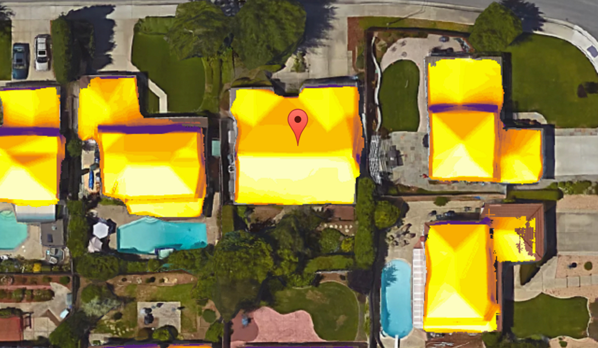

Given that I am getting a new roof I looked into. Project sunroof told me it wasn’t worth it. My neighbor is a director at the electrical company and has a big array on his roof. He installed about 3 years ago when the incentives were better.
Funny, I used that webpage for my house. Their average monthly cost said I'd save $13k over 20 years. When I put in what my average cost really is it changed to $48k over 20 years. Not sure if that adjusts estimated energy costs over time.
Thanks for sharing the website @Markos. Calculation on my roof says I will save $1,000 over 20 years…i do lover the tree coverage in the summer, but for solar not so helpful.

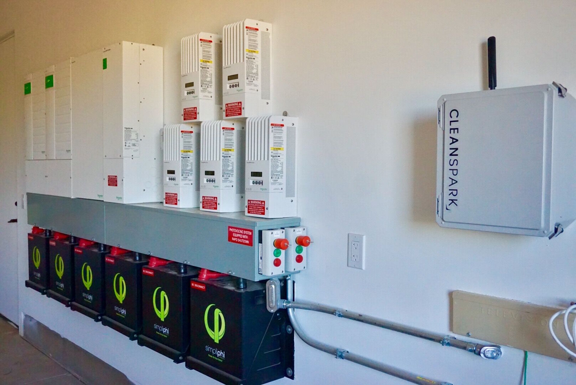

I installed solar on our previous house in LA about 10 years ago. When we moved to the bay area, I also installed a Tesla system with two Powerwall batteries. The way it works is the panels power the house first and then charge the batteries. When the sun goes down the batteries take over. So, as long as there is enough sun to fully charge the batteries we are completely off grid. It is only if there is not enough sun to feed the house that the system switches to the grid.
If the batteries are fully charged and the sun is still feeding the panels, the power gets fed back to the grid. But there is a false sense of satisfaction there because of the power company sells you electricity at about $.20 per kilowatt but, they only give you $.07 per kilowatt for everything you sent back to the grid.
I’ve never looked at it as a money making or saving proposition. I’ve done it mostly for environmental reasons as well as for energy independence, which is much needed where we live because of frequent power outages.
PS: it’s probably obvious, but when the main power grid goes down, this system automatically switches to island mode and continues powering the house as if nothing had happened. It is completely transparent to the end-user.

Having a system that can operate as if off grid, requires specific equipment.
Especially the converters, not all can run in island mode. Most conversters are made for domestic use, and use the 50 hz signal from the grid to generate their own frequency, basically 'fitting' their electrons nicely between the others.
(Which isn't how it works in physics, but for understanding it's a nice analogy)
If the grid quits, these converter quit as well. Second reason is safety; if the grid goes out, parts of a house would still be live, but you wouldn't know where/which.
So, Dang in your case ask specifically for a system that can operate in island mode. It would require dedicated wires to your ac setup.
But I would advice you to install it so that you have the option to switch from island to grid connected at your desire.
