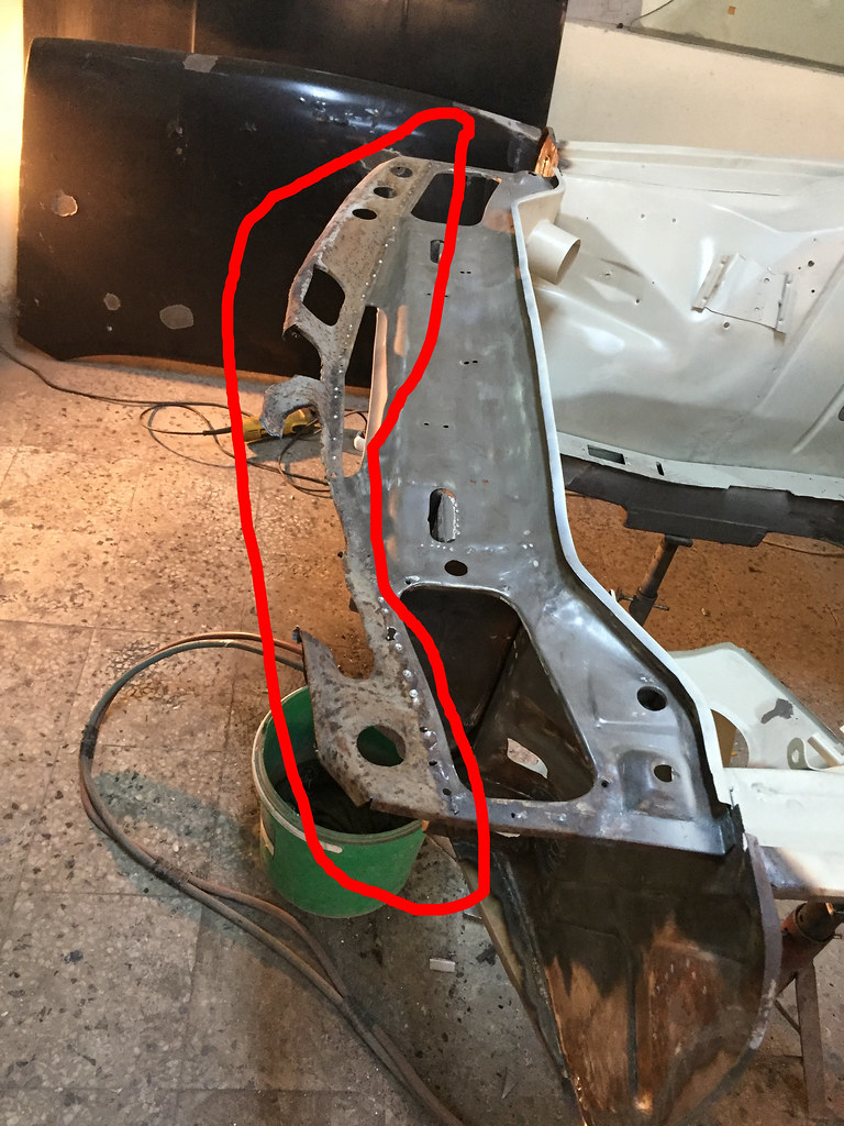

Anyone have a decent photo of this piece?

i think you need to stick your hand through the missing grill and point your phone camera towards the underside of the nose. The part that he is missing isn’t visible from up top.
The grills are off my spare nose so I can snap pics (and take measurements) this weekend if needed.

As Markos pointed out I am trying to figure out how the rotten part should look
I can copy the right corner to the left side but is there any openings in the middle of it? under where the emblem is
Thank You Markos, you are right I am trying to understand what the middle of that piece looks like.

what i did make/take from oem/metal front,also the lower part,what is circled in red, you needed
but mine is nothing cut ,only a littele bit deformed and rust
i did today rust pasta/remover and after few days i removed,the plastik,where i did sealed the rustpasta and can make pictures for you

Hi Michel
Are you in the process of making a chin part out of fiberglass? did I get that correct?
I got the pictures I needed so thanks but I don't need pictures anymore.
I also see that you make chin spoilers I will need one of those that can be fitted to wide fenders at some point.

indeed a make in time, a chin part of fiberglas for the front panel up and lower part,like oem 41331827339
i can make also the connectionplate 41131833023,but i self needed up and lower part whit te kidneys
wide body parts or spoilers i can make severals
