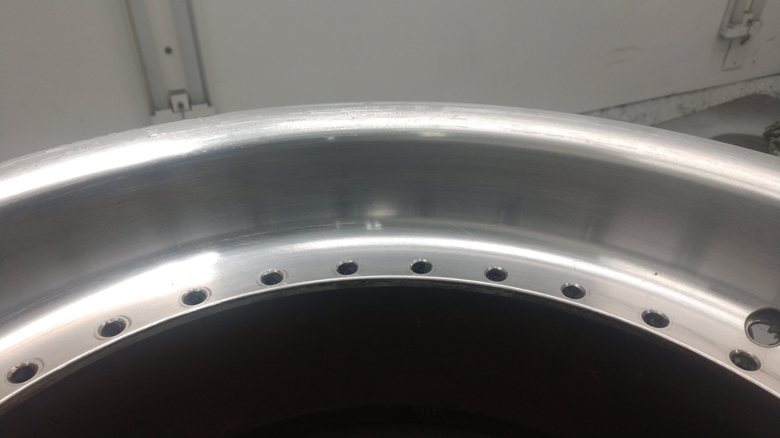

I'm starting to polish my Style 5 wheels and would like to coat them with a clear coat or maybe a clear powder coat. I have an extra wheel so I'm going to do some test areas with different sanding grit to see how the clear coat covers but don't know how to prep for clear powder coat. I can call a shop but thought I'd ask here first. All I know for sure is I don't want to polish my wheels every six months.

Yes, with clear coat you typically go around 1000g sand paper when clearing over existing paint, like clearing a painted panel next to a new panel. When I do headlights I use the same method and it works awesome. Polished aluminum? No idea. The only way to know is to test multiple areas on my extra wheel and see what happens.
This is after removing the factory clear with no sanding/polishing, etc.
