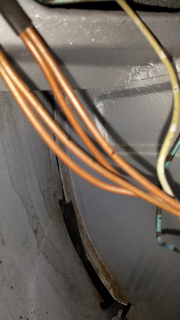

I can get 2 of these seals (they go between the radiator support and the left and right front fenders).
access
make um peter from rubber stock
cut a tire tube glue em on
or use a window weatherstrip
I agree 100% with #3 and #4. I’d use 3M fast & firm auto body caulking and a slightly wet balled up paper towel to schmooze it in there. I actually have my front fenders all sealed up with the same but I had to make stainless fillers for the top, the gap there just being too big. ~ John Buchtenkirch
