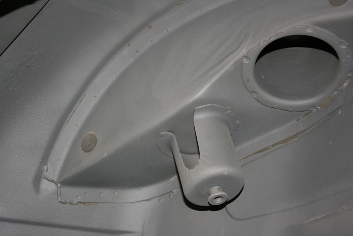

Are these drain holes???
teahead
aka "Rob"
6,536
1,934
Tacoma, WA, USA
Rear inner wheel well...I notice these plastic plugs.
Should they be plugged up or left open to allow water to drain???
my theory on all those odd round plugs, hold the sheet metal parts in a jig when they were welded together
They should remain plugged, otherwise water will get in. You could remove the plug and then spray in some cavity wax, plug and seal over the plug.
