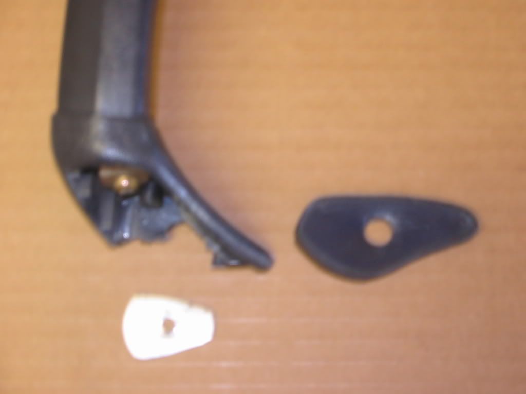

I have decided that my role on the e9 board is to suggest el cheapo fixes. Sure, buying a new door pull part from LaJolla Independent is the RIGHT way to fix this problem. But, here's another alternative (sorry for the blurry photo - guess I also have an el cheapo camera!):
I fixed my pulls years ago, by cutting down a fender washer to fit inside the triangular space inside the pull. Even if yours hasn't broken, it is a good idea to add one of these washers to spread the load.
To the right of the pull you can see the gasket that goes between the pull and the trim panel. It isn't quite flat - it has a ridge on the inner side. But, a flat piece of rubber would serve.

My "cap" is not nearly as bad as yours and I could probably fix it. However, I'm also missing the plastic gasket, so I may as well find the proper ones.
I'm all for "engineered solutions", but given the fact that these arms rests are front and center in your view all the time, I think I'll try to find new ones before putting my "fabrication hat" on.

Again, I'm all for doing things the "right" way. But, my fix doesn't show at all, once the chrome plastic cap is mounted.
Even with new plastic parts, it might be prudent to add a washer to beef it up. Clueless passengers have a way of grabbing the upper part of the armrest/door pull, and YANKING the door shut (hey, it's an old car - it must require a good slam).
