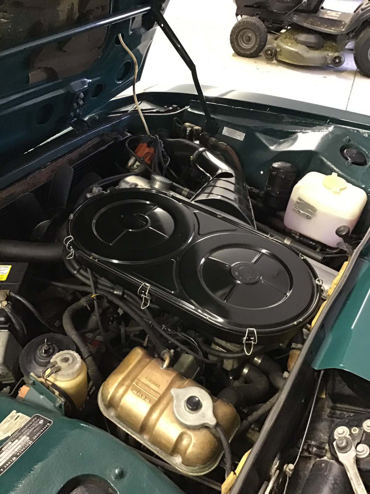

So I have the brass overflow tank and steel Markos bracket. Been looking at ways to solder, has anyone done this? I assume silver solder/flux/torch but is it that simple?

You will definitely need a torch. I would have one torch preheating the steel bracket, and another warming up the brass. The tank is going to heat up a lot faster than the bracket. Like pipe fitting, you will want a good flux paste (from a plumbing store or online - HD flux is awful). Use solid silver solder. You don’t heat the solder at all. You heat the metal and the solder gets sucked into the joint following the flux.

Silver solder is the way to go. Try and keep the of the tank, especially the seam, cold with a wet rag. If you heat the whole tank, it will just fall to pieces.
When you weld the bracket, its upside down and the big seam will just have the silver flow out of it onto the ground if it becomes warm.

This is the flux I use for pipe fitting. It is fantastic. I didn’t realize until snapping this pic that it is “The best flux in the world”. I bought it from a local commercial plumbing supply store, and they said it was the best. :D
