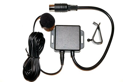

I have a period correct radio in the dash and will be keeping it. Also, when the car was in for the bare metal repaint (10 years ago yikes) the decision was taken to remove the antenna and seal up the hole. So, no antenna, @OCCoupe has a Bluetooth amplifier in his spectacular nachtblau E9 and I want to go down that road. Does anyone have recommendations? The plan is to hide the amp under the rear seat. NOTE the first choice, below is on backorder.

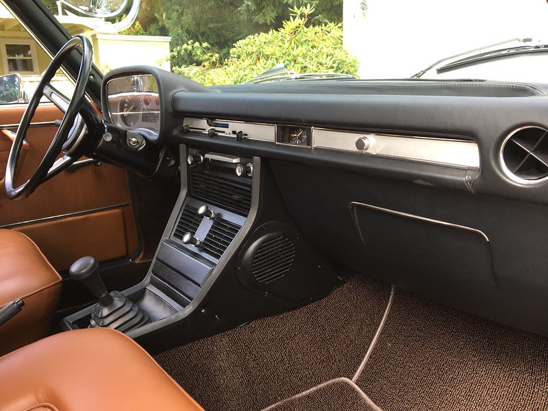

With that Kenwood unit you will need 10g wire which is big with a large fuse near the battery. I did this with my amp under rear parcel shelf but it was before bluetooth. I am considering the outofsightaudio solution for my e12 but the four original Blaupunkt speakers are tiny and I don’t want to tap into the fader to wire those up. I will probably get speakers that sit under the front seats but that isn’t optimal either. The NK has an amp under the rear seat, much better location.
I have only 2 speakers and think 4 would improve the sound. In the kick panels.
I am inclined to the Mark 4 since I could use it for hands free telephone

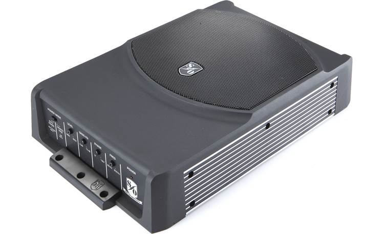

Another option is to keep your two speakers and add a amplified sub that will fit under a front seat. I took this approach in my 02 and it works great. It also has a variable cross over and volume control on a wired remote. The sub is wired through the sub out on the kenwood head. You won’t be thumpin’ with the homies in stereo competitions but you will fill the lower end in nicely, I’ll bet better than adding two more speaks. Of course, this depends upon the two speaks that you have, where/how installed, head, power amp, etc. or you could do both!
My 02 is at Mario’s and you are welcome to fiddle with/try the sub once the car is back together.
Search kenwood ksc-sw11 on Amazon.
I did just this today! I have 4 Retrosound speakers in the original Becker speaker enclosures driven off the Becker radio amp with a bluetooth 7 pin DIN input adapter, and a power amp under the rear seat. But this sounded crappy because the speakers started to distort when cranked up (I believe it's the separate Becker amp that is getting over driven) so I put a powered subwoofer under the front seat to handle the low frequencies. Then I run all 4 speakers from the amp channel that has the High Pass filter which is enabled, this allows the 4 speakers to just handle mids and highs. Much improved sound, and I can now feel the bass in my butt! This is what I installed:

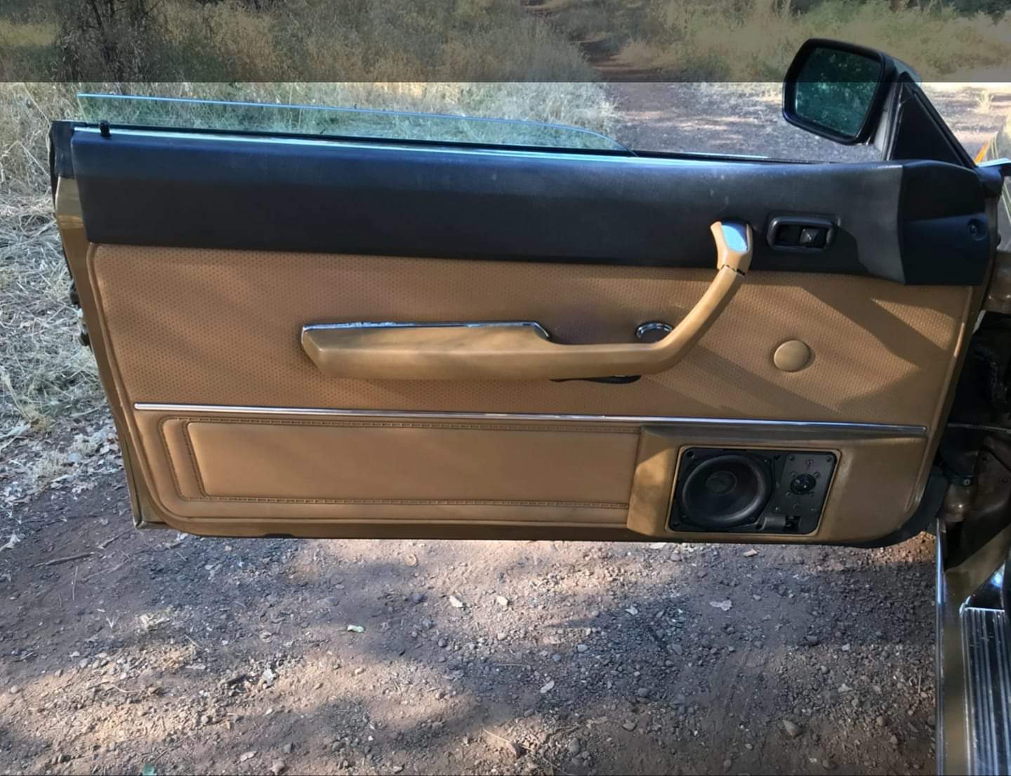

While on the subject of speakers, I spotted this on the e24 facebook page. Keep in mind that e12-based e24’s have the same door pockets as e9’s (and armrests).
A decent option for door speakers without giant holes.

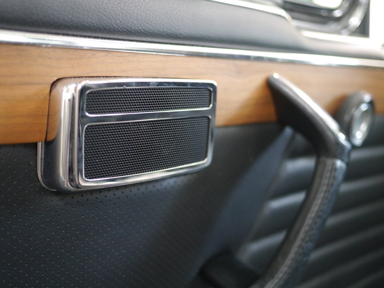

Here is my tweeter install, in the ashtrays. I used old speaker grids instead of the original leather/steel plate cover. The size of the ashtray limits the the tweeter size of course but it works. When that said, it is (as mentioned above) very difficult to get a good sound inn our e9´s, even with an advanced and pricey setup.

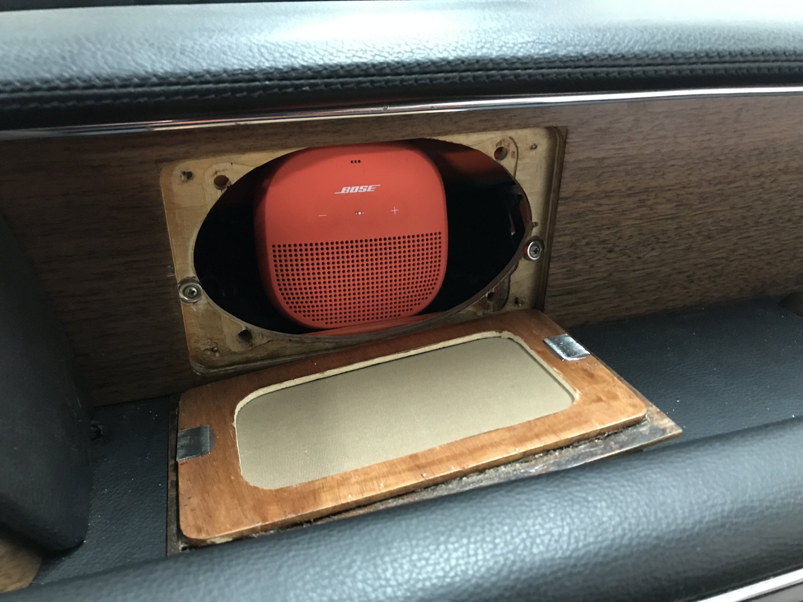

I have experimented with small Bose portable speaker, and the sound is very good, size taken into account. There are a lot of good bluetooth speaker options on the market that could fit in the dashboard and save you for a lot of money and work.
I have installed small magnets in the plywood for easy removal of the speaker front and the Bose unit.
