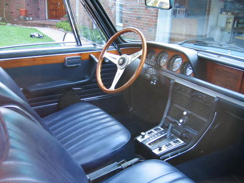

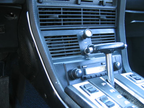

Here is what mine looks like:

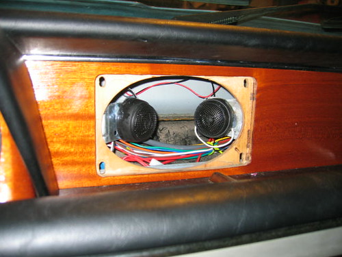

I hijacked bmwmadman's idea to mount tweeters in the forward speaker grill, although I did fabricate my own mounting system. Your mounting method would vary depending on what size and type of tweeters you run with:

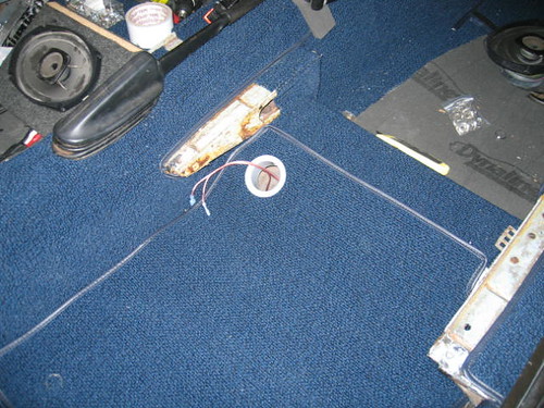

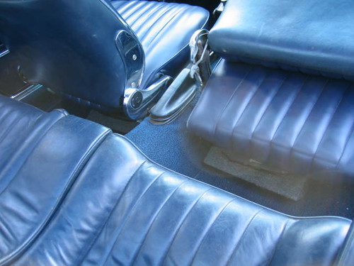

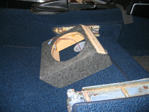

All of the afore-mentioned have been done before, but here is where I broke new ground (I think). I didn't want to cut into a perfect parcel shelf or the upright section beneath the rear seats, so I played around with different speaker box configurations and sizes beneath the front seats and used the sheet metal box beneath the front seat as a "sound chamber" allowing more base to be created. You'll have to insulated the interior of this sheet metal with Dyna-Mat or equivelant. My audio expert buddy sounded very skeptical of this plan and encouraged me to locate the 6x9s in the rear parcel shelf wheer they would have plenty of air circulating behind them. I'm pretty stubborn, so I again disregarded his advise.
I had no plans of adding additional amps, wiring and sub-woofers, so proper and adequate base was crucial. The 6x9s that I placed beneath the seat move plenty of air and actually point directly up at the seat. At higher levels, you can actually feel a little of the base in the back of your spine! never thought that would happen.

acat2002 - had you considered mounting the under-seat speakers directly into the sloped face of the metal seat support/stiffener? There looks like there would be enough depth. I am considering this option as I plan to put the battery under the rear right seat, thereby not leaving room on that side for a speaker in the vertical wall. Maybe a small woofer under the left rear seat?
Yes, that would work well too depending upon the depth of your speakers and size of the magnets. There wouldn't be the need for the speaker boxes and your rear passengers would have a bit more room. Definately apply the Dynamat to all surfaces in the "box" so there will be maximum sound reflection and minimal vibration.
However, I did not want to do any more cutting than necessary in case the idea did not work well. The only hole I cut was a 2" hole for air to move through the metal. Alternatively, I suppose you could cut a larger hole to receive the rear depth or magnet part of the speaker. May even result in a cleaner look.
I also did not dare cut a hole in my new carpet set. I simply cut an "X" with a utility knife and folded the excess carpet down under the metal with the aid of a 2" electrical conduit spacer (the grey trim piece in the photos). That way, the whole thing could be undone without any fuss.

That's a beautiful radio, the C indicates 1970 vintage so it isn't stereo, not that it matters. The chrome nose models look even better and I think the most popular dealer installed radio would have been the Blaupunkt.
