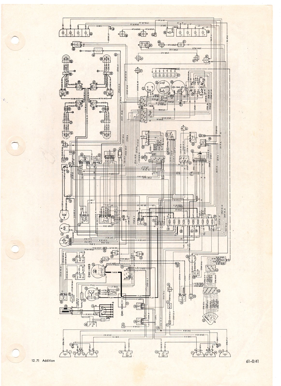

I have attached a copy of the wiring diagram from the workshop manual which is dated 12.71. This shows the relay bottom left item 117 and other information I have indicates that this was probably an optional extra.
The relay is an NC (normally closed) type, probably the only one of this type on the car.
I have identified a Durite 0-727-02 which appears to have the same circuit but would like to be certain it is a direct replacement before fitting

I looked at my wiring diagrams from the blue books, the choke relay is not related to the fan in front of your radiator which I have never seen on a non A/C coupe. The choke relay is triggered by a temp sender under the intake manifold. The relay was not an option, it is on all coupes with Zenith carbs and receives switched power until the temp sender opens the ground.
On an A/C coupe the fan relay is under the coil on the inner fender and sends power to the fan from a large 12g wire directly from the battery in front of the radiator.
