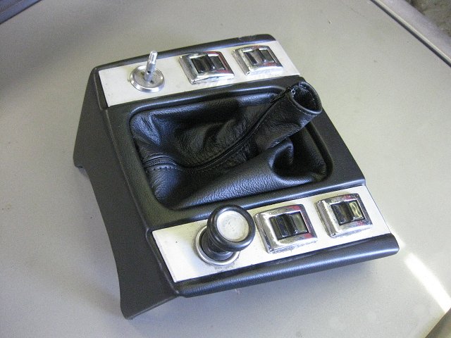

2) interior boot for manual shifter - $295 from Coupe King
(http://www.coupeking.com/product_id-503.html)
The Coupeking part for $295 is a lot more than just the boot - see photo below.
You might try calling LaJolla Independent, and see what they would charge for used pedals and the boot/console parts - they part out coupes with some regularity, so they must get these. Of course, they also perform automatic to manual conversions in-house, so they may use all of these parts themselves.

Will be buying one of these console things early next week from Coupeking. Would you expect the quality to be first rate as I have never dealt with this company but the guy I emailed seemed very helpful.

Coupeking shift console or a parted out one? Your opinion please
Fellow Auto to 5speed converters, do you think the Coupeking part is worth the extra money at $295 vs. a parted out console and boot at around $200?
Advice welcome.
thank you
Matt
confirm that is new
i would confirm with peter/erik that the boot and center piece you would be getting are new - my pal just had them do the auto-to-5sp conversion, and they put in a used piece, that has a few small scratches/holes. i was surprised by this.
