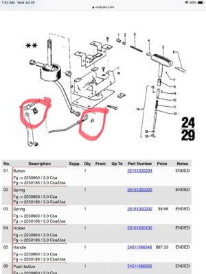

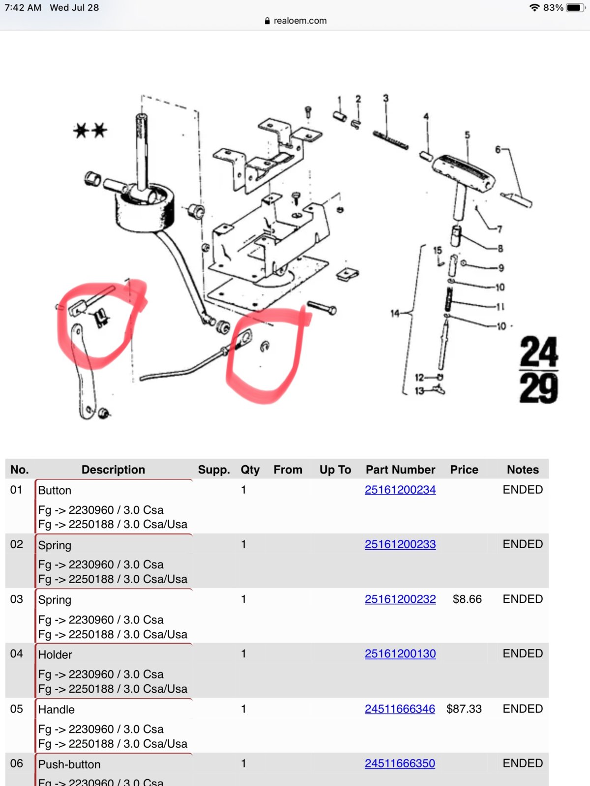

Thanks for the input. Is there a clip under the cover of the housing that will release shifter to move freely
We are not mechanics - diagram is more involved what we can do. We can get the cover off - trying to find on net if there is a release pin.
Otherwise we will need a local BMW fixer in and around Somerville Cambridge Ma
The clips are under the car….

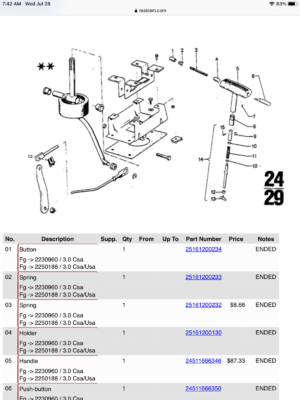

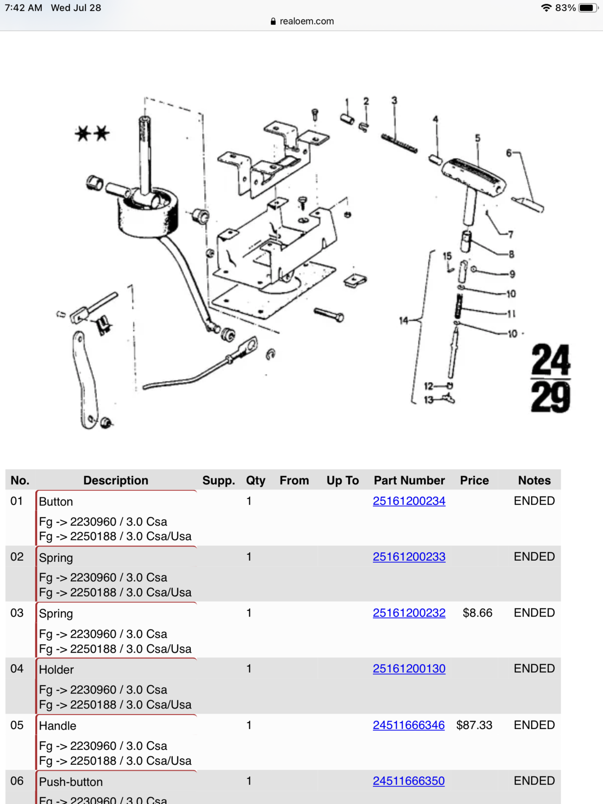

The lockout is controlled by the button #1
the handle comes off with #7 under the handle

Follow Don’s advice, remove small screw (might be an Allan screw) from under shifter and then remove the button. This happened to me when I borrowed Carl Nelson’s 645i.
Also, if you've removed the T handle and not installed it properly the button won't work to disengage. The T handle has to be threaded onto an internal rod as well as the main chrome rod.
