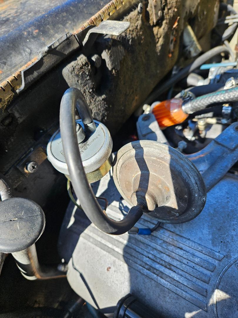

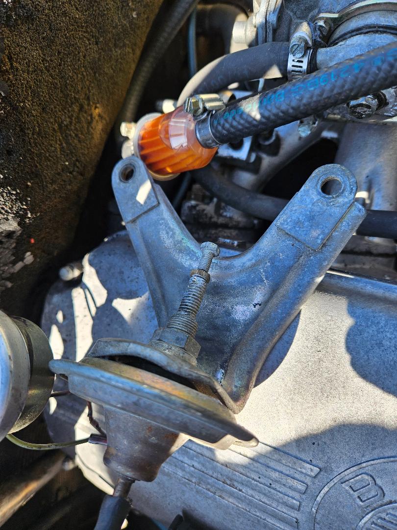

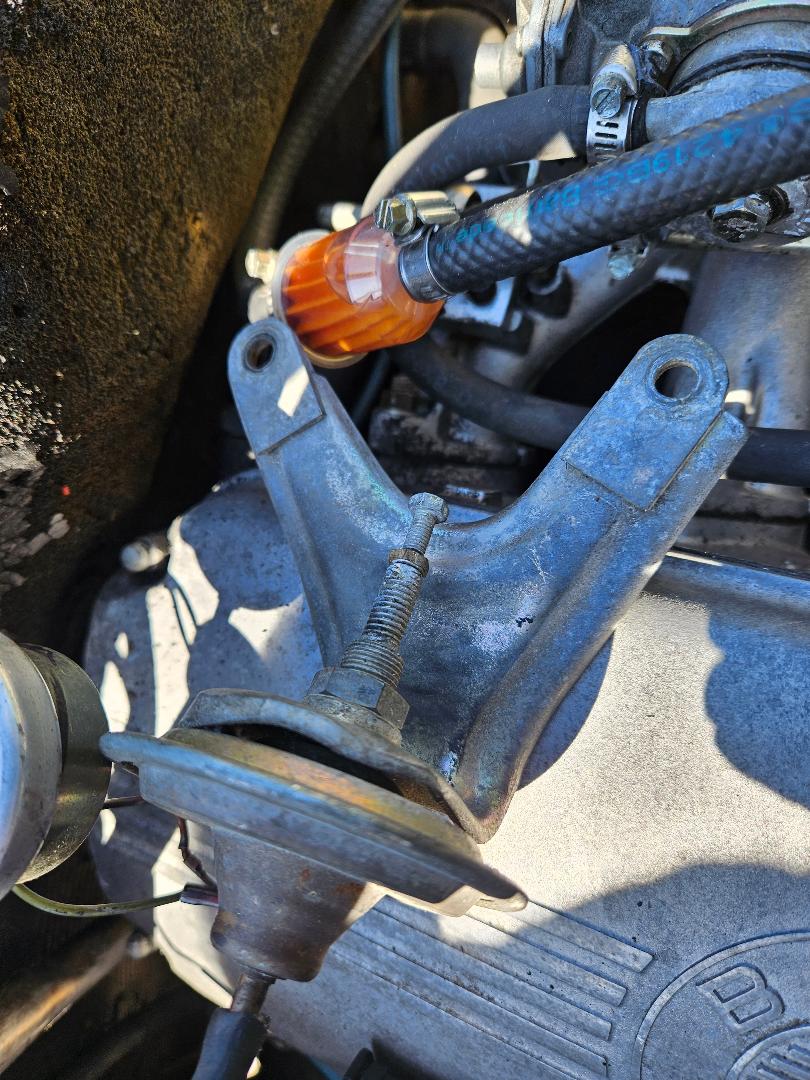

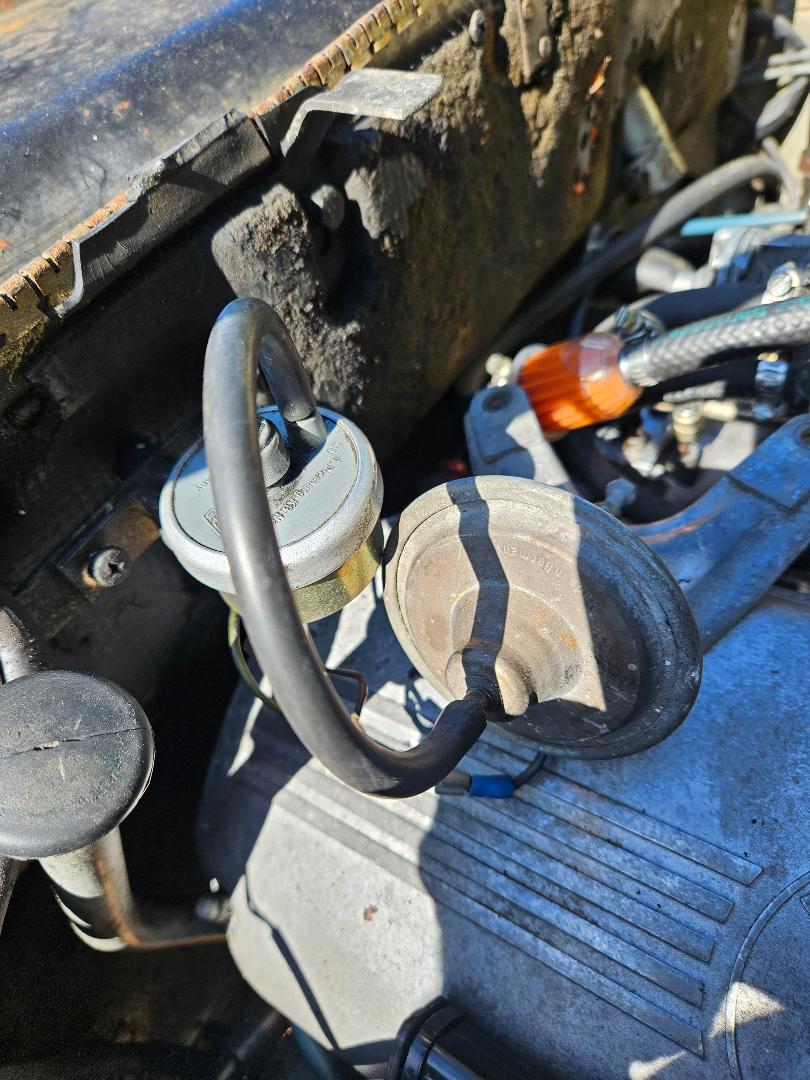

Here is the parts I mentioned. The Vacuum canister will up the idle at a stop when the transmission in at a stop with load on it. the electric regulator is link to the transmission , and is activated by what position it is in to have the vacuum increase to up the idle when on load, in gear. This was probably parts from ta Zenith set up.

That is designed to slow return of the throttle to reduce emissions, controlled by retard vacuum and round valve, found on all US coupes, it does not hold idle however.

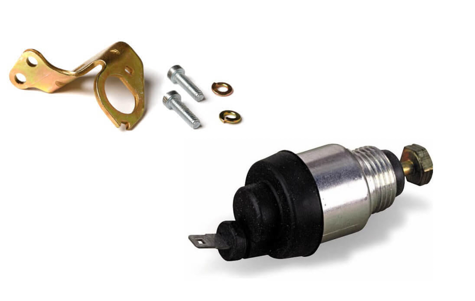

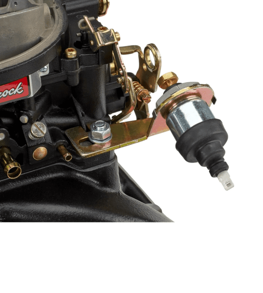

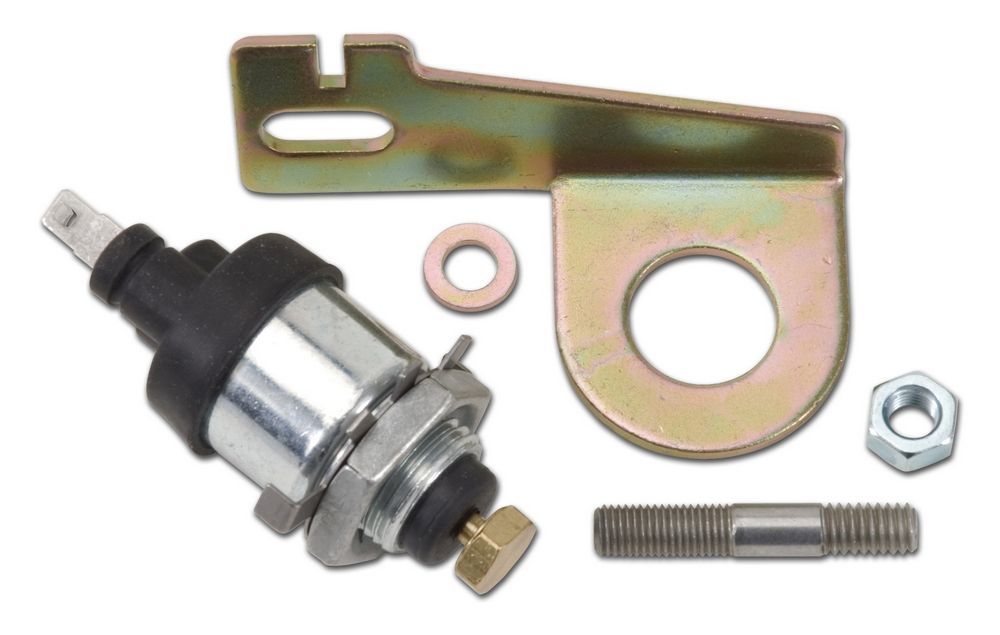

There were add-on solenoids that could be "adapted" to address this issue. I vaguely remember one on a ‘72 Bavaria, but that was decades ago. If I remember correctly, Holley, AC-Delco and Autolite produced step up solenoids to increase idle speed in order to handle the significant compressor loads imposed on small displacement engines in the ‘70s. I have not searched for any related part numbers, but plenty of images support my recollection. Here is but one link for a bracket and solenoid. https://www.summitracing.com/parts/qft-49-148qft I am confident there are many more.

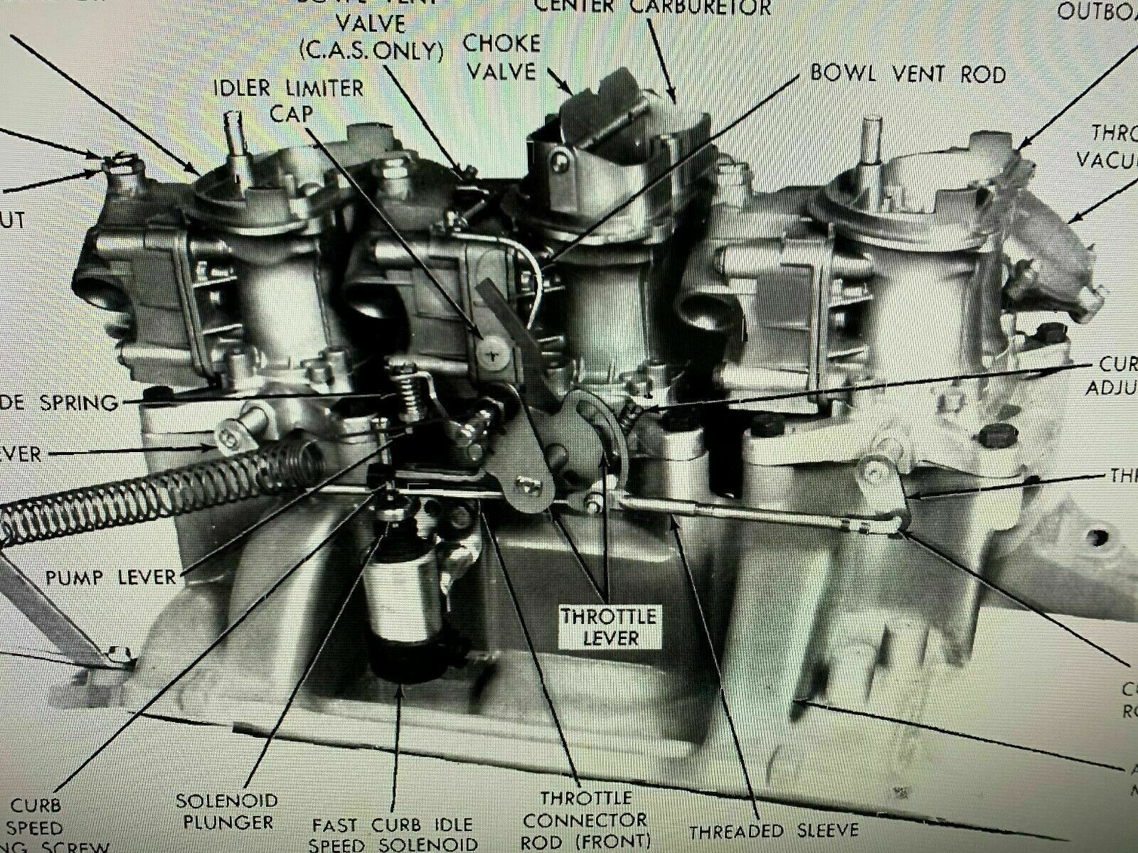

One obvious problem is the fact that your engine uses two carburetors. I can’t recall whether one solenoid can be employed to control both carburetors, but I seem to recall only one was used for three carburetors on a certain Dodge "six-pack ".

I have a solenoid on my linkage at the block to bump my idle for the a/c compressor at idle; it is not strong enough to open the carbs without assistance from the pedal, but it will hold it open once engaged.
